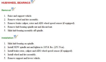

how do I get it off? I have tried to beat it off but it is not moving at all.

Thank you for your response it was helpful.
