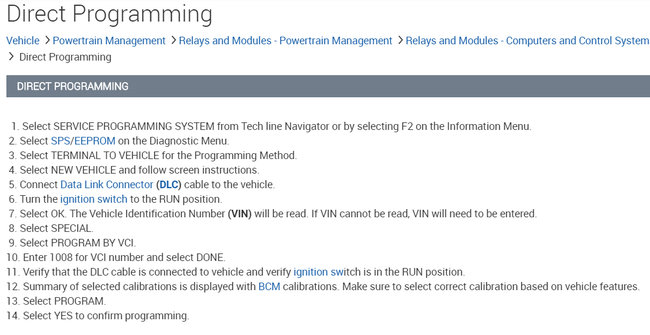

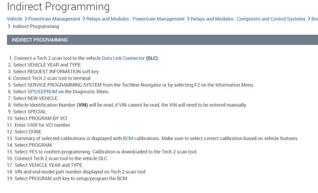

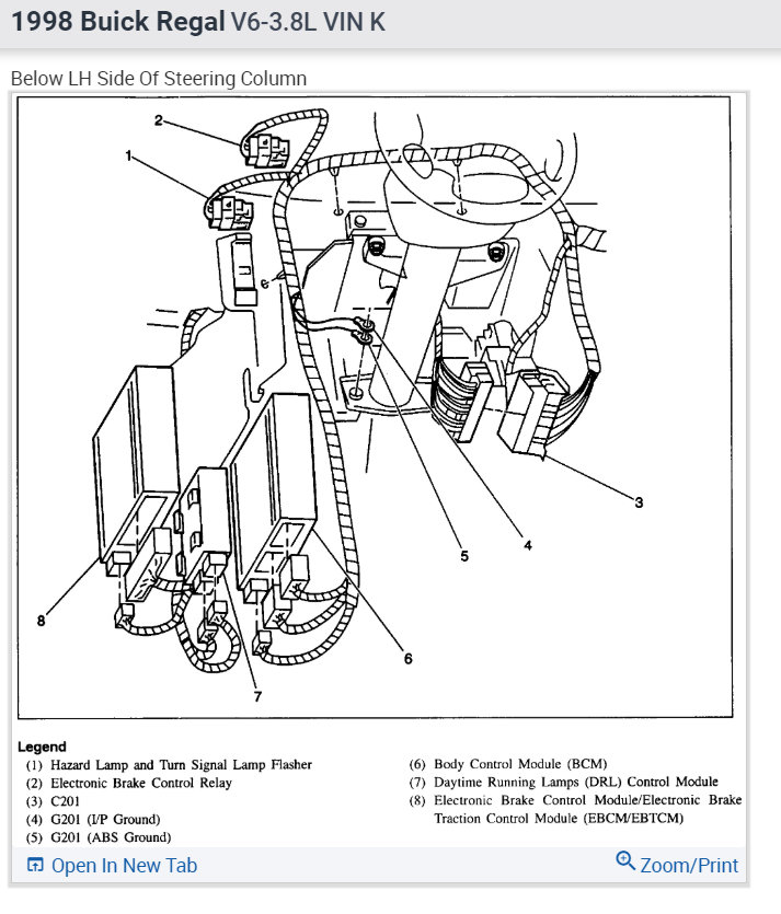

This happens when the body control module goes out.here is the location and replacement instructions in the diagrams below. Check out the diagrams (below). Please let us know if you need anything else to get the problem fixed.
