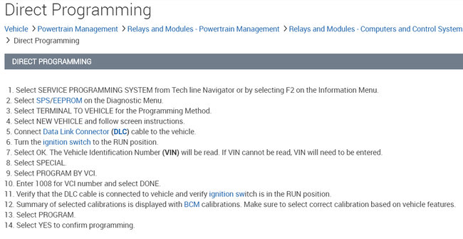

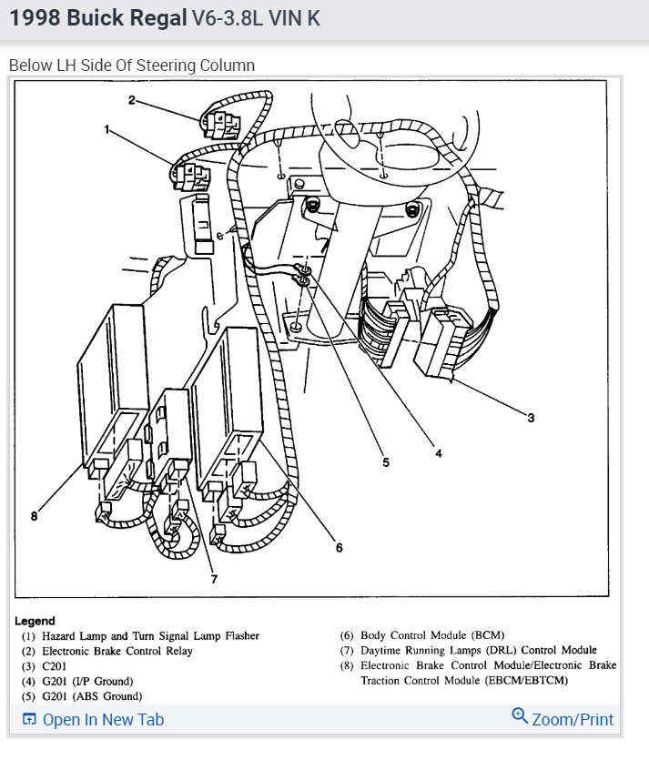

All doors lock and unlock with remote and key. Reardoors open from outside and inside. Front doors open from inside but not outside .This happened same time with both doors.
Sep 24, 2019 at 6:06 AM
  • 55,433 POSTS

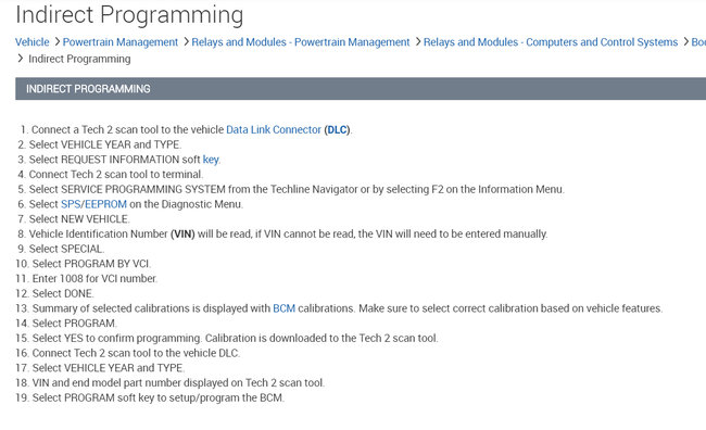

This happens when the body control module goes out.here is the location and replacement instructions in the diagrams below. Check out the diagrams (below). Please let us know if you need anything else to get the problem fixed.
