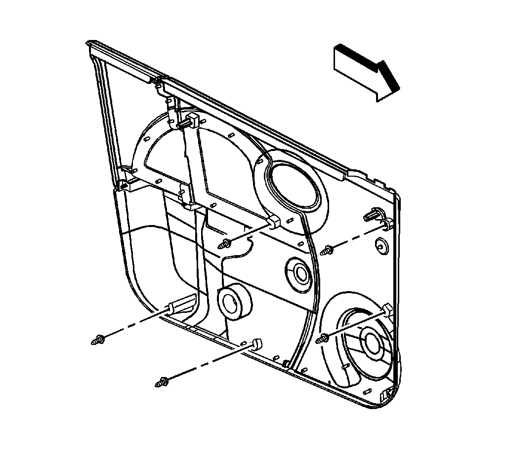

How can I check to see if the inner latch actuator rod is not working properly if I cannot open the door? Can the door panel be removed if it cannot be opened? Can this be demonstrated in video? Please attach if possible.

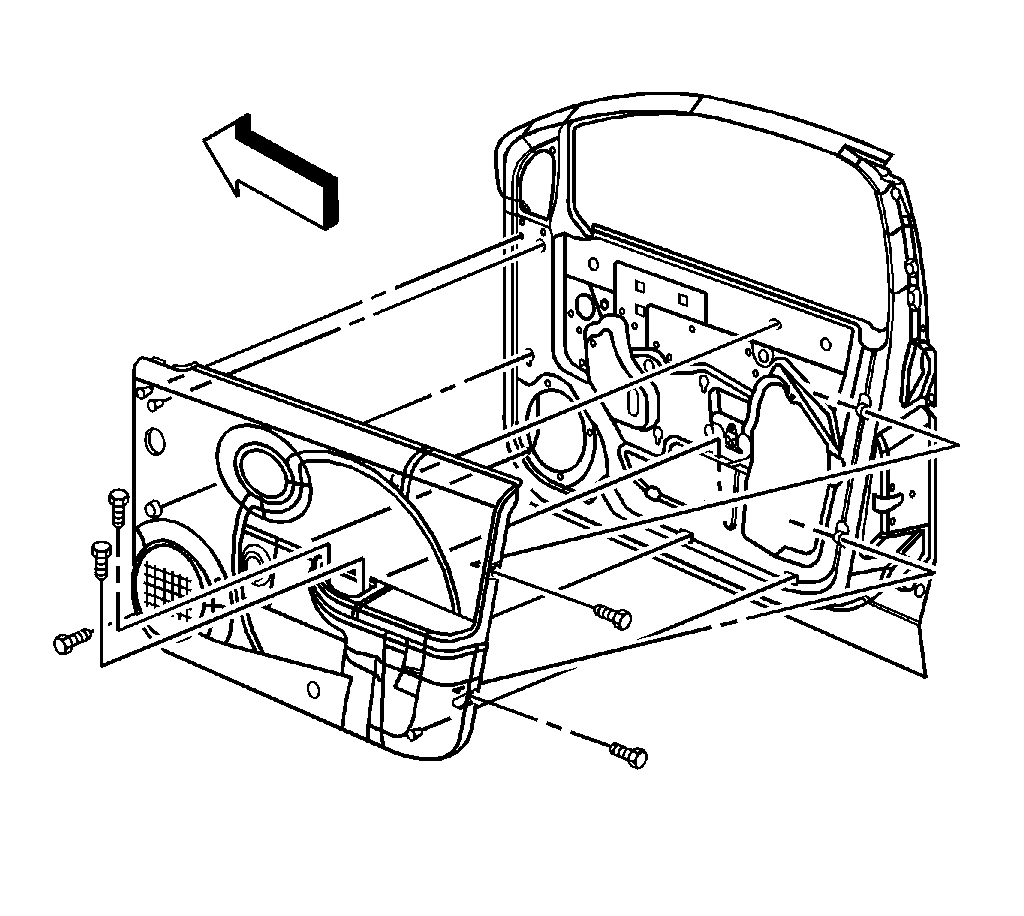

Honestly, the only thing you can do is remove it with the door closed,. The hardest part are two screws near the door frame.
I'm sorry, but I don't have a video for this vehicle, but here are the directions. It can be done, it's just a lot more difficult with the door closed. The attached pics correlate with the directions.

4. Remove the pull cup assembly. Refer to Armrest Pull Cup Replacement (See: Arm Rest > Removal and Replacement) .
pic 1
5. Remove the door trim push-in retainers.
6. Remove the screw from the trim panel.
pic 2
7. Pull the bottom of the door trim out to disengage the clips.
8. Lift up on the door trim panel to disengage the inner belt molding from the door flange.
9. Remove the door trim panel.

pic 3
1. Position the trim panel to the front door.
2. Engage the inner belt molding over the door flange and press down.
3. Align the trim panel retainers and press until the retainers are fully seated.
pic 4
