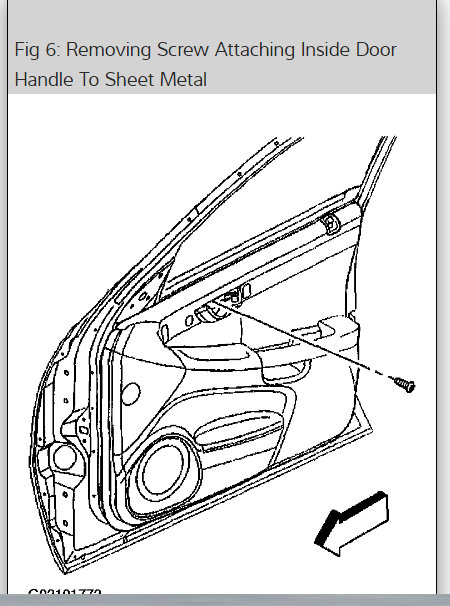

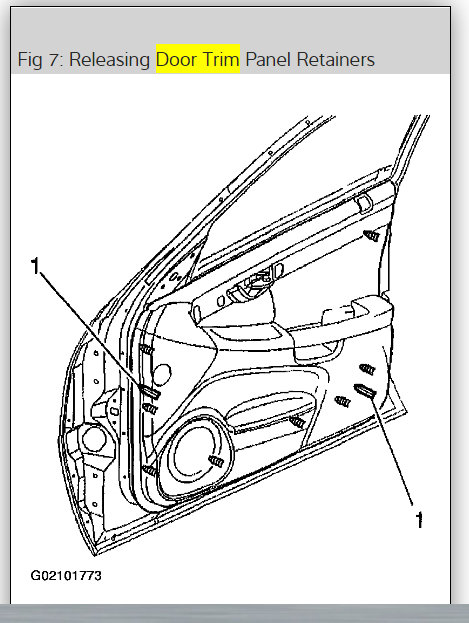

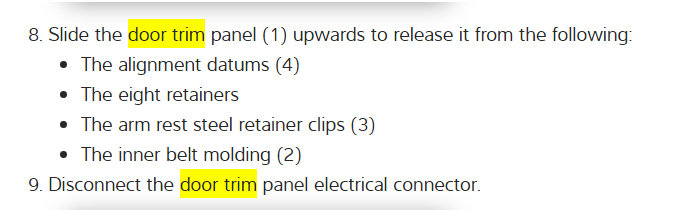

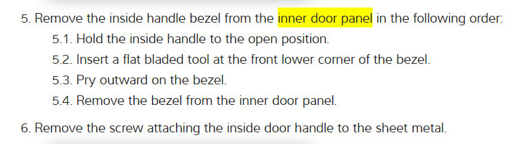

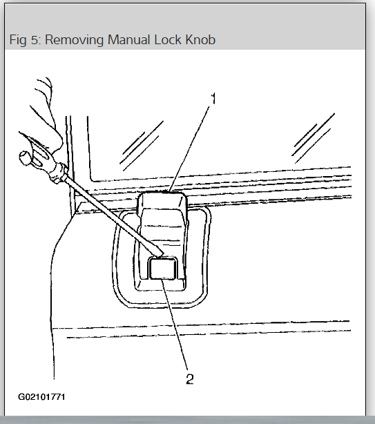

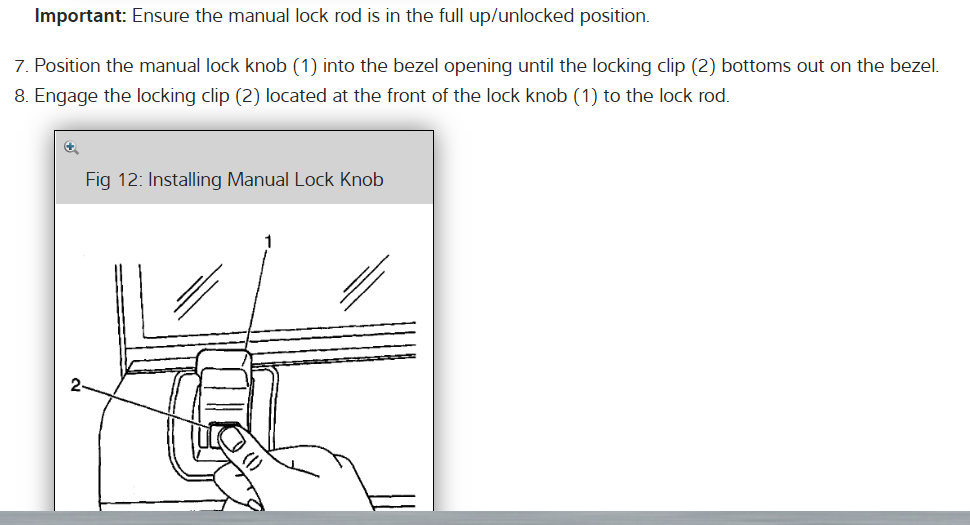

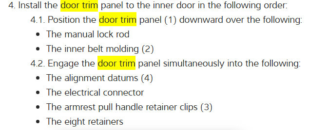

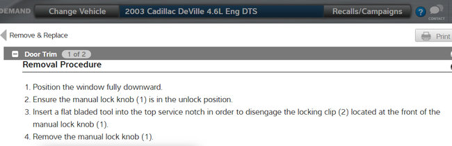

My initial lengthier question did not post successfully so. can anyone offer more specifics on how to remove the front door panel as the generalized version on this site isn't really helping. Thank you.
Mar 29, 2019 at 2:26 PM
SCGRANTURISMO
  • 4,897 POSTS

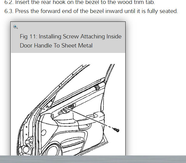

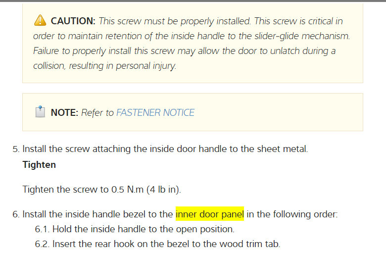

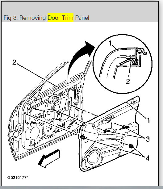

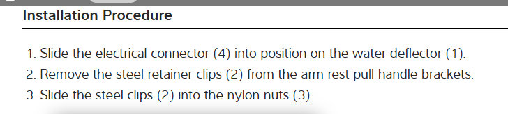

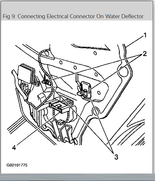

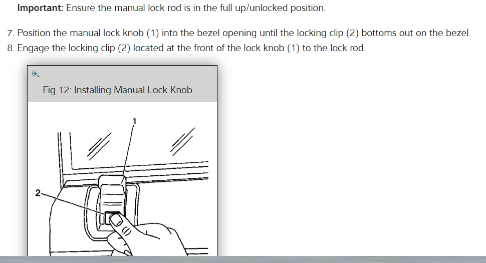

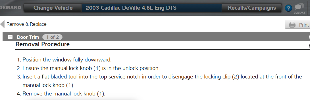

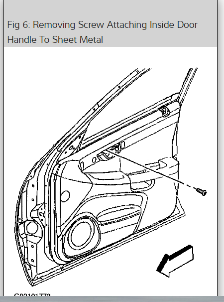

I have included the information that you have requested in the diagrams down below. I have also included the installation instructions for your vehicle's front door trim as well. Please let us know if there is anything else that we can help you with.
Thanks,
Alex
2CarPros
