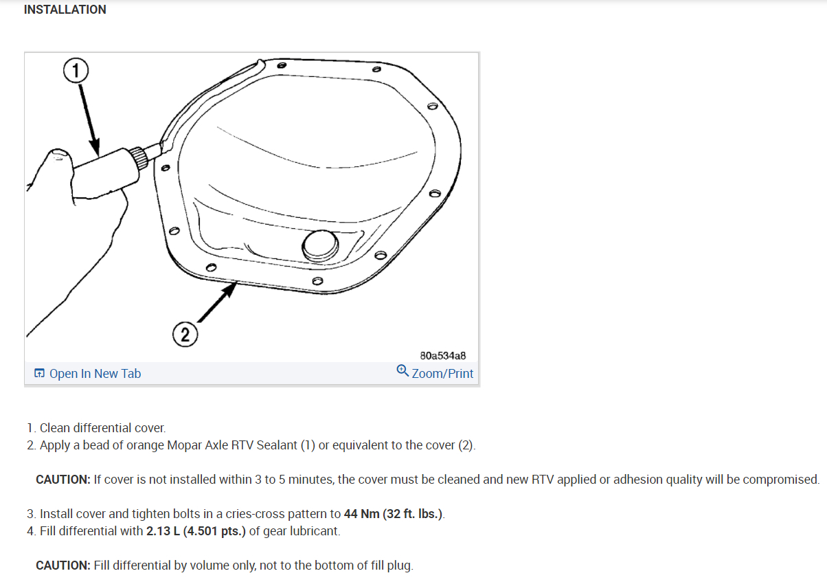

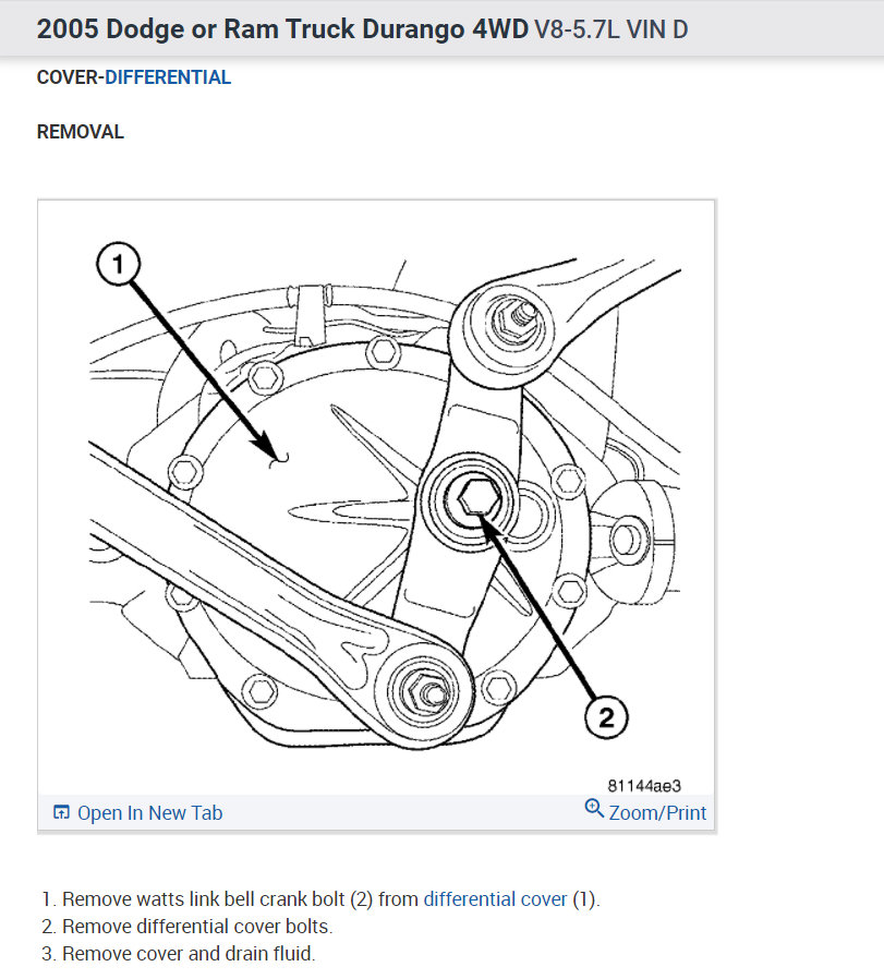

Got to change the fluid inside the differential can you help?
Jun 3, 2018 at 6:57 PM
  • 55,224 POSTS
Here is a video to help you service the differential. This video shows the job being done on a similar car but the process is the same.
https://youtu.be/6F26Kir0OCg
Here is a guide to help you step by step with instructions in the diagrams below to show you how on your car.
https://www.2carpros.com/articles/differential-service
