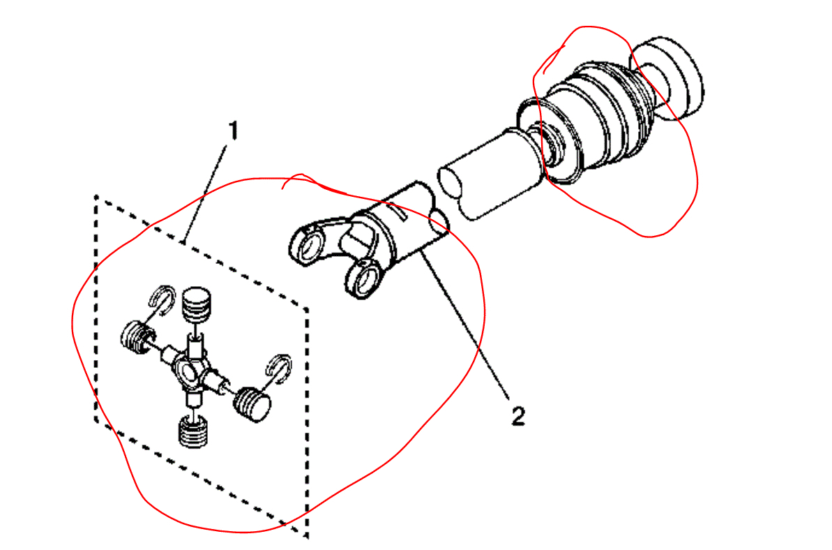

Where is the leak coming from? Also, is there anything that makes the noise worse, go away, or change? For example, does it get louder when making a sharp turn or on acceleration?
Let me know if it is full-time AWD or part-time.
Also, check the front driveshaft universal joint and slip joint for play or damage. I attached a pic below to help locate them.
Here is a link that explains how to check one:
https://www.2carpros.com/articles/how-u-joints-work
You will need to remove it to properly test it. Here is a link to help with that process. Note that the link shows it being done on the rear. The front is very similar.
https://www.2carpros.com/articles/how-to-remove-a-drive-shaft
Let me know what you find.

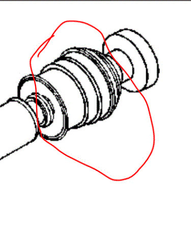

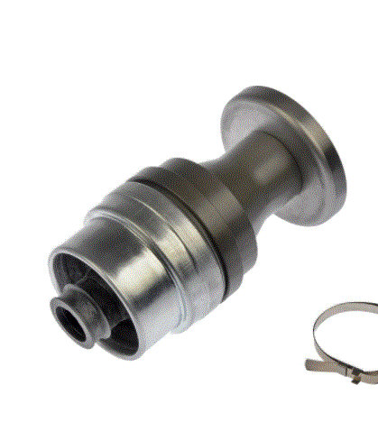

Sounds like a plan. You know, I need you to check one other thing. Where the front driveshaft connects on the transfer case is a CV joint connection. Make sure none of the rubber boots are damaged. That can be the noise as well.
I attached a pic below showing a new one. Also, the second pic shows the joint I am referring to.
Let me know. I just replaced one of these on a Grand Cherokee. It sounded like a clicking/crunching sound.
