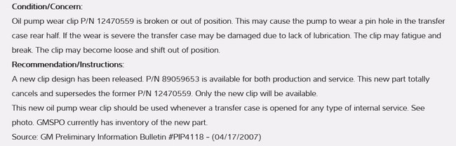

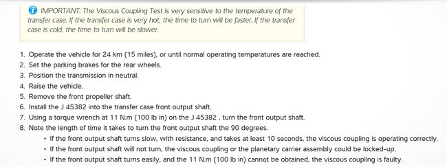

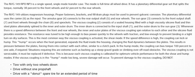

slight whining in a tcase is pretty normal. have you scanned for codes as well? has the truck ever been hit? something may be out of line causing it to burn up also it may be an internal problem with tcase. it really has to be physically looked at. also see pictures for any of these causes especially last one when putting in a used tcase rebuilt should have this done already.

did you read all the pics I sent in last reply? i'd be yours has to deal with the very last pic dealing with pump that is why it burned up.if this t case was built by a rebuilder and not out of a junk car take it back they should have a warranty on it and will fix the problem.
