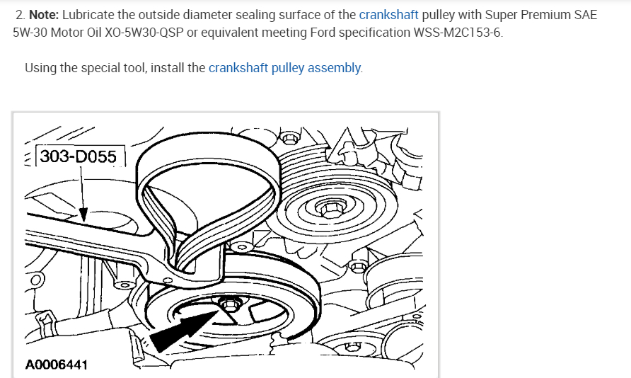

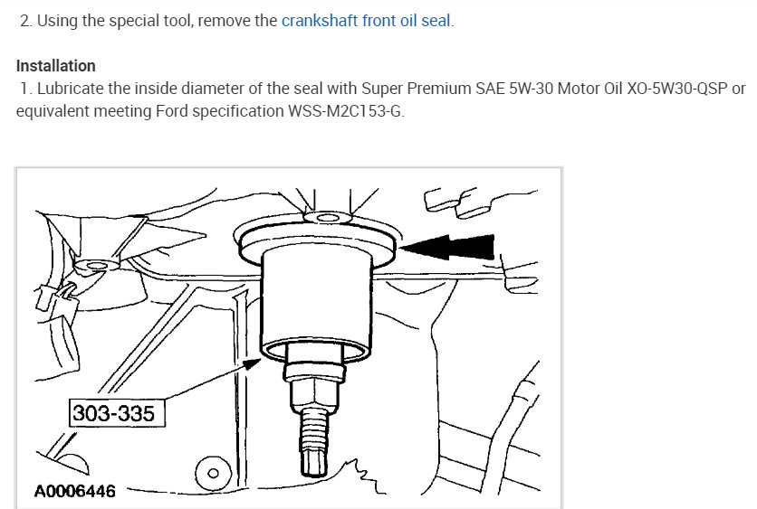

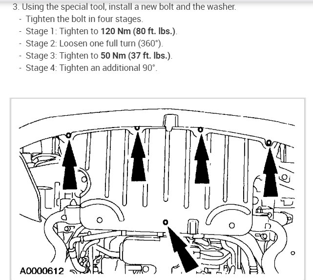

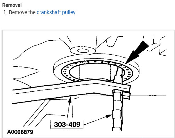

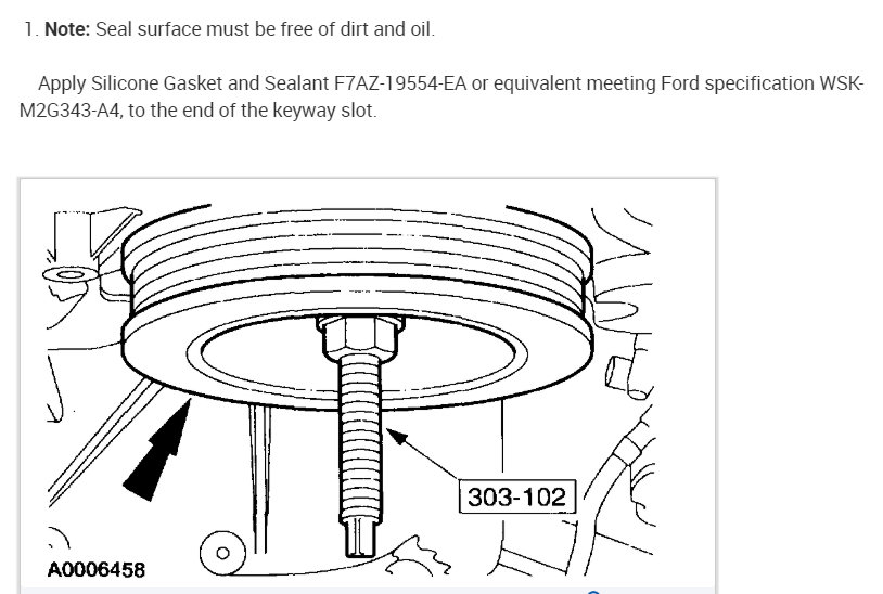

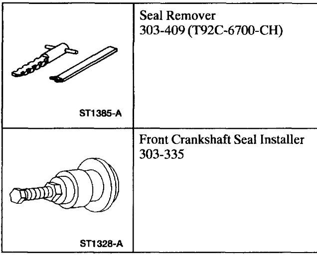

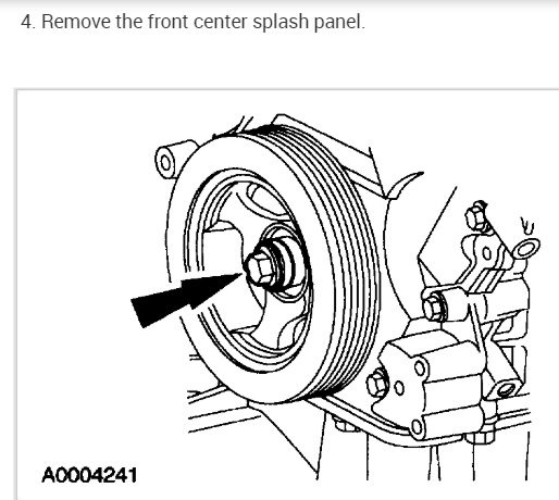

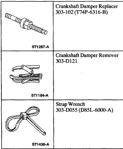

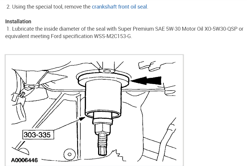

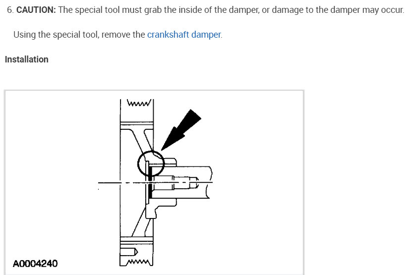

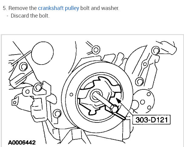

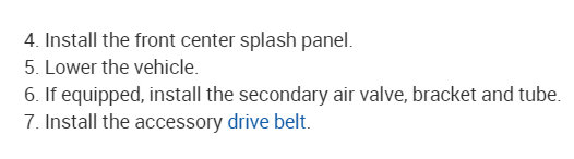

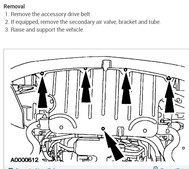

I watched the video for the Front Crank Seal on the Ford Contour. I was wondering how much different the process would be to replace the Front Crank Seal on the car listed above RWD.
Jul 28, 2020 at 8:16 AM
DANNY L
  • 5,648 POSTS
Hello, I'm Danny.

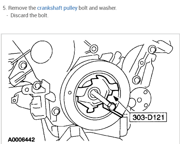

Here is a tutorial for you to view that shows crankshaft seal replacement:
https://www.2carpros.com/articles/front-main-seal-replacement
I've attached step-by-step pictures below for your car on how to replace.Hope this helps and thanks for using 2CarPros.
