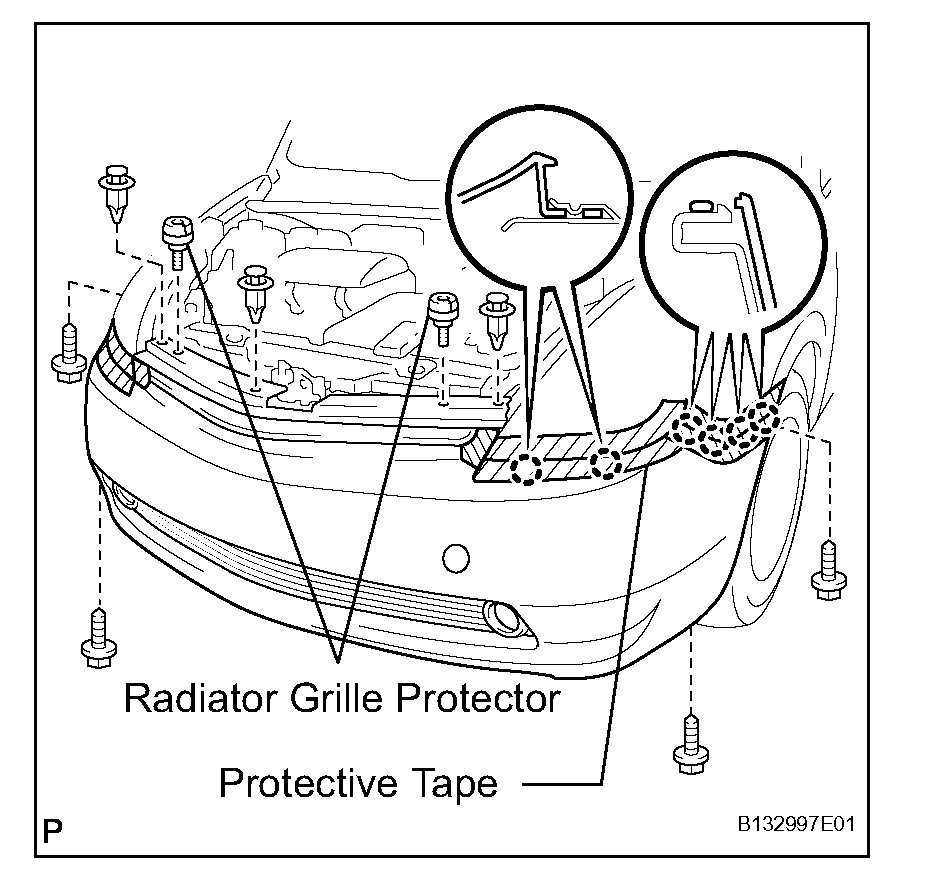

Car seems to run fine. Front bumper is very loose, and won't snap back in easily. We don't have a lot of money (we are retired). Should we buy some strong duct tape (or other strong tape you can recommend) and use it to keep the bumper from falling off?
Aug 17, 2019 at 1:21 PM
  • 110,244 POSTS
Welcome to 2CarPros.
If you are referring to the bumper cover, it is held on with a few plastic retaining clips and a few screws. They are inexpensive and you can get them at most any parts store. I can't recommend tape. I have seen people use plastic zip ties which are strong if there is one area, but not the entire bumper cover.
Can you tell me exactly where it is loose?
Also, here are the directions for removal and replacement of the cover. I'm including these directions so you can see everywhere it is attached and what type of retainer is used. The attached pictures correlate with the directions.

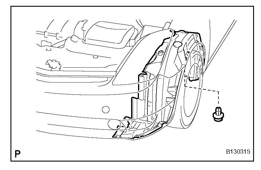

2. REMOVE FRONT FENDER LINER LH
pic 1
a. Using a clip remover, remove the clip.
b. Partially remove the fender liner.
HINT: It is not necessary to fully remove the fender liner. Partially remove it so that the bumper cover can be removed in a later step.

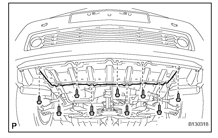

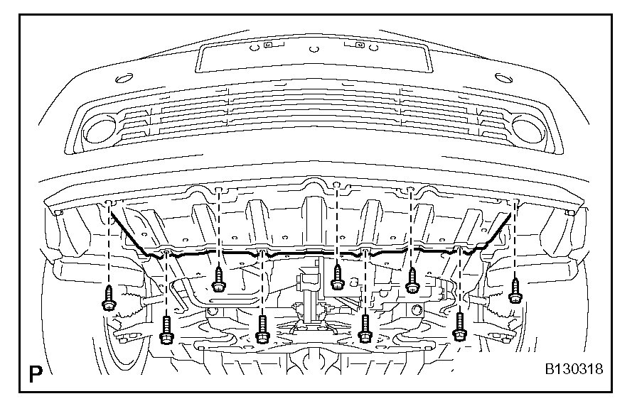

4. REMOVE CENTER NO. 4 ENGINE UNDER COVER
pic 2
a. Remove the 5 screws, 4 bolts and under cover.

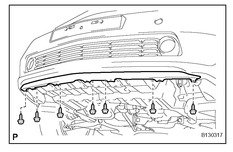

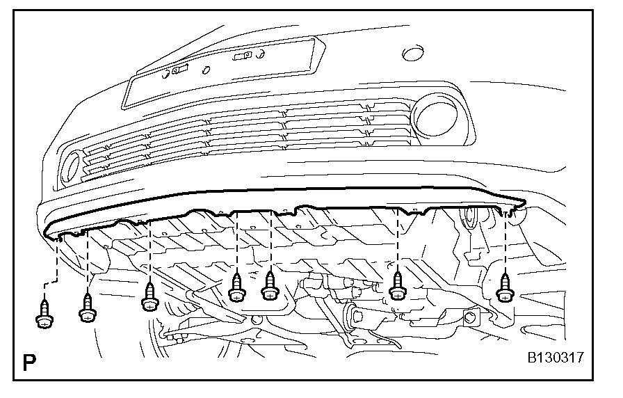

5. REMOVE FRONT SPOILER COVER
pic 3
a. Remove the 7 screws and spoiler cover.

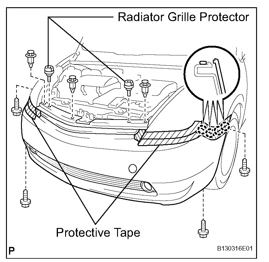

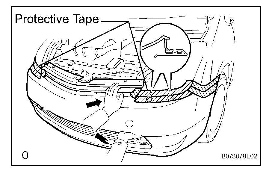

6. REMOVE FRONT BUMPER COVER
pic 4
a. Put protective tape under the front fender.
b. Using a clip remover, remove the 3 clips.
c. Remove the 2 radiator grille protectors and 4 screws.
d. Detach the 8 claws.
pic 5
e. Detach the 4 claws and remove the bumper cover.

5. INSTALL FRONT BUMPER COVER
pic 6
b. w/ Fog light:
Connect the 2 fog light connectors.
c. Attach the 12 claws to install the bumper cover.
d. Install the 4 screws and 3 clips.
e. Install the 2 radiator grille protectors.
Torque: 5.0 N.m (51 kgf.cm, 44 in.lbf)
6. INSTALL FRONT SPOILER COVER
pic 7
a. Install the spoiler cover with the 7 screws.
7. INSTALL CENTER NO. 4 ENGINE UNDER COVER
pic 8
a. Install the under cover with the 5 screws and 4 bolts.

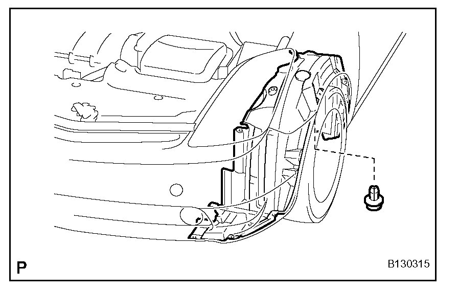

8. INSTALL FRONT FENDER LINER LH
pic 9
a. Install the fender liner with the clip.
