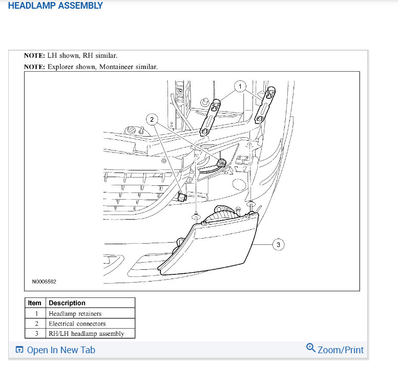

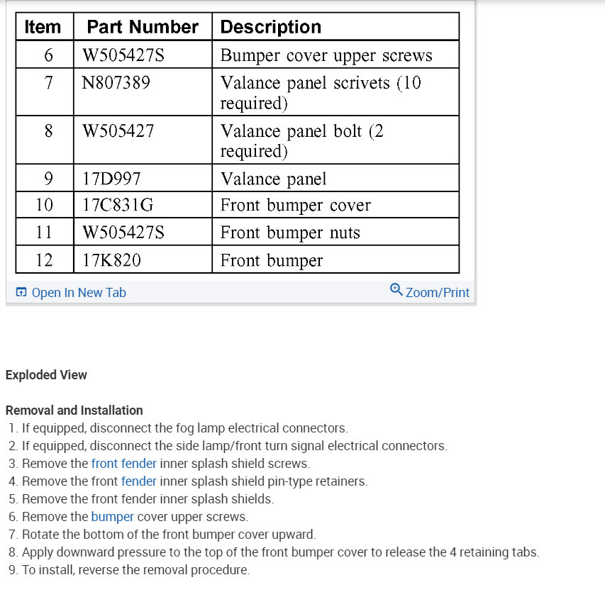

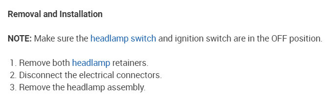

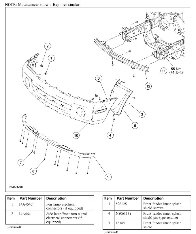

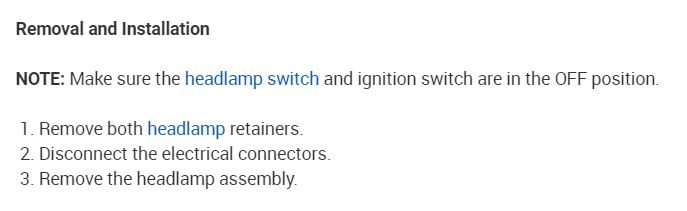

Good day, I was wondering how you would remove the front bumper off of the vehicle listed above. The headlight cover recently got smashed and I think I need to remove the front bumper to replace it. Cheers.
Aug 2, 2023 at 6:21 PM
  • 55,423 POSTS
Sure, here are the instructions on how to remove the front bumper fascia and headlamp housing. Check out the images (below). Please let us know if you need anything else to get the problem fixed.
