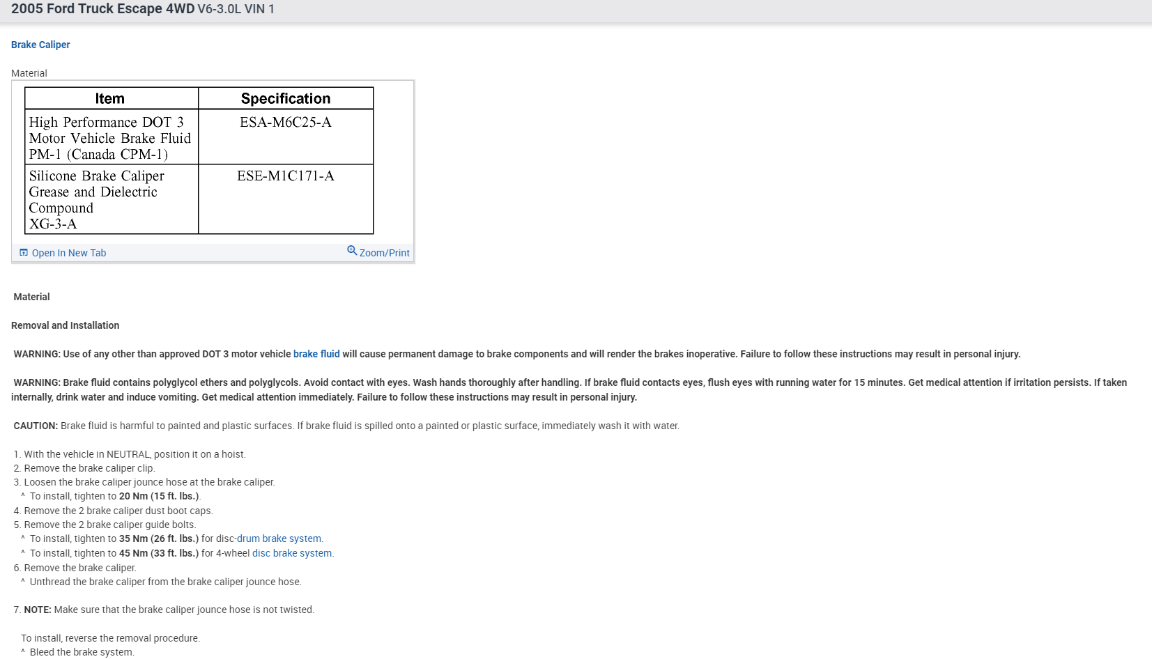

I need to know what size hex tool I need to remove the caliper there are two bolts and they are hex what size hex socket bit or allen do I need? it is a ford escape xlt 2005

9MM extra-long. here is a video that shows the job being done:

Here is a helpful guide on caliper replacement:
https://www.2carpros.com/articles/brake-caliper-replacement
I have attached the caliper replacement procedure below for anyone who might be looking for the steps.
Let us know of any questions.
