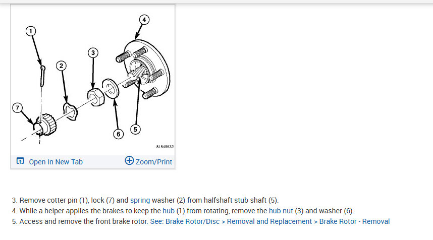

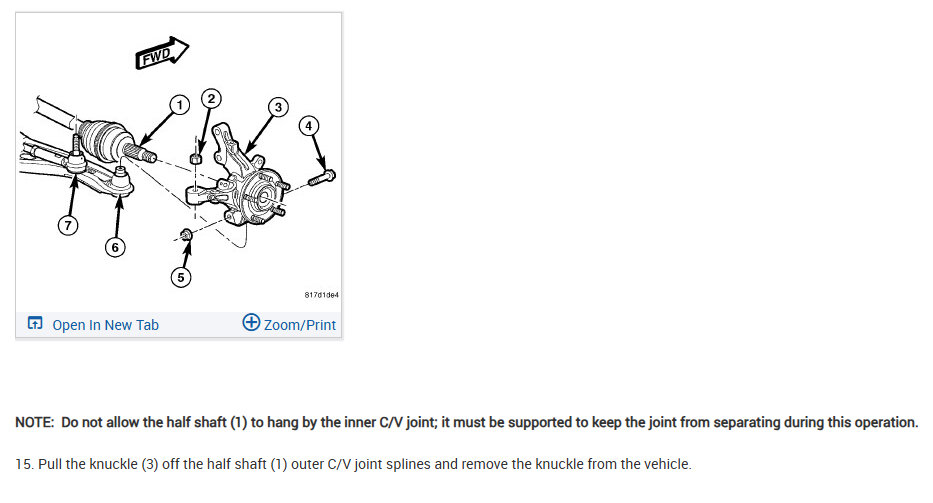

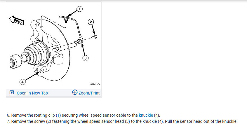

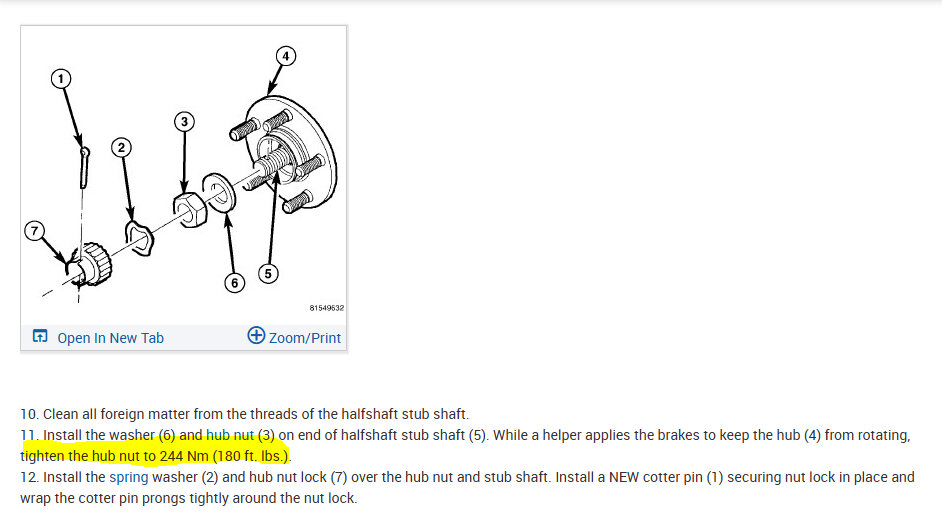

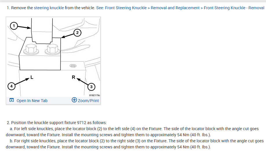

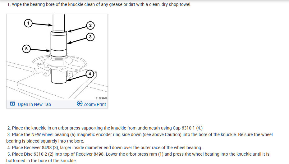

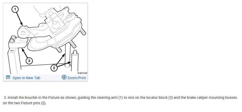

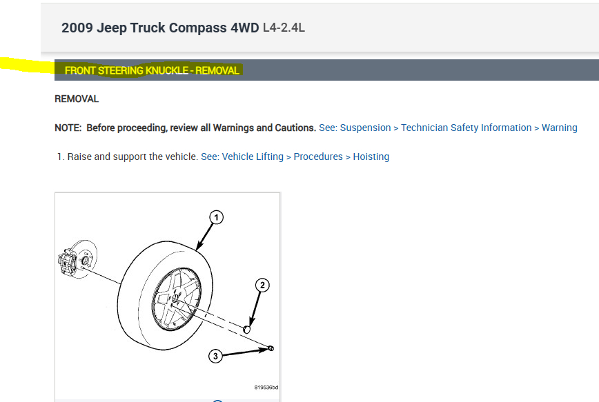

Can I get a step by step or diagram on how to Replace Front Brakes, Rotors and Wheel Bearing Hub assembly?
2009 JEEP COMPASS
178,400 MILES
JOSHTHEMECHANIC
  • 9 POSTS

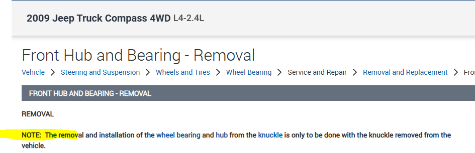

Hello, I would like a step by step or diagram on how to Replace Front Brakes, Rotors and Wheel Bearing Hub assembly on the vehicle listed above. Thank you
Jun 20, 2025 at 1:26 PM
  • 110,236 POSTS

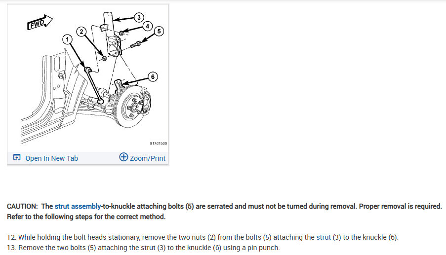

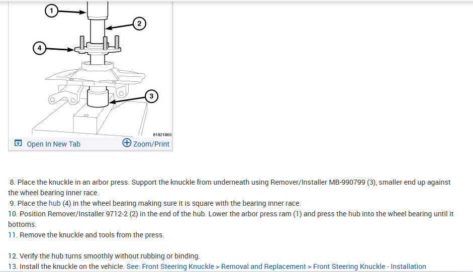

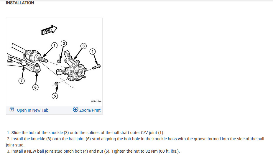

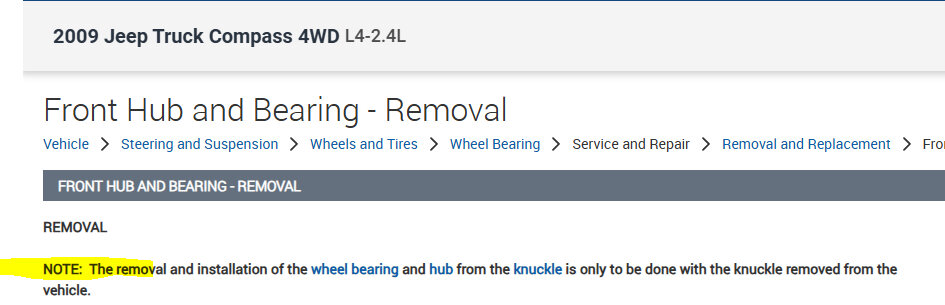

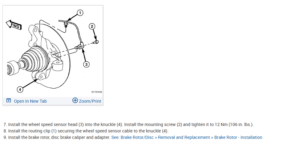

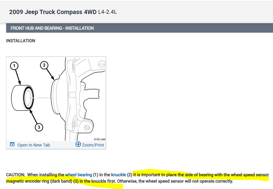

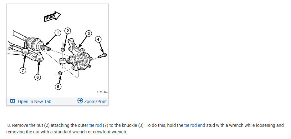

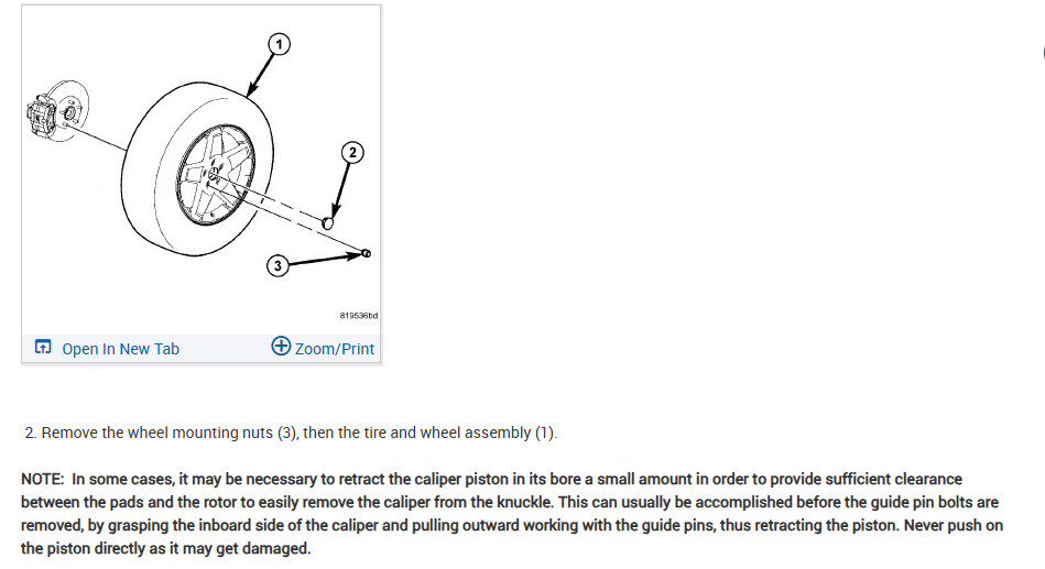

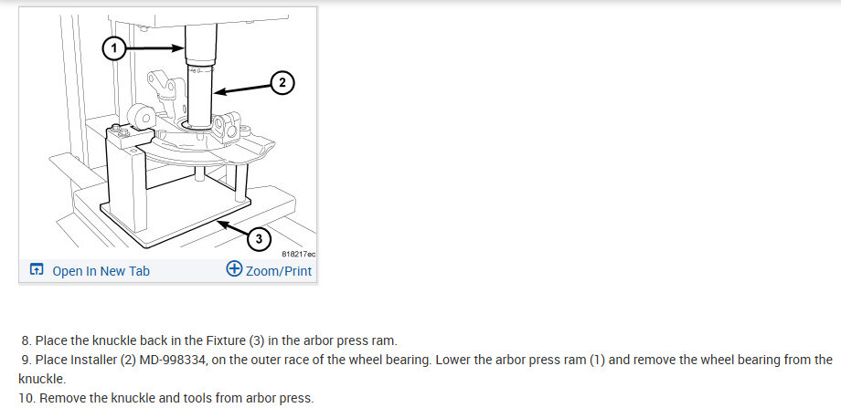

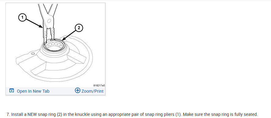

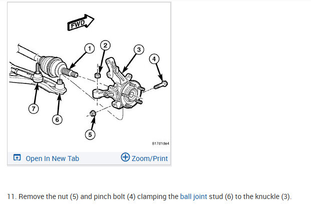

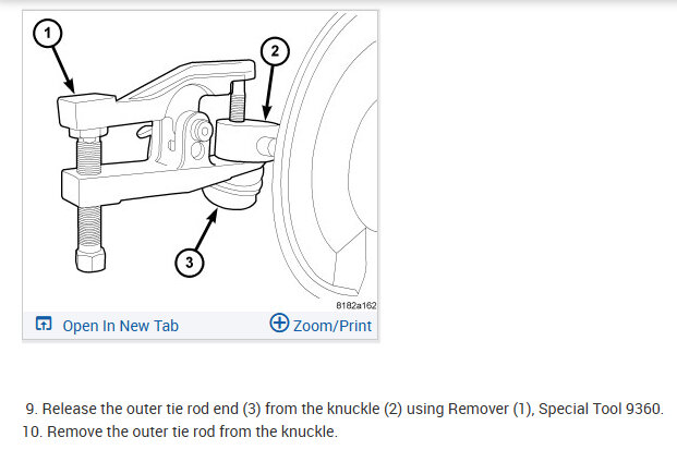

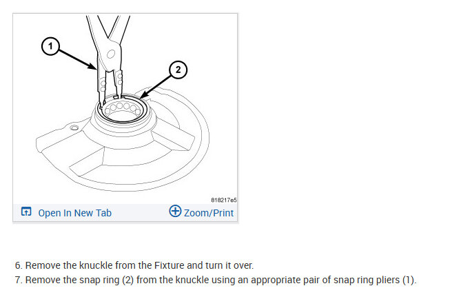

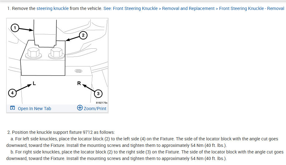

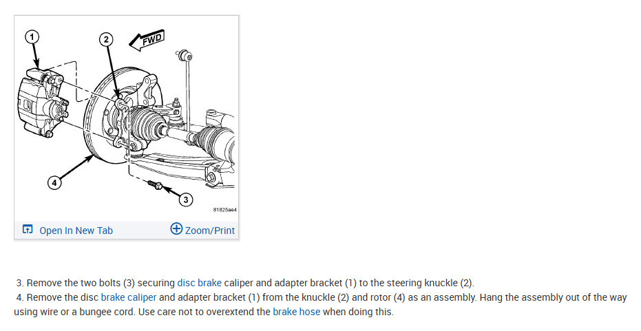

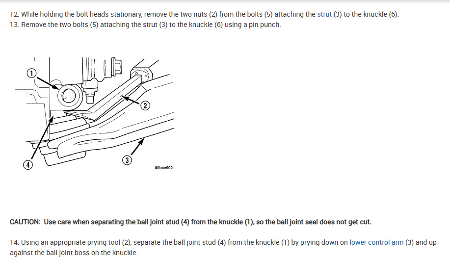

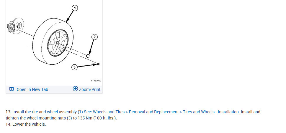

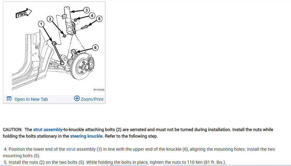

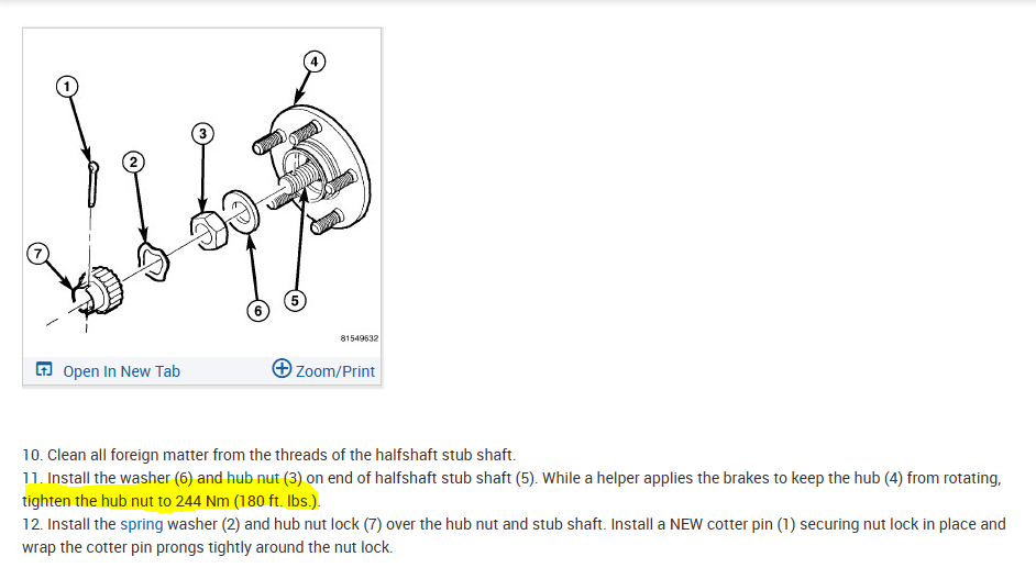

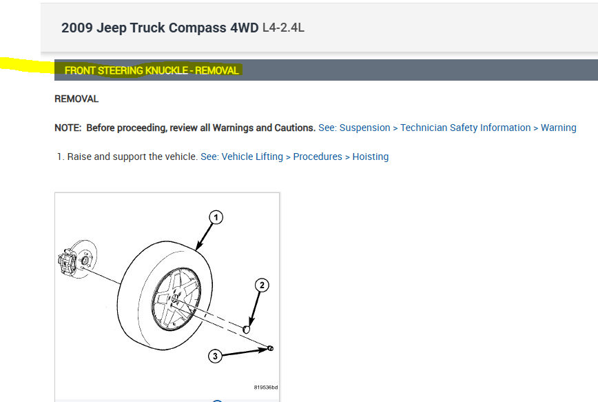

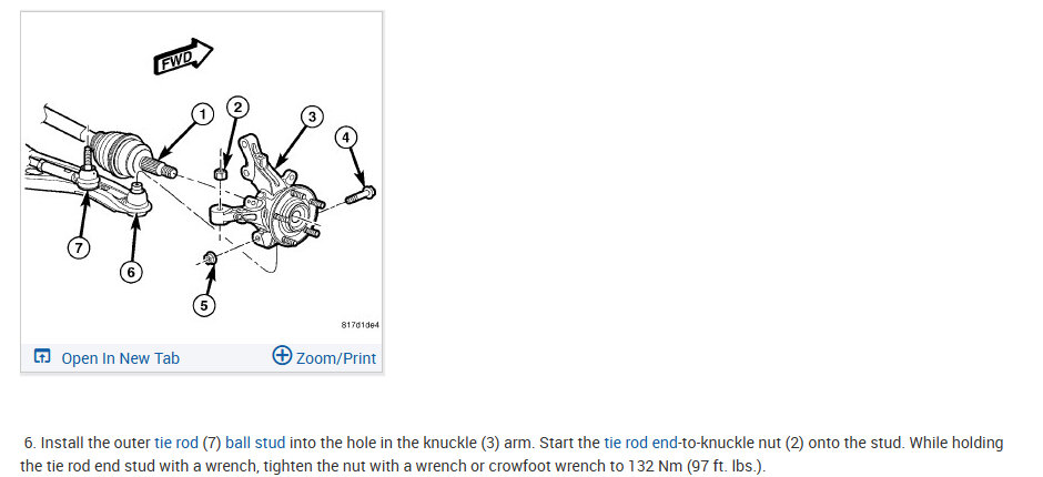

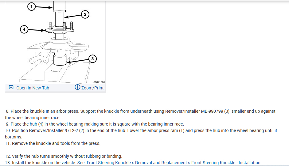

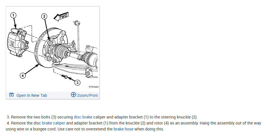

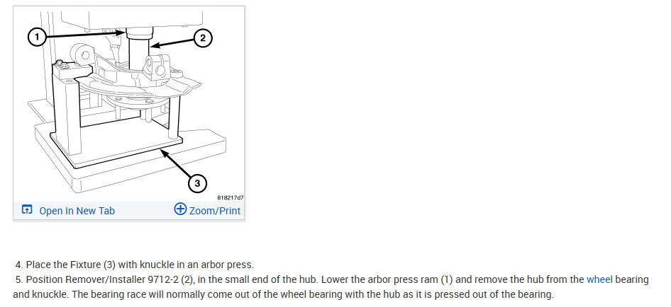

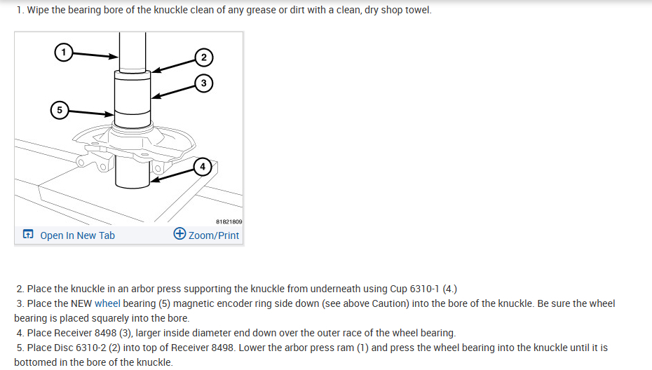

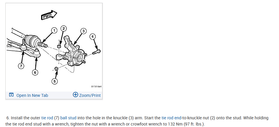

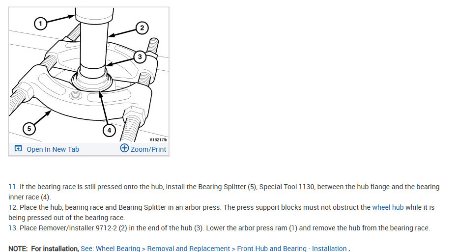

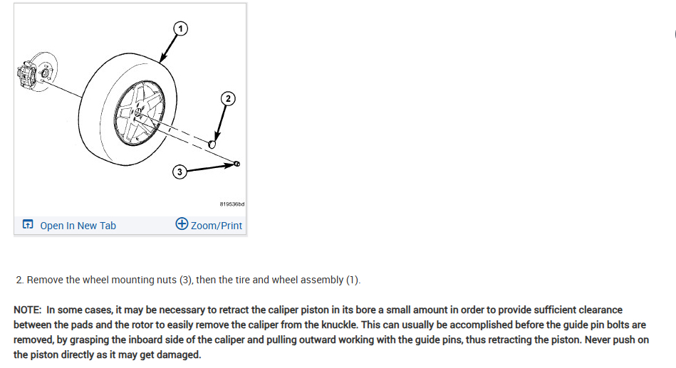

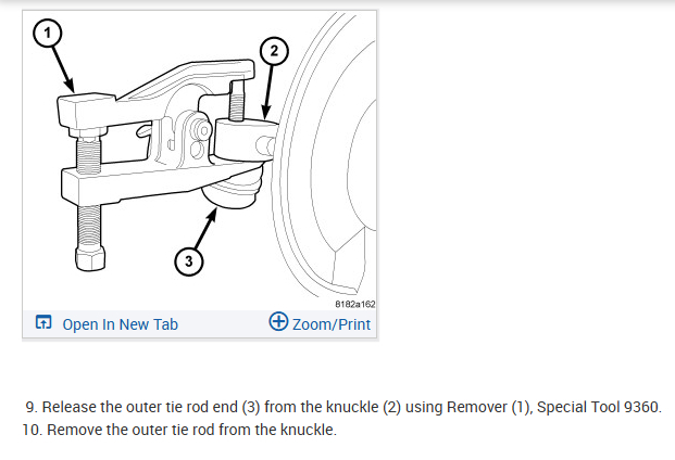

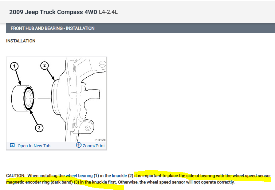

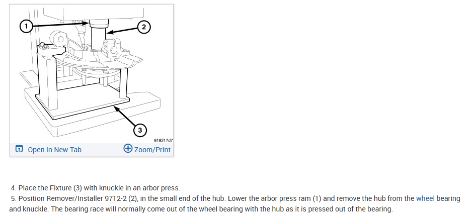

Before we get started, please be advised that the front hub bearing requires the entire steering knuckle to be removed. Also, you will need a press to remove the old bearing and then to reinstall the new one. If you don't have a press or access to one, you will not be able to replace the bearing.

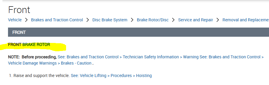

If you look below, I added all the directions you requested. I started with the brake rotor, then the steering knuckle, and then the wheel/hub bearing. Follow the directions for the rotor when replacing the brake pads. Once the caliper is removed, you can access the pads and replace them. In addition, here is a link that will help when replacing the brake pads.
Let us know if this helps or if you have other questions.
See pics below. Note: The vehicle will need an alignment when this job is completed.
