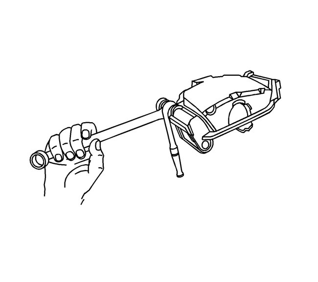

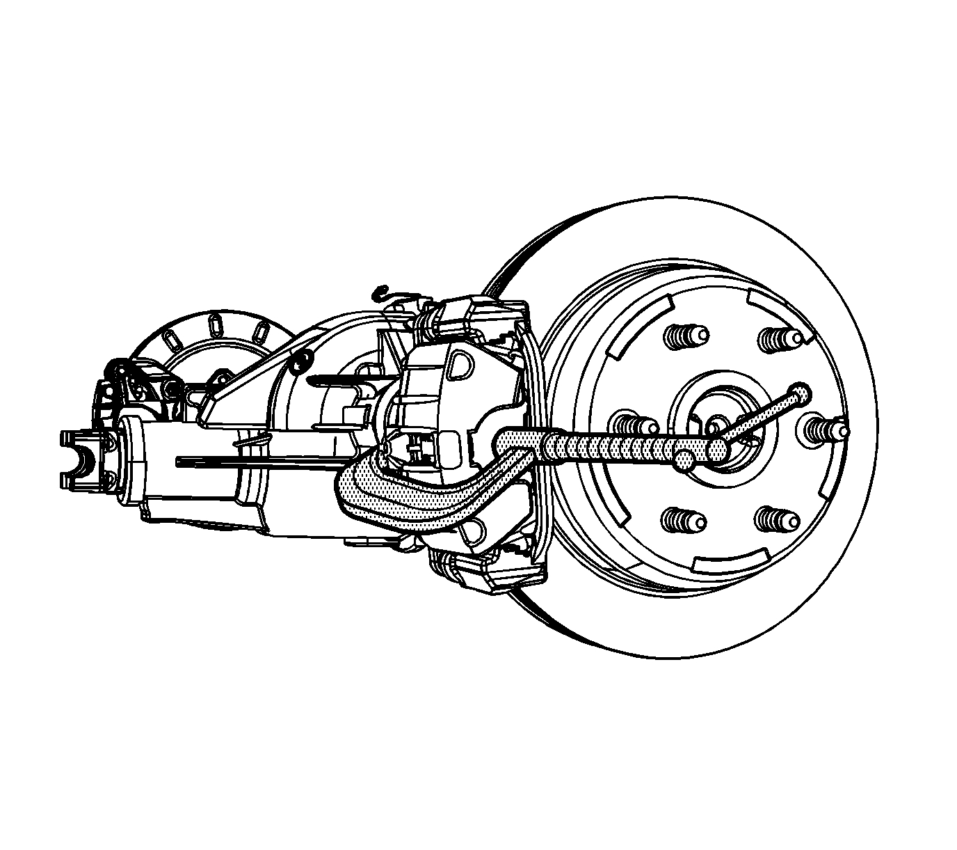

6. Compress the brake caliper piston.
1. Install a large C-clamp over the top of the caliper housing and against the back of the outboard pad.
2. Slowly tighten the C-clamp until the piston is pushed completely into the caliper bore.
3. Remove the C-clamp from the caliper.

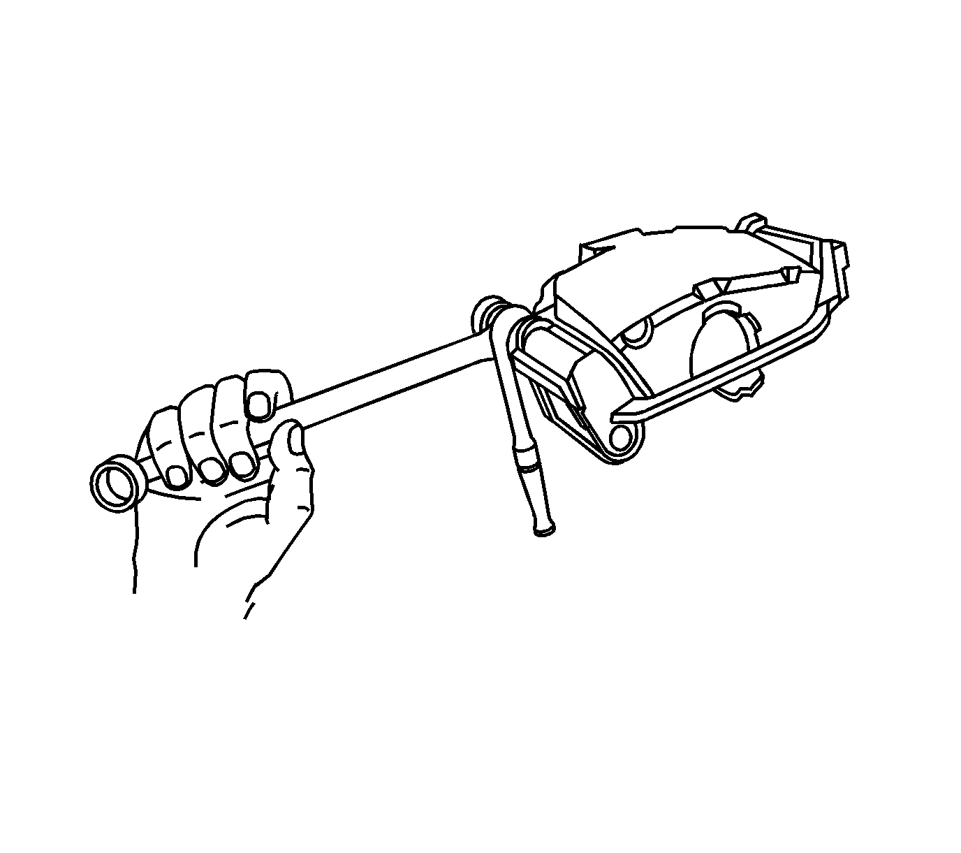

Note:
* DO NOT use any air tools to remove the guide pin bolts. Use hand tools only.
* Install an open end wrench to hold the caliper guide pin in line with the brake caliper while removing or installing the caliper guide pin bolt. DO NOT allow the open end wrench to come in contact with the brake caliper. Allowing the open end wrench to come in contact with the brake caliper will cause a pulsation when the brake are applied.
7. Using an open end wrench to hold the guide pin, loosen the guide pin bolt.
pic 3

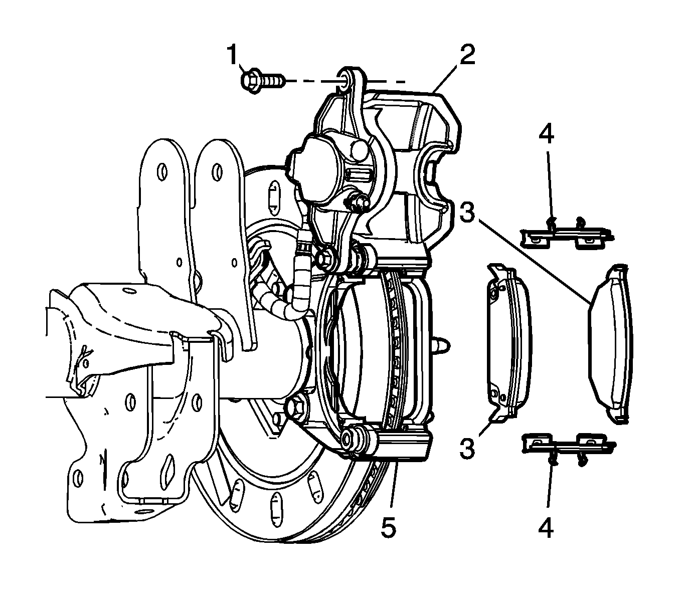

8. Remove the guide pin bolt (1) from the brake caliper (2).
Caution: Support the brake caliper with heavy mechanic wire, or equivalent, whenever it is separated from its mount and the hydraulic flexible brake hose is still connected. Failure to support the caliper in this manner will cause the flexible brake hose to bear the weight of the caliper, which may cause damage to the brake hose and in turn may cause a brake fluid leak.
Note: Do not disconnect the hydraulic brake flexible hose from the brake caliper.
9. Rotate the brake caliper (2) upward until it stops on the caliper mounting bracket (5) and support the caliper with heavy mechanics wire or equivalent.
Note:
* If installing the original brake pads and spring clips, mark the position of the brake pads and spring clips for proper installation.
* If installing new brake pads, install new pad spring clips. Do not reuse the old pad spring clips with new brake pads.
10. Remove the brake pads (3) and spring clips (4) from the mounting bracket (5).

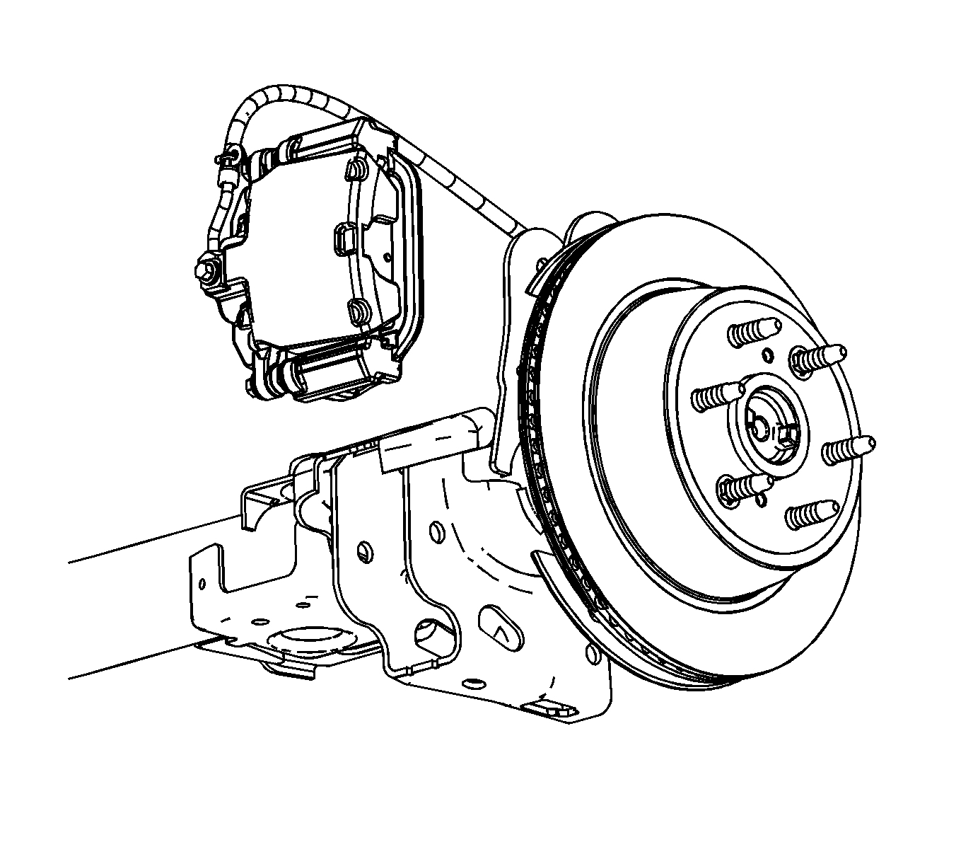

Installation Procedure
pic 4
1. Apply a very thin coating of high temperature silicone brake lubricant to the pad hardware mating surfaces of the caliper bracket only.
2. Install the spring clips (4) on the caliper mounting bracket (5).
3. If installing new brake pads, remove the adhesive backing paper from the disc brake pad insulators.
Note: If installing the original brake pads, note the locations marked prior to removal.
4. Install the brake pads (3).

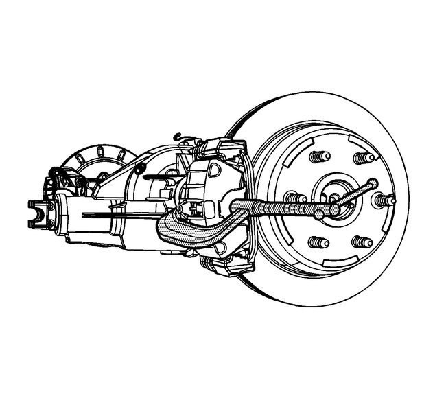

5. Remove the mechanics wire and rotate the brake caliper (2) into position on the mounting bracket (5).
6. Install NEW caliper guide pin bolts.
pic 5
Caution: Refer to Fastener Caution (See: Vehicle > Vehicle Damage Warnings > Fastener Caution).
Note:
* DO NOT use any air tools to remove or tighten the guide pin bolts. Use hand tools ONLY.
* Install an open end wrench to hold the caliper guide pins in line with the caliper while removing or installing the caliper. DO NOT allow the wrench to come in contact with the brake caliper. Allowing the wrench to come in contact with the brake caliper will cause a pulsation when the brakes are applied.
7. Use a open end wrench to hold the caliper guide pin while tightening the guide pin bolt to 38 Nm (28 lb ft).

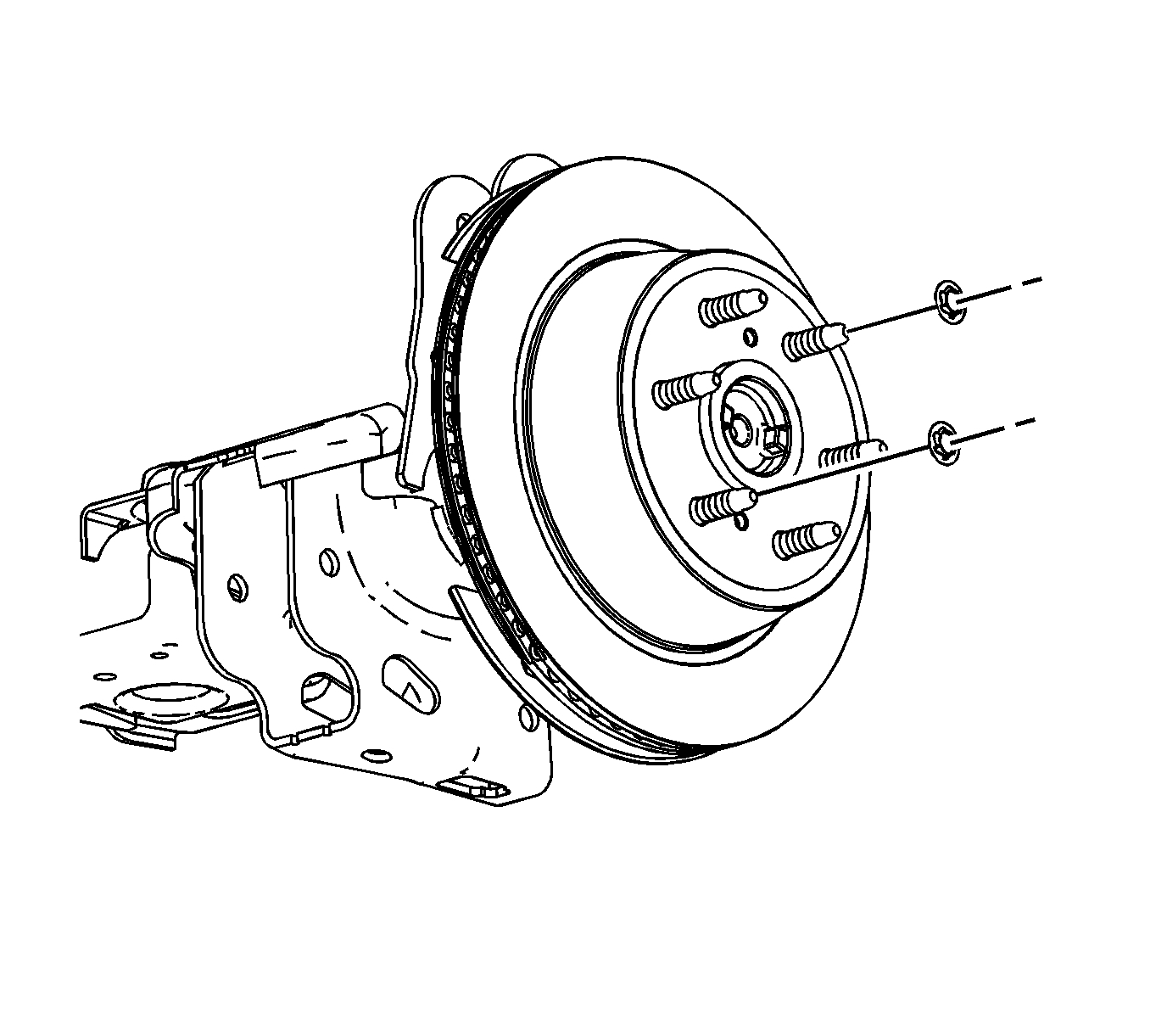

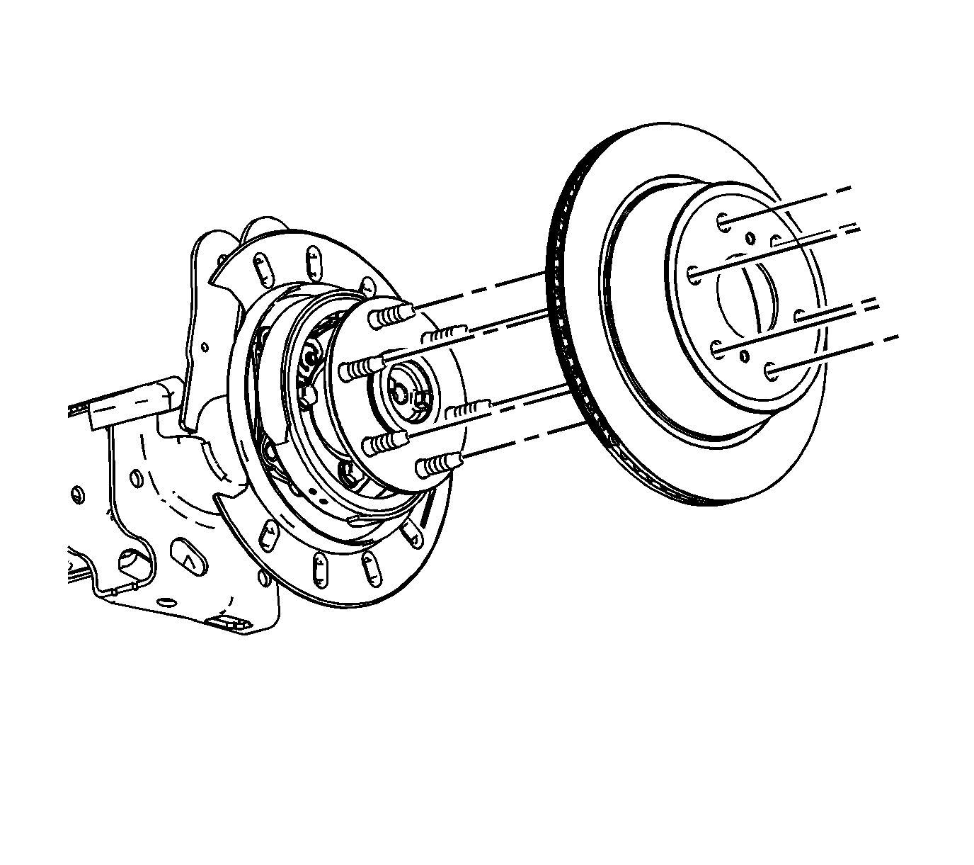

pic 8
12. Remove the push nuts from the brake rotor if necessary.
13. Apply a small amount of penetrating oil to the wheel studs.
14. Install the lug nuts on the end of the wheel studs.
15. Using a dead blow hammer, tap the brake rotor between the wheel studs.
16. Remove the lug nuts from the wheel studs.
pic 9
17. Remove the brake rotor from the axle flange.

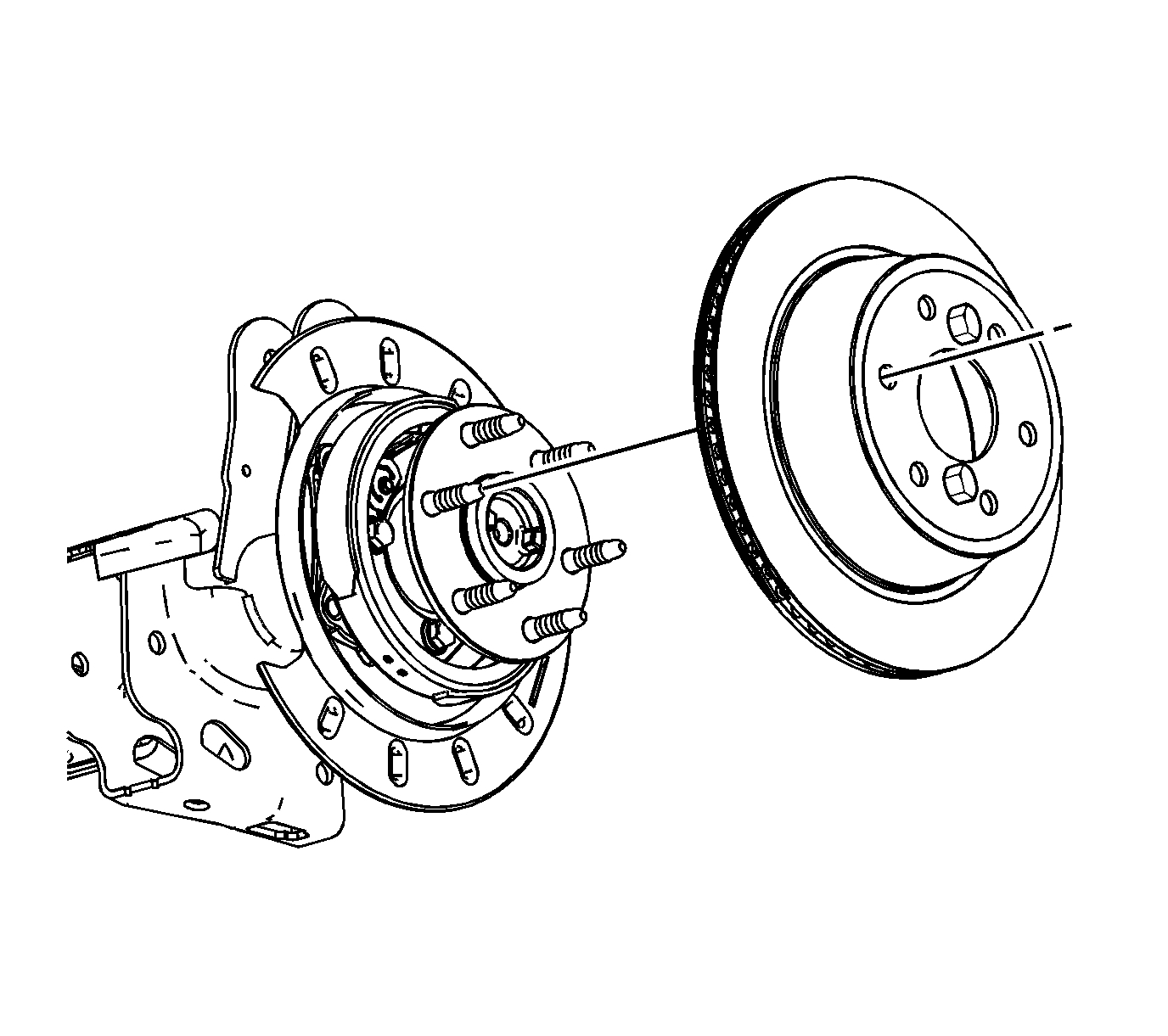

Note: Whenever the brake rotor has been separated from the hub/axle flange, any rust or contaminants should be cleaned from the hub/axle flange and the brake rotor mating surfaces. Failure to do this may result in excessive assembled lateral runout (LRO) of the brake rotor, which could lead to brake pulsation.
1. Using the J-42450-A - Wheel Hub Resurfacing Kit, clean the rust and contaminants from the mating surface of the hub flange.
2. Using the J-41013 - Rotor Resurfacing Kit, clean all rust and contaminants from the inside diameter of the hat section of the brake rotor to prevent any foreign material from getting between the brake rotor and the hub flange.
pic 10
3. Align the rotor to its original position on the hub, if applicable, and install the rotor.
pic 11
