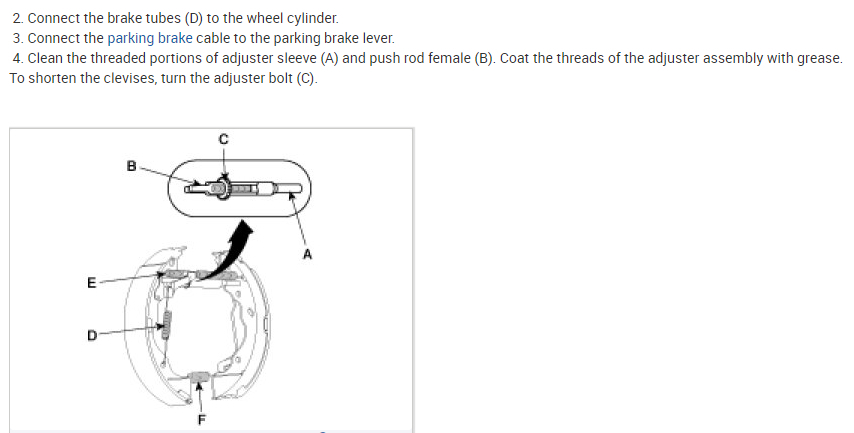

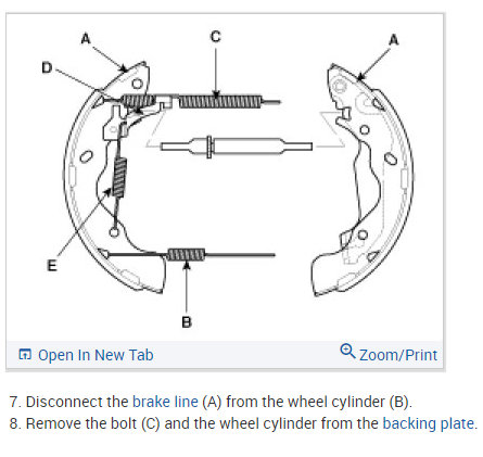

I need to do the rear brakes
2008 KIA SPECTRA
129,061 MILES • 2.0L • 4 CYL • FWD • AUTOMATIC
JMILLS76542
already replaced the front brakes now I need to do the rears.

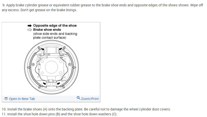

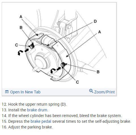

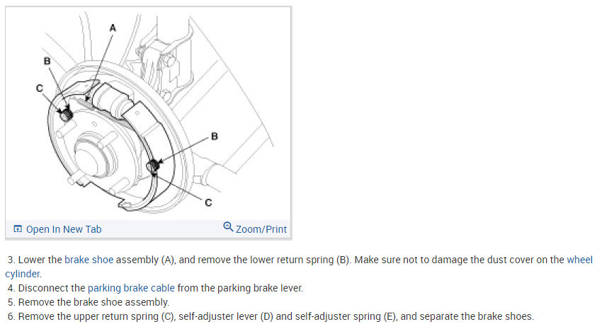

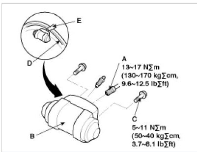

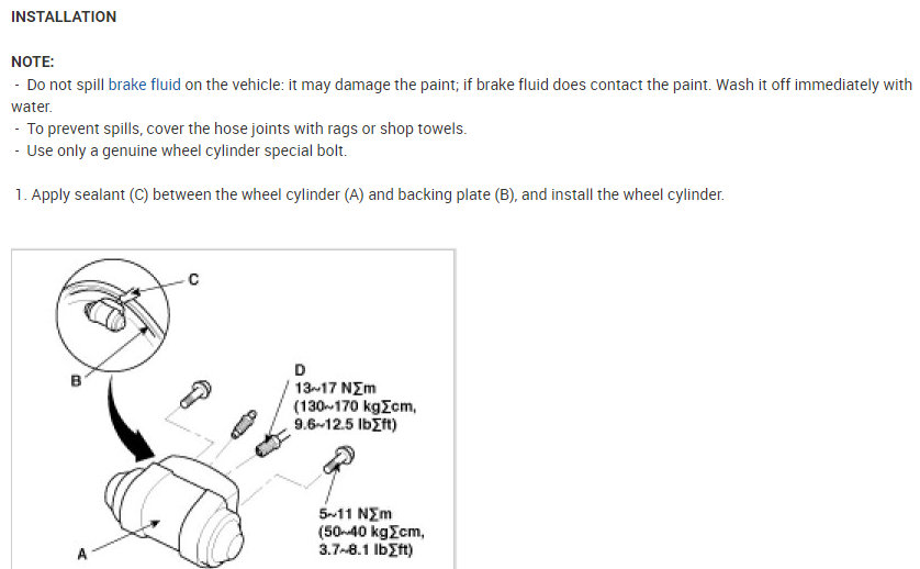

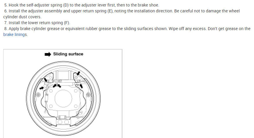

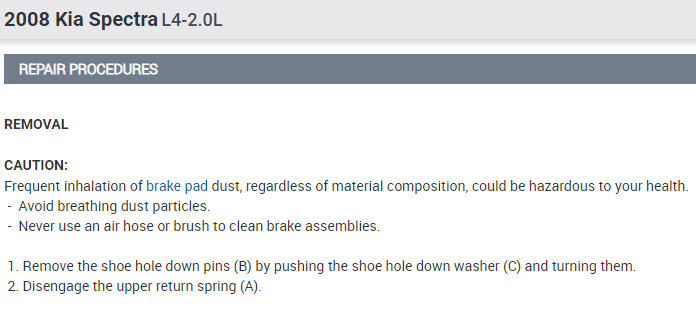

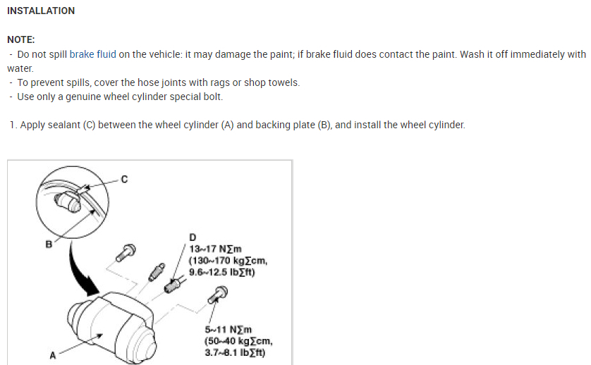

Here is the information you requested. Here is a guide to help you step by step with instructions in the diagrams below to show you how perform the repairs on your car:
I've attached a tutoring for parking brake shoe replacement which is similar.
https://www.2carpros.com/articles/parking-brake-shoe-replacement
I've attached picture steps below on how to replace the brake shoes on your car and it shows what special tools are needed to perform this repair. Hope this helps and thanks for using 2CarPros.
