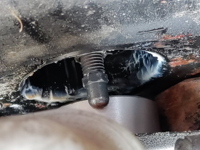

This dandy photo is of the push rod coming out of the power booster. Most often when these are adjustable, like it is here, it is on import models. It's rarely adjustable on domestic models. Readjusting that is not going to solve anything. This is not meant to be readjusted except for when it is first installed on the vehicle. If the pistons in the master cylinder are not fully retracting, it is usually due to the brake light switch is misadjusted and holding the brake pedal down an inch or so. You can often identify that by pulling the brake pedal up with your foot when the brakes are locking up.

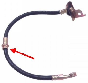

The most common cause of the symptoms you described are the flexible brake hoses, but you replaced those already. Rust build-up develops under the crimped fitting by the red arrow. Other models often have a mounting bracket crimped around the middle of the hose. Rust builds up inside the crimp too and constricts the hose. You can force some brake fluid through the restriction with your foot, but the fluid can't release back to the reservoir. Those crimps can be opened up with a pliers or large screwdriver to remove the restriction. The best way to identify these as the cause is that one brake caliper will release when the bleeder screw is opened, but next time it happens, it will remain locked if the steel line is loosened at the master cylinder.
When this happens, the brake drags enough to generate heat. That heat migrates to the brake fluid causing it to expand. That makes the trapped fluid apply the caliper even harder, then the pads generate even more heat until that brake locks up.

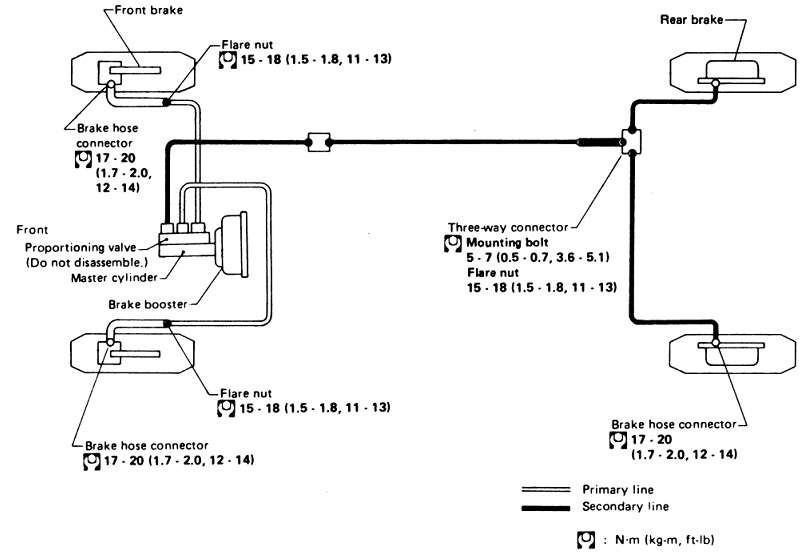

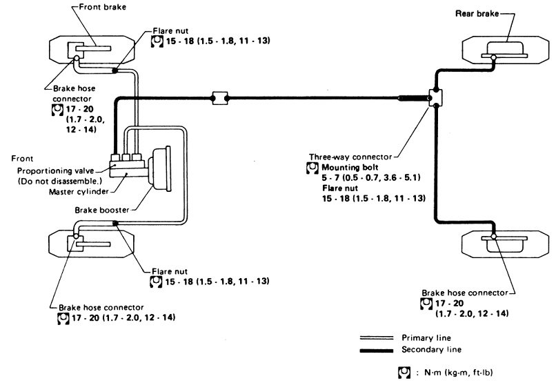

Update: I found the brake line routing diagram from Auto Zone. It's the second drawing below. It shows you have the standard front and rear hydraulic circuits. Even better, the two front lines start right at the master cylinder. That makes it convenient for loosening them to let brake fluid release.
Proportioning valves are not adjustable and are usually not in the master cylinder. (Trucks and minivans, and other models that can see a wide variety of loading in the rear often do use an adjustable height-sensing proportioning valve, but those are mounted in the rear, and won't cause locking brakes). Those are a story for another day. When proportioning valves are up in front, they're inside the combination valve assembly, and they are very carefully calibrated for the specific model with its unique set of optional equipment, (weight). These are definitely not a one-size-fits-all part. They rarely cause a problem. That said, yours is one of the few models that do put the proportioning valve in the master cylinder. They can be replaced separately, but they rarely cause trouble.

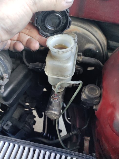

Interesting read. The new master cylinder just showed up. Nothing on visual inspection with the original matter cylinder shows signs of slimy rubber parts anywhere. Adding a picture before I touch it for visual ref.

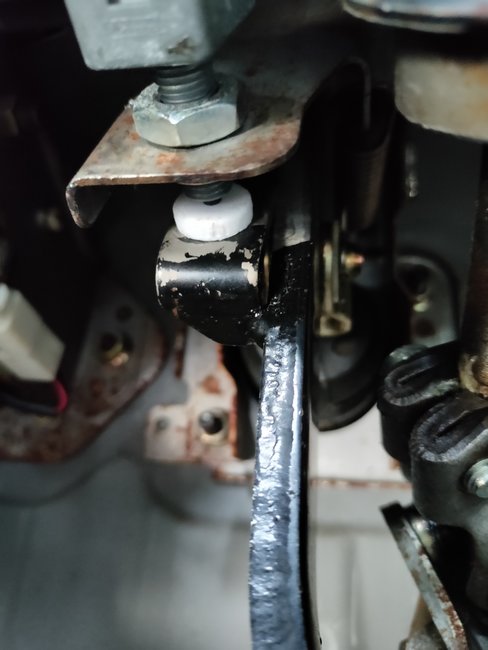

Side note: I did have the little pad crumble and fall off the brake pedal that touched the brake light switch to turn off the rear lights when I let off the pedal. I replaced it with a home fix until I was able to get a replacement pad to install. That was the calm before the storm. After that piece crumbled the alternator quit working and now, I'm here, lol. I can't imagine that little pad could lead to this but felt obligated to mention it.

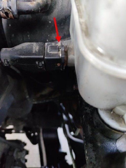

Update: there's a plug going into the side of the reservoir on top the old master cylinder that I can't get off to save my life. (Adding pic) Any ideas?

I'm relieved to see the rubber seal in the cap is okay. That shows we don't have to worry about fluid contamination.

If you look at this wire ring, you gotta pry that up with a small pick, then the plug can be pulled off. Then, push that ring back down so it doesn't fly off and get lost. To reconnect that plug, just push it on. The ring will lift up enough on its own to go back on, then it will already be snapped on to lock it again.

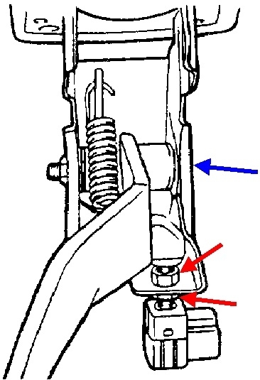

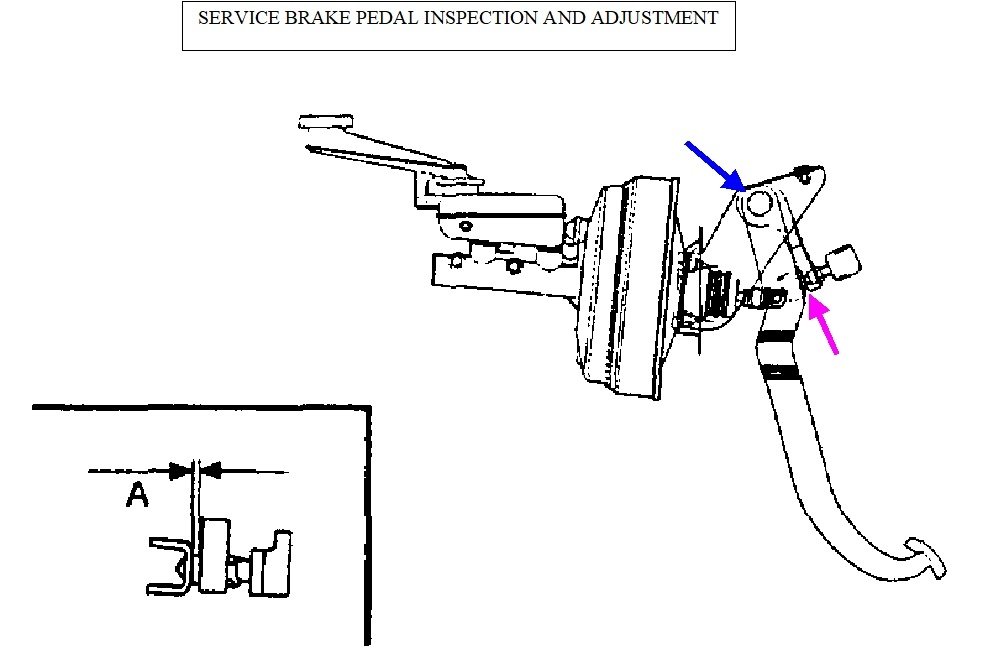

Okay, lets just give up and solve this. Here's what likely happened. The brake pedal arm pivots on the bushing with the blue arrows. That bushing can become sticky causing the pedal to not return fully under its return spring tension. When this happens in your driveway, it leaves less pressure between the pedal arm and the brake light switch. That could allow that cap, or button on the end of the switch to fall off, especially in hot weather. That keeps the brake lights on. You solved that with a temporary cover that might be thicker than the original part. Many people adjust the switch forward and don't replace that rubber cap. The problem is they adjust the switch to meet the pedal when it's in the stuck position, which is partially-applied.
With normal driving before any of this happened, normal road vibration causes the brake pedal to return fully almost right away. There's no brake locking problem. When you do have to work on the switch, you aren't aware the pedal isn't fully returned, and you adjust the switch just to the point it is turned off and the brake lights are off. Now when you start driving, the pedal can't come back any further because the switch is holding it down and partially applied. It only has to hold the pedal down a little to move the pistons in the master forward enough for the lip seals to pass the fluid return ports and trap the brake fluid ahead of them. That's when the fluid gets pushed to the wheels when you push the brake pedal further. But now, since the pistons can't come back far enough to expose those ports, the fluid remains trapped and gradually builds up heat from the dragging brakes, and pressure, which applies the brakes harder and harder as you drive.

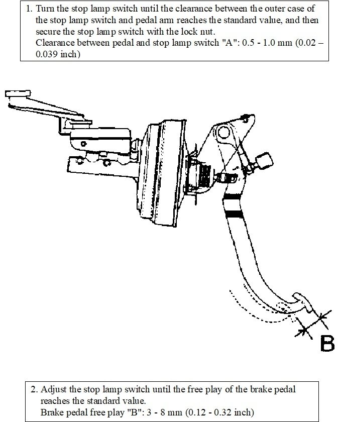

The easier clue that often works is to pull the brake pedal up with your foot when the dragging brakes occur. On most Asian imports, the brake light switch is mounted on a thin metal bracket that can be bent with foot pressure to allow the master cylinder to fully release.
The best fix for your vehicle, if you haven't readjusted the brake light switch, is to find the original cap and glue it back onto the switch. If your home made repair is otherwise working well, just readjust the switch. The instructions are included with these last two drawings.
At first logic would dictate you can accomplish the same results by shortening the push rod in the front of the power booster. In fact, yours is one of those that is adjustable, but that was carefully set at the factory. In fact, the rubber diaphragm has an at-rest or released position. When you press the pedal, all that happens is it opens a vacuum valve that lets vacuum come into the front chamber of the booster. That vacuum pulls the diaphragm forward and the push rod is attached to that, so it also moves forward to push on the master cylinder's pistons. As the diaphragm moves, the vacuum valve catches up to the brake pedal and closes, then no further movement occurs. If you decide to push further on the brake pedal, you just open the vacuum valve again and the process repeats until the diaphragm pulls the valve closed again.
The point of this sad story is when you release the brake pedal, it opens a vacuum release valve, then atmospheric pressure is on both sides of the diaphragm. A huge internal spring wants to center it, but it can't quite get there due to the brake light switch holding the pedal down a little. With the diaphragm not being centered, the vacuum release valve can still be slightly open. You may be able to hear a constant hissing as engine vacuum has a leak now. Just as you want the master cylinder fully released, you want the booster's diaphragm to be centered too, and the only way to achieve that is to address the brake light switch.
I should mention too that there is a two part metal push rod between the brake pedal and the diaphragm in the booster, but there's a significant gap between the two parts. They never contact each other during normal operation. It's only when engine vacuum is lost that this assembly becomes the back-up link, then the pedal pushes the diaphragm mechanically. That accounts for the longer pedal travel. You're also pushing against that big return spring in the front chamber of the booster. That's why the pedal is so hard to push.

Sir, I cannot thank you enough. A quick adjustment to the brake light switch and I trimmed the bumper down, so it fits better, and problem solved. Being able to reach out like this and get real answers with the theory behind things is worth its weight in gold. You are a gem. Thank you!
