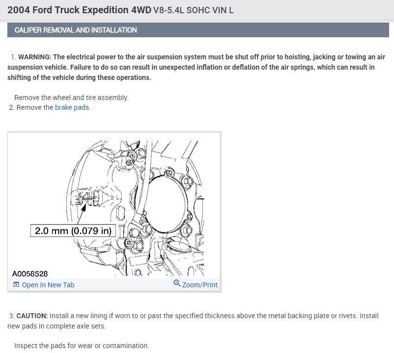

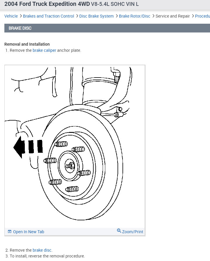

I will be changing the front brakes rotor caliper and hose on the vehicle listed above XLT, SOHC V16. I would like to get some more information on how the removal and replacement.
Jun 28, 2022 at 12:41 AM
SQM
  • 6,383 POSTS

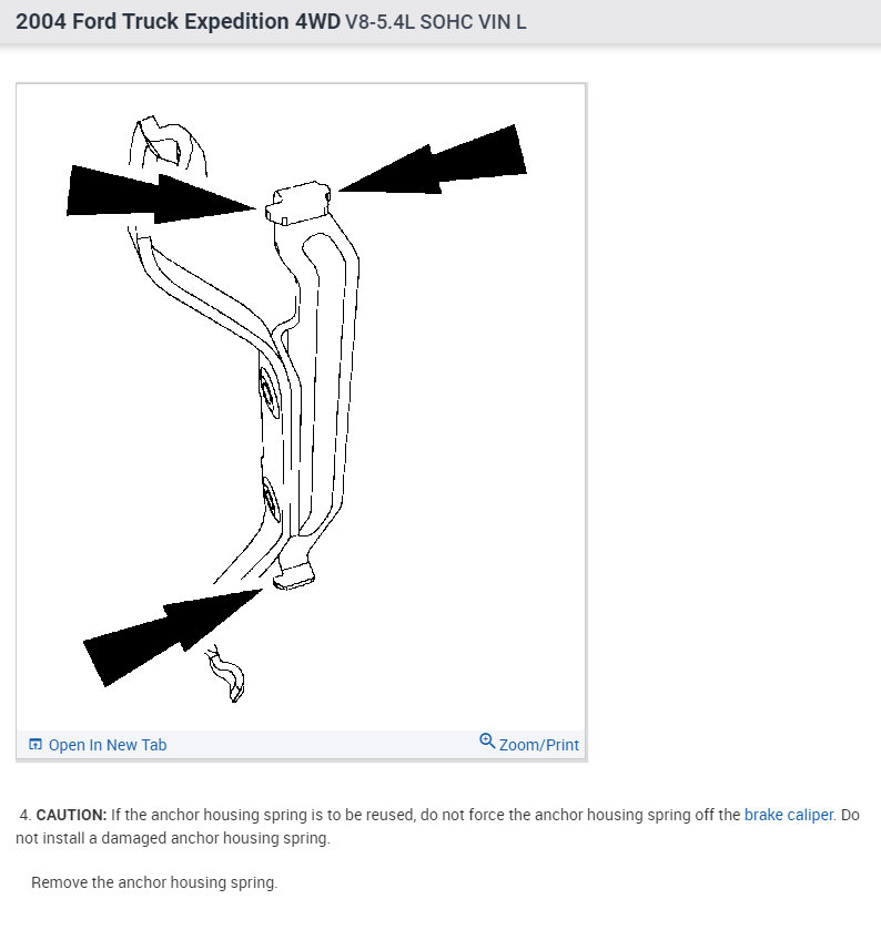

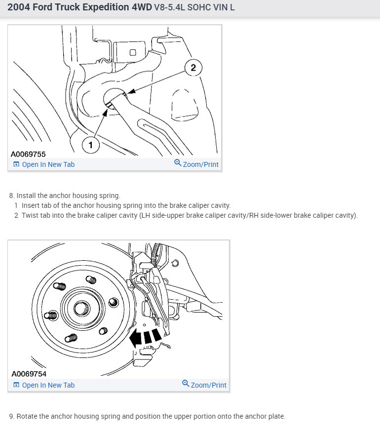

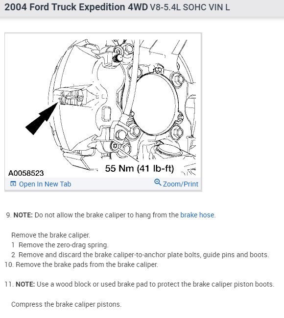

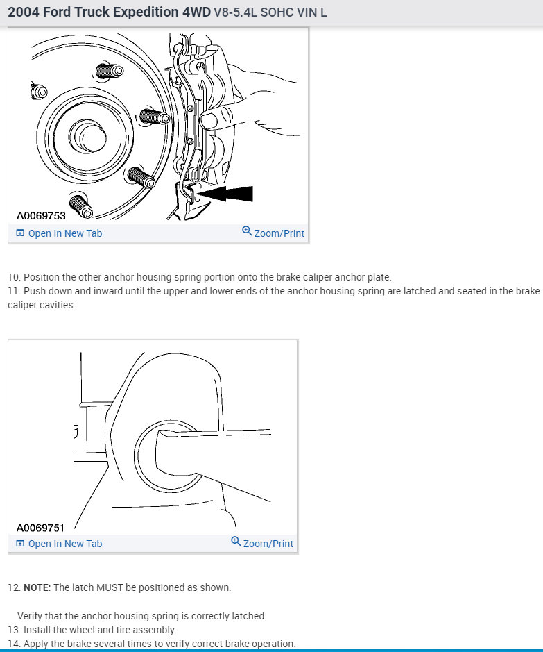

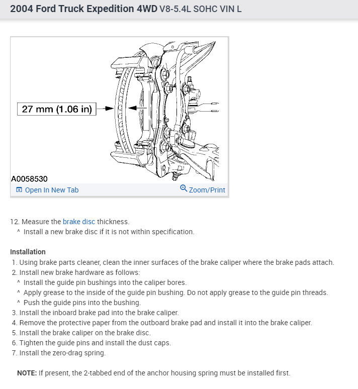

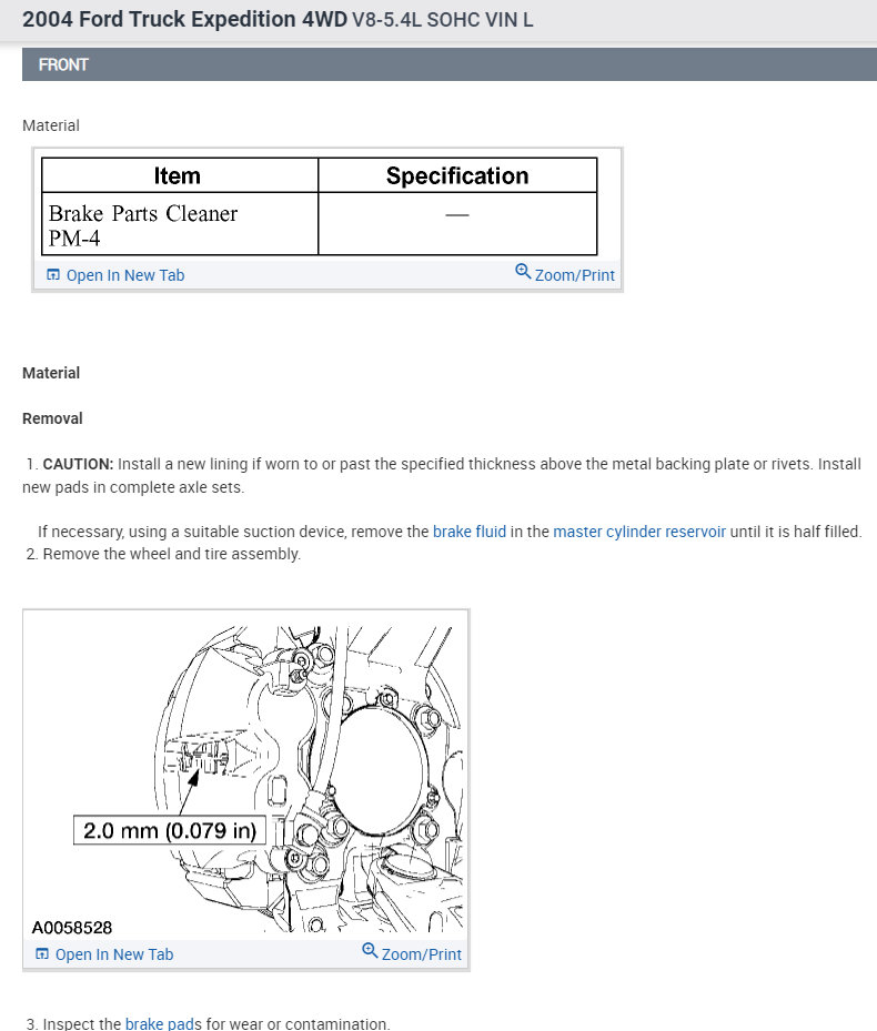

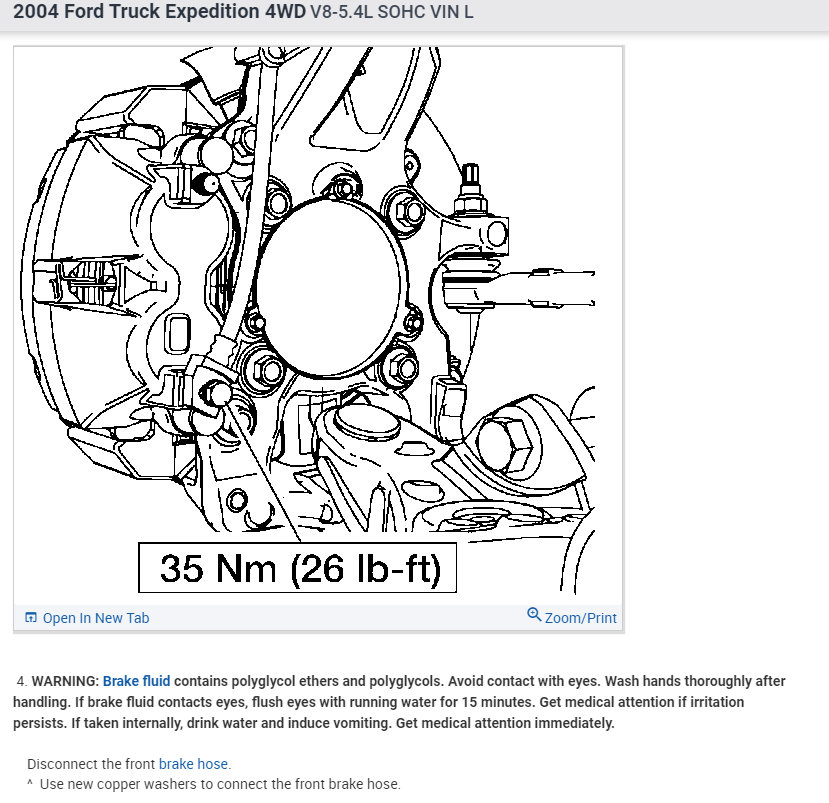

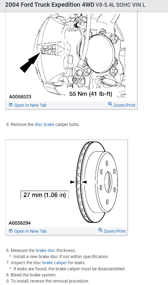

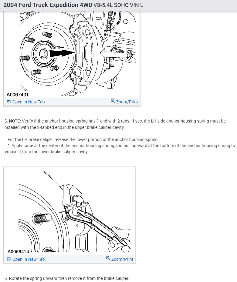

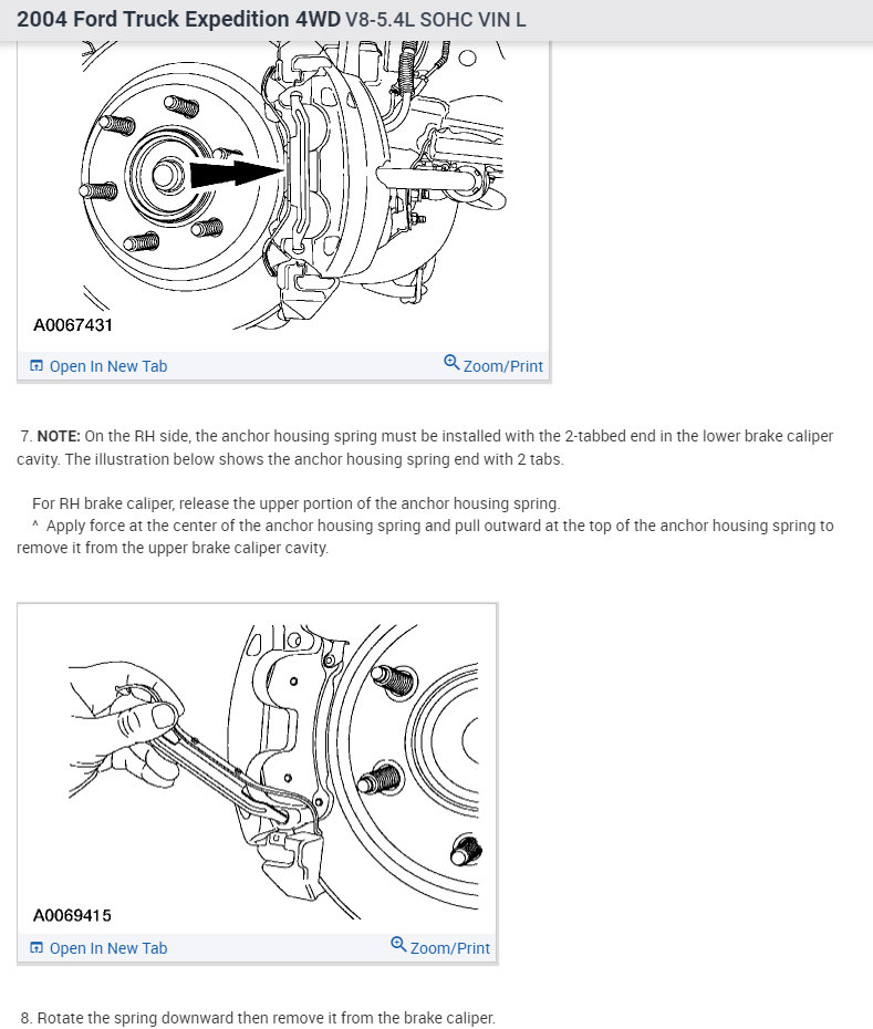

I have attached the replacement procedures for the pads, rotors, calipers below for your reference. It has all the torque specifications as well.
Keep in mind that you will have to bleed the brakes after replacing the caliper and the hose.
Here are a few helpful guides.
https://www.2carpros.com/articles/brake-caliper-replacement
https://www.2carpros.com/articles/how-to-bleed-or-flush-a-car-brake-system
Let me know of any questions.
