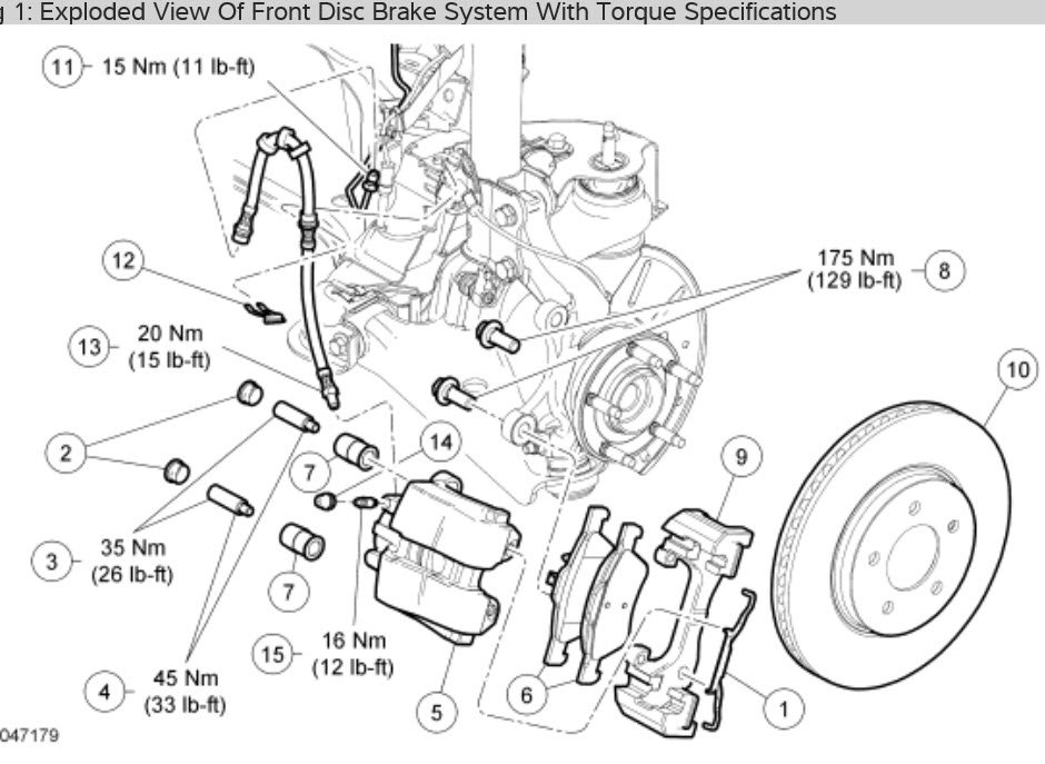

When changing the brake pads and rotors in the front is there a difference between the gas engine and a hybrid engine?

No that stuff is pretty much the same just the hybrid stuff is different. see picture of front. See link. Not exactly yours but close on how to do it.
Image (Click to make bigger)
