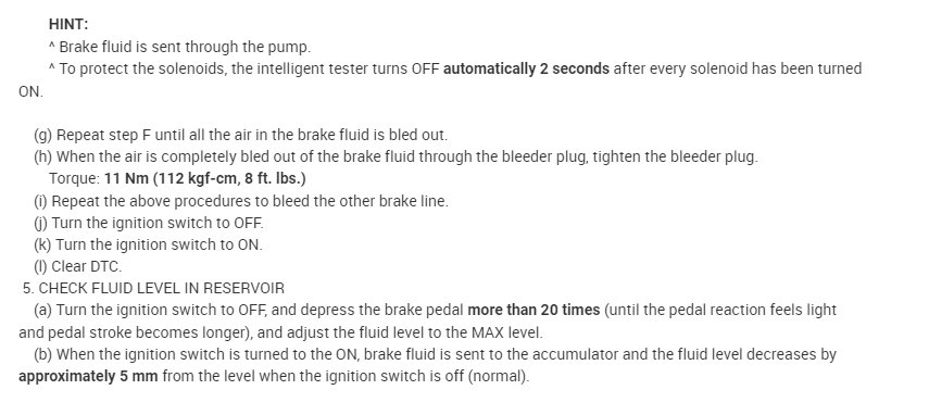

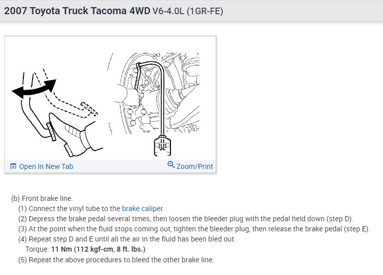

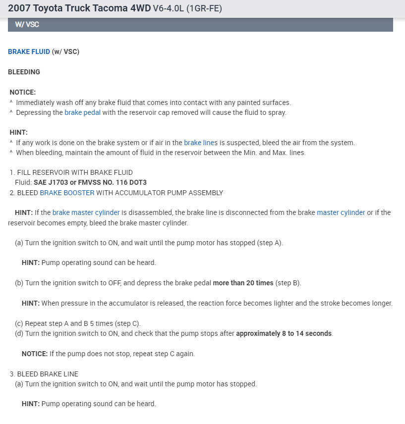

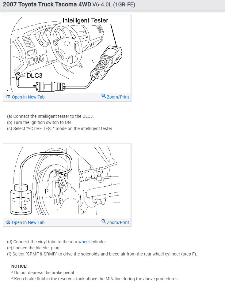

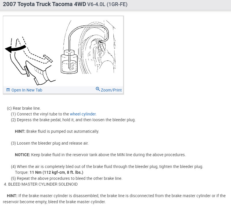

Just to make sure, have you bled the brake system of all the air after the master cylinder replacement?
Keep in mind that these vehicles will need a scan tool to properly bleed the brakes.
