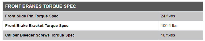

I'm attempting to do my first brake and rotor replacement on the vehicle listed above SE model.
I've watched enough videos to be sure of how to do the job, however I've gotten thoroughly confused about exactly what to torque the pins and brackets.
The question: What are torque specs for the Front brake bracket bolts... and for the slide pins?
I believe the lugs are 100 ft lbs and the bleeder screw is 10 ft lbs. Please give me a solid answer because I know the importance of a job done properly.

Here are the front brake caliper and brake torque specs.

Thanks for the response. The only discrepancy I've seen is the bracket bolts were 124 ft lbs according to the Goodyear printout sheet. I asked them to do this in the meantime of answering here...they said that's what they would do in their shop for me.
