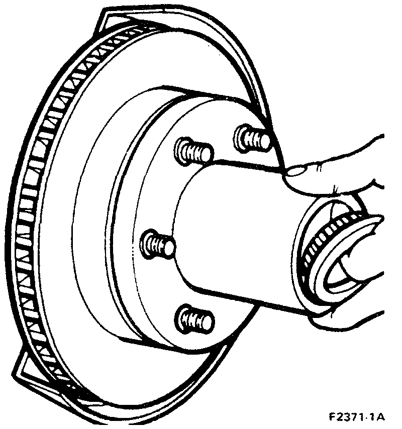

When you pull the hub off of the spindle does the hub separate from the rotor?
Dec 20, 2020 at 7:48 PM
  • 110,248 POSTS

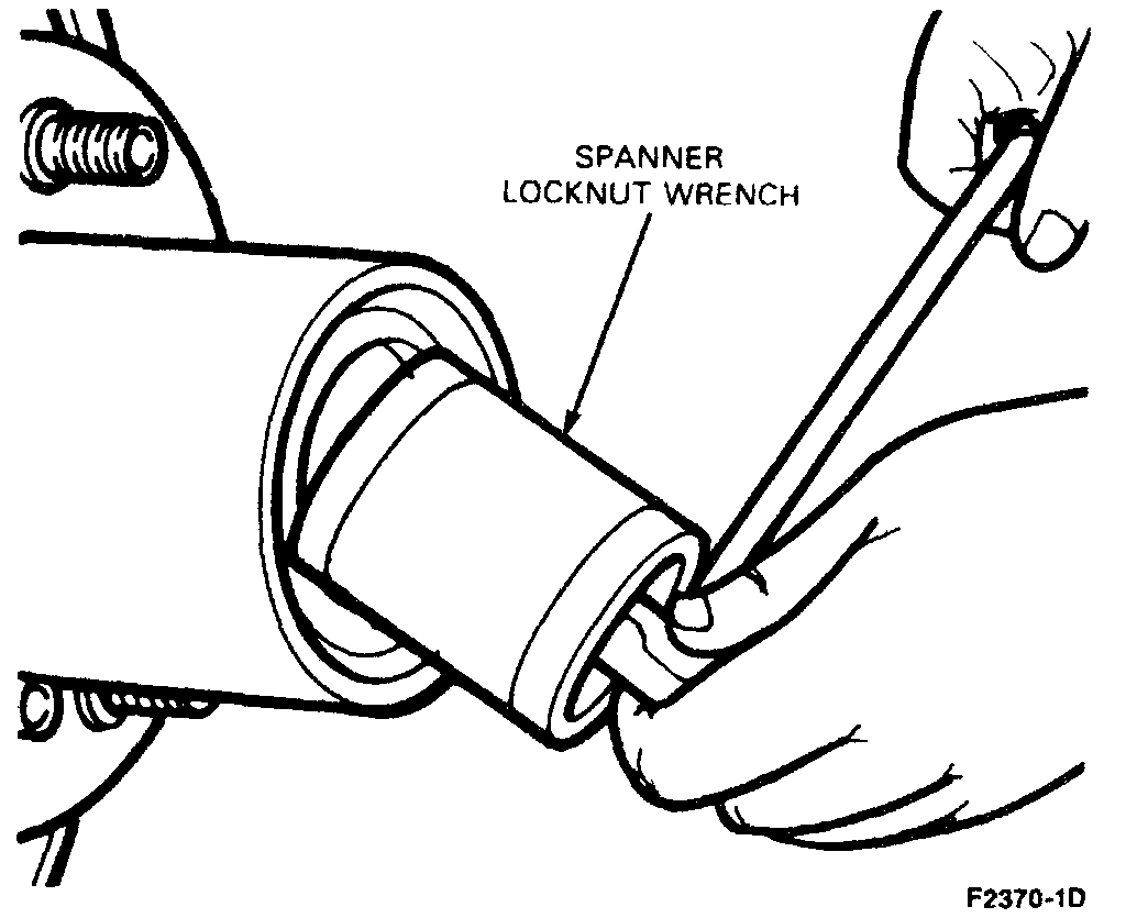

Yes, they will come off together. Here are the directions specific to your vehicle. I'm adding them because based on the differential used, the axle could be different. The attached pics correlate with the directions.

4. For vehicles equipped with Dana model 44 front drive axle and manual hub lock, remove the adjusting nut with spanner locknut wrench. Apply inward pressure on the locknut wrench to disengage the adjusting nut locking splines and turn the nut counter-clockwise to loosen and remove the nut from the spindle.
For vehicles equipped Dana model 44 with automatic hub locks, Dana model 50 and model 60 front drive axles, remove the outer locknut, lock washer and inner locknut with spanner locknut wrench.

6. Remove the hub and disc assembly. The outer wheel bearing cone and roller assembly will slide out as the hub is removed.
