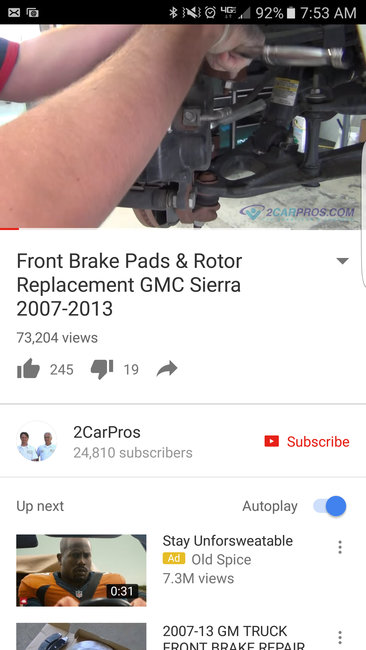

I was viewing your YouTube video for the pads and rotors
2011 CHEVROLET SILVERADO
180,000 MILES • 6.0L • V8 • 4WD • AUTOMATIC
JEFF M VOYTKO
I was viewing your YouTube video for the pads and rotors on a 07-13 Sierra and was curious if it would be the same procedure for the Chevrolet 2500 HD? would it be the same size sockets and tools that would be required?

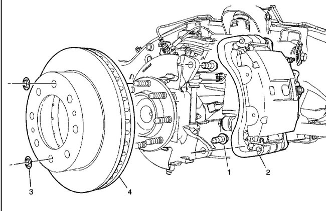

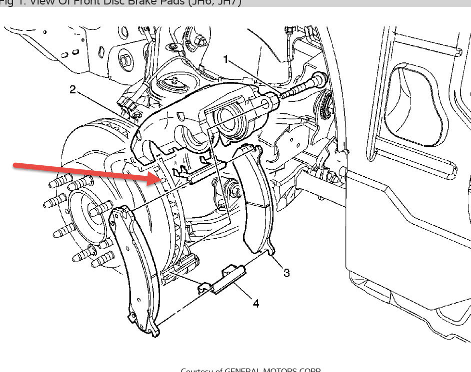

it is pretty much the same except bolts may be a little different size wise. there are two different types of brakes/pads it will either be jd9 jf3 jf7 or jh6 jh7 those codes will be on glove box door normally sometimes on door/jamb. auto parts will need to know this and make sure to replace brake pad spring shown with arrow in picture.
