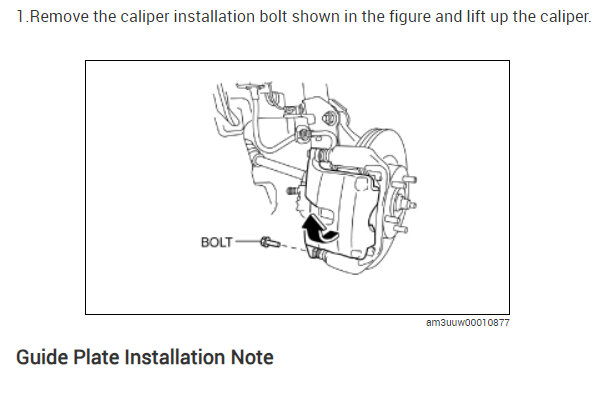

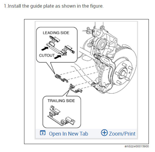

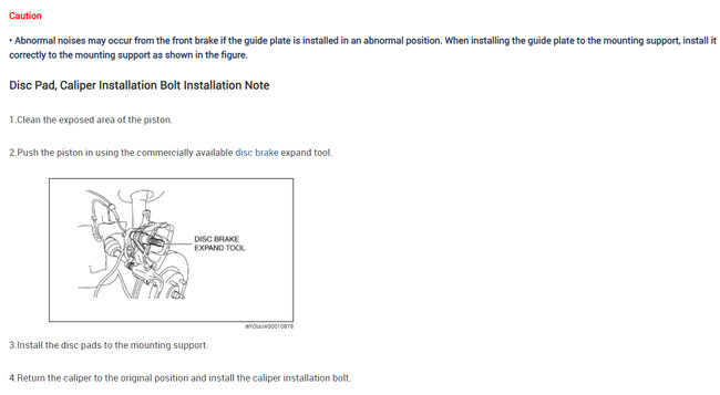

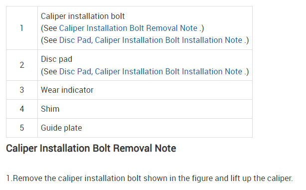

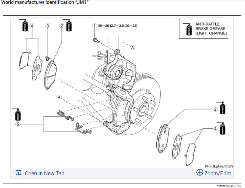

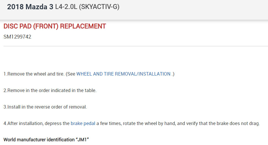

I would make sure the pads have not been installed backwards, (metal backing plate to the brake rotor) I know it sounds weird, but I have seen this problem more than once. Also, make sure the caliper slides have been serviced. Here is a guide to help and I have included how to change the brake pads out correctly in the images below:
https://www.2carpros.com/articles/discover-why-automotive-brake-pads-wear-unevenly
Also, check the brake pads retainer clips they need to be installed correctly, and they can be tricky, the instructions show how they are to be installed as well. Check out the images (below). Please let us know what happens.
