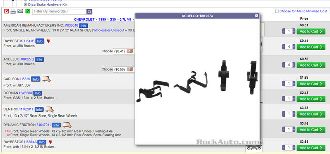

I have a 1995 G30 1 ton van and in the process of replacing the front disc brake pads. I removed the anti rattle clip on both sides and did not note the correct orientation. would someone have a clear picture of how the clip is installed? Thanks

Good morning,
I attached a picture of the hardware kit for you to view. The double attaching part goes to the top of the pad and the single snaps on the lower part of the pad.

RTOSI
I should have mentioned these are wedge style calipers. The clips look like these. I am just not sure of the correct orientation.
May 10, 2021 at 12:33 AM
They go on the edge of the pads to keep them from moving in the caliper.
They push on to the edge and then just fit into the caliper.
