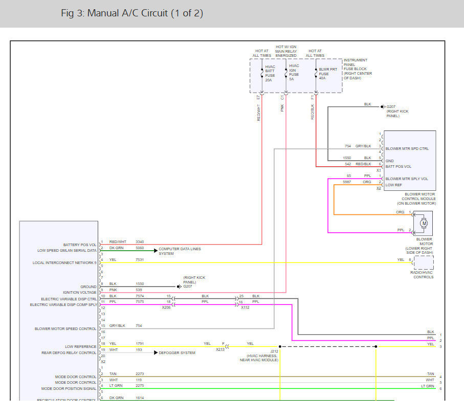

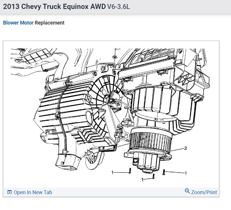

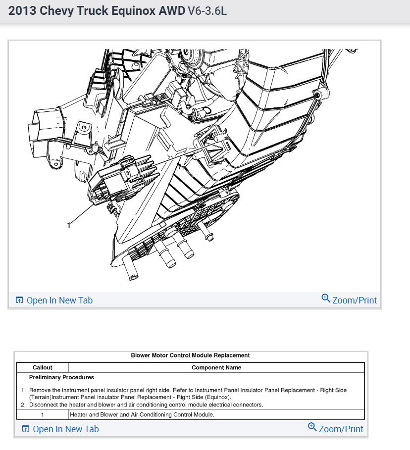

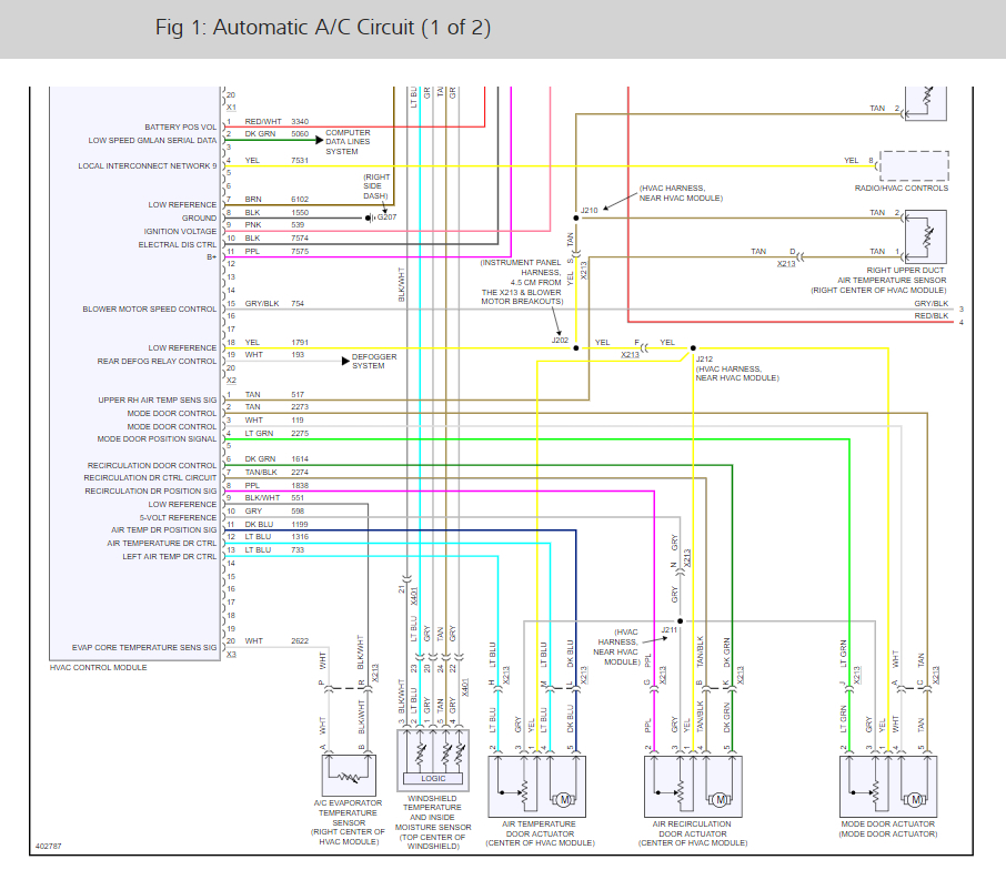

The air conditioning works, but the front blowers are not blowing any air. The air does work when turned on from the foot area. I have checked all of the fuses and they all looked good. What is my next step?
Jun 8, 2017 at 5:21 AM
HMAC300
  • 48,601 POSTS

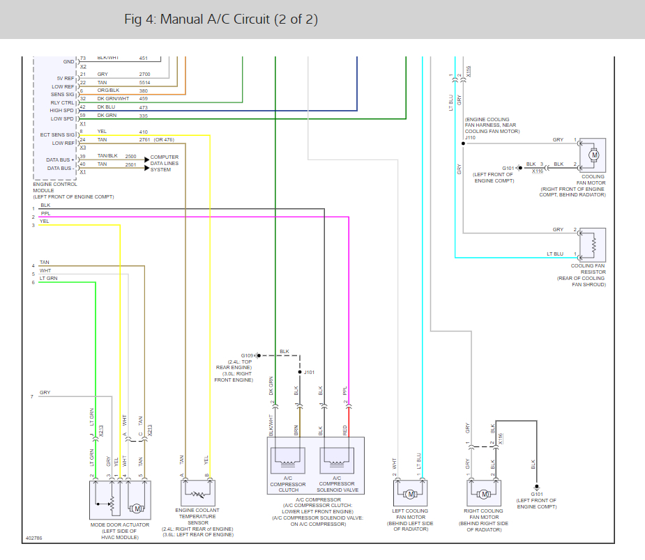

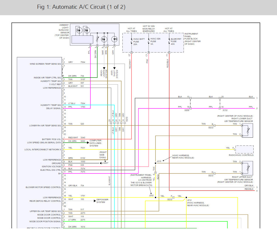

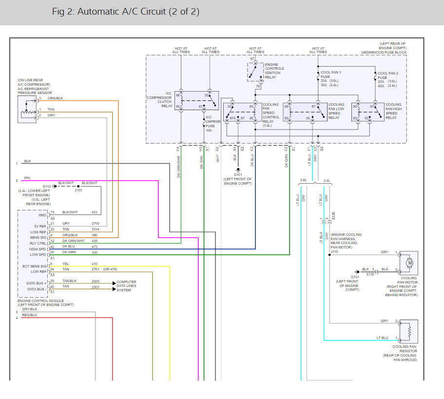

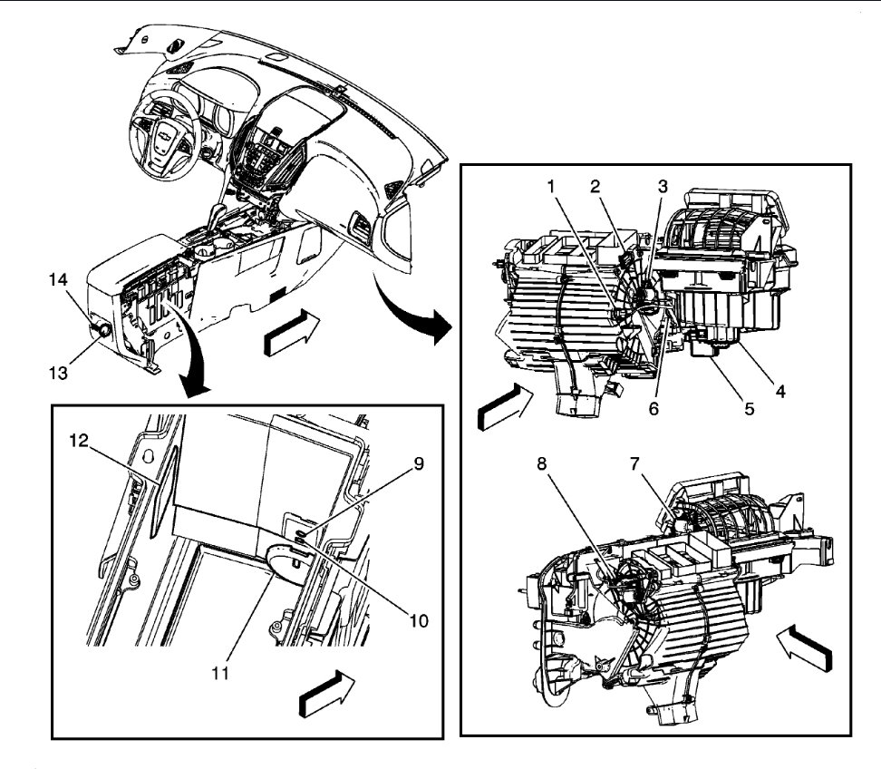

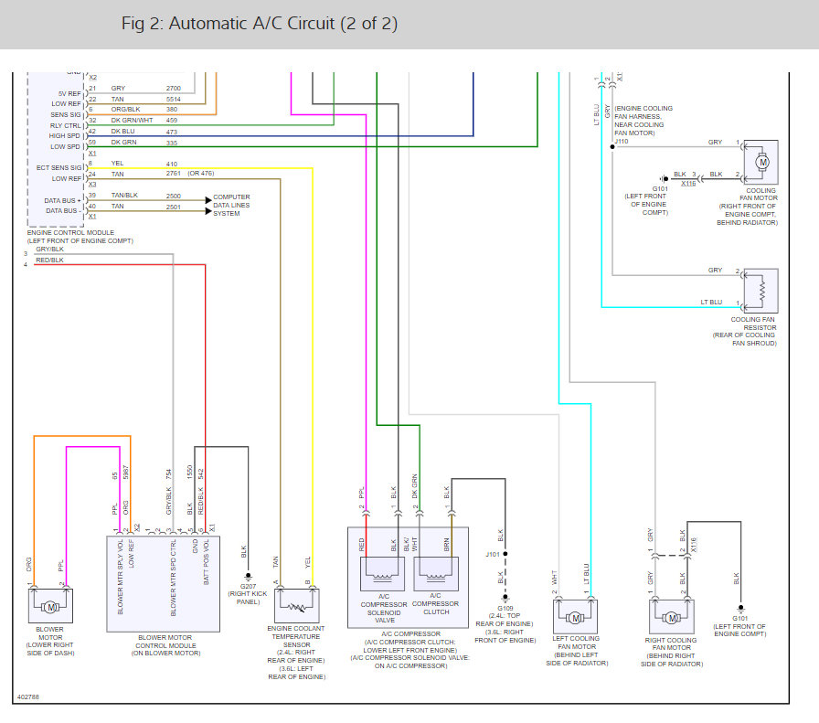

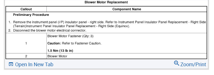

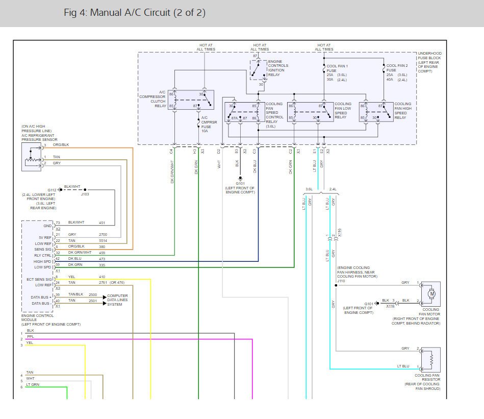

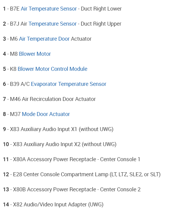

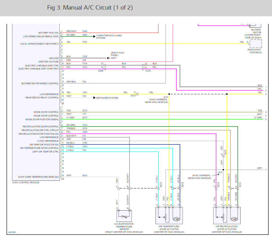

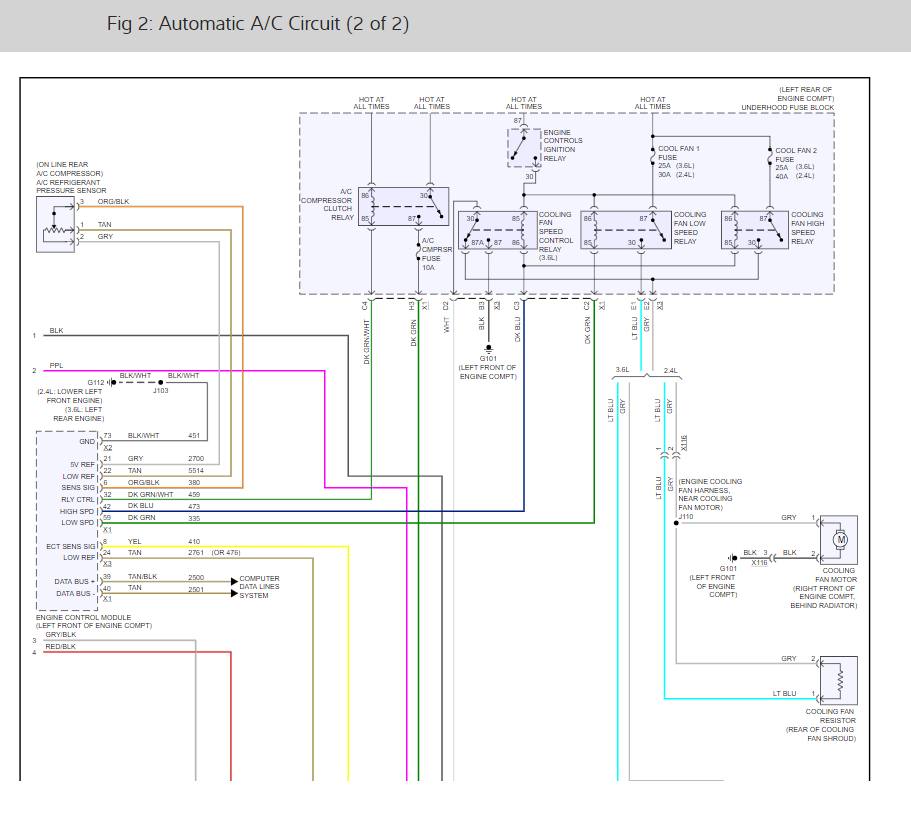

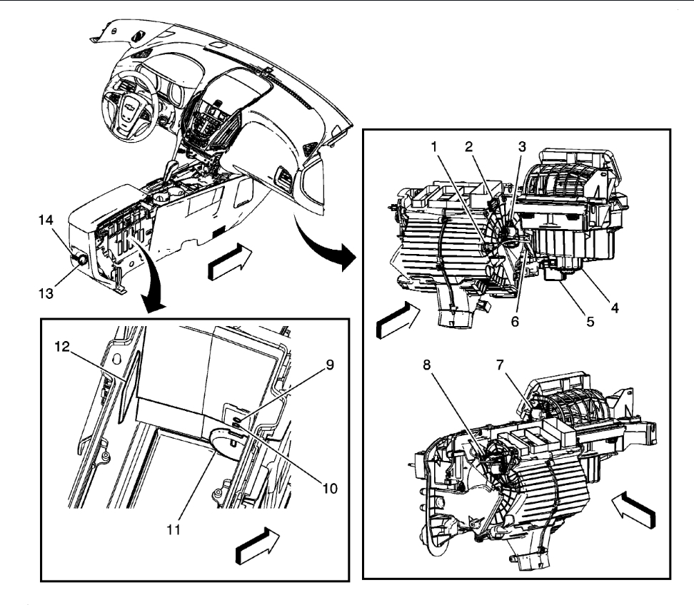

9 times out of 10 it will be the blower motor or the blower motor controller but to be sure use this guide to help check for power at the blower motor. Also check the diagrams below to see how the system works (HVAC wiring diagrams) and which fuses and relays run the system. The instructions in the diagrams below show your car.
https://www.2carpros.com/articles/blower-fan-motor-works-on-high-speed-only
Check out the diagrams (Below). Please let us know what you find. Wiring diagrams are for both auto and manuals systems.
Jun 8, 2017 at 6:52 AM
SLAUGH009
The guide was great thanks you I found the blower speed module (cost $89.00) was out replaced it and bam! Working again, this site rocks!
