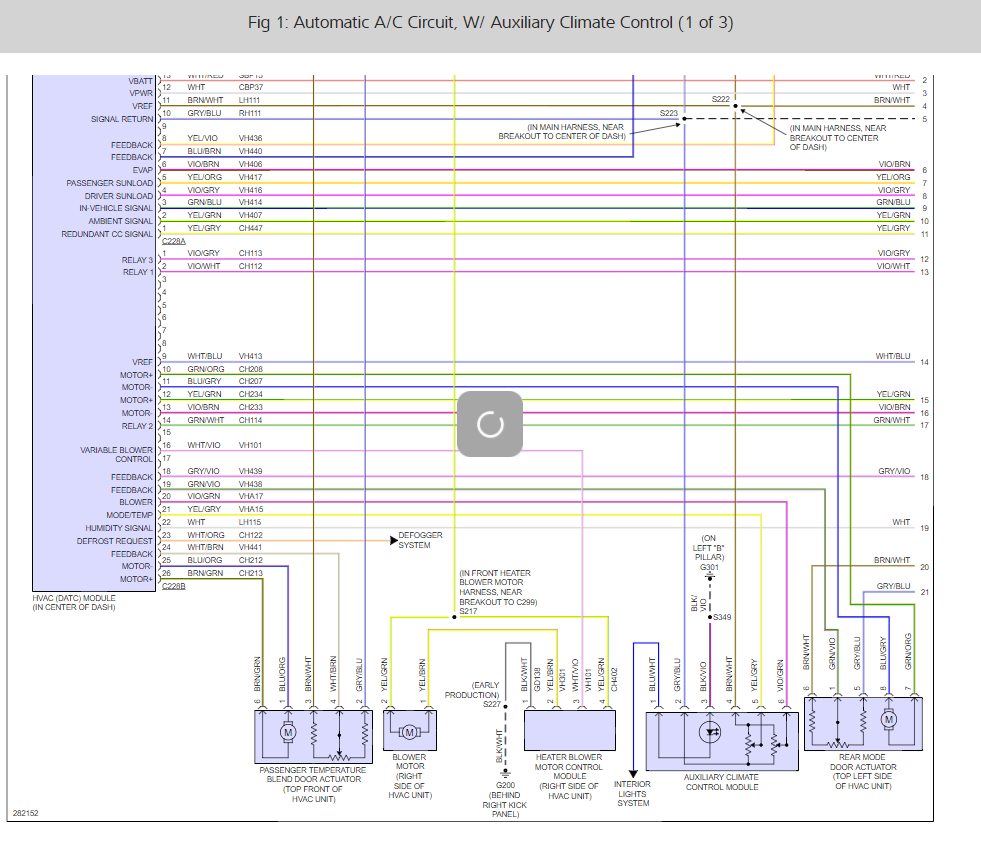

front blower motor runs five seconds and shuts off for thirty seconds
2008 FORD EXPEDITION
99,000 MILES • 5.4L • V8 • 2WD • AUTOMATIC
CAD1030

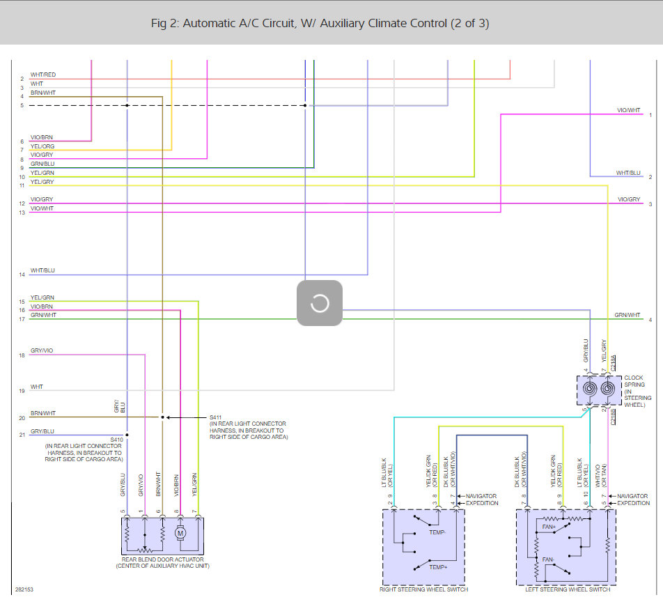

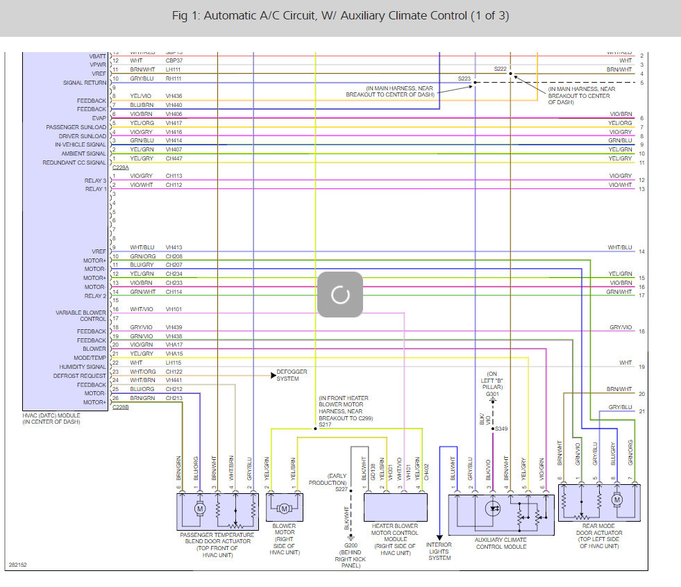

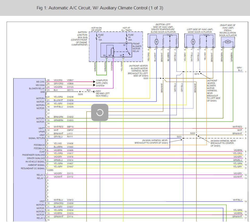

my front blower motor run for about five seconds then shuts off for forty five to fifty seconds and will do this on auto or manual mode. Heat or A/C, the rear blower works fine. I have replaced the blower motor relay with the correct on and also replaced the wire plug.
Aug 22, 2017 at 8:41 AM
  • 54,840 POSTS
It sounds like the blower motor is going bad. Here is a guide that will help you confirm the problem by testing for power at the motor while it is not working.
https://www.2carpros.com/articles/blower-fan-motor-works-on-high-speed-only

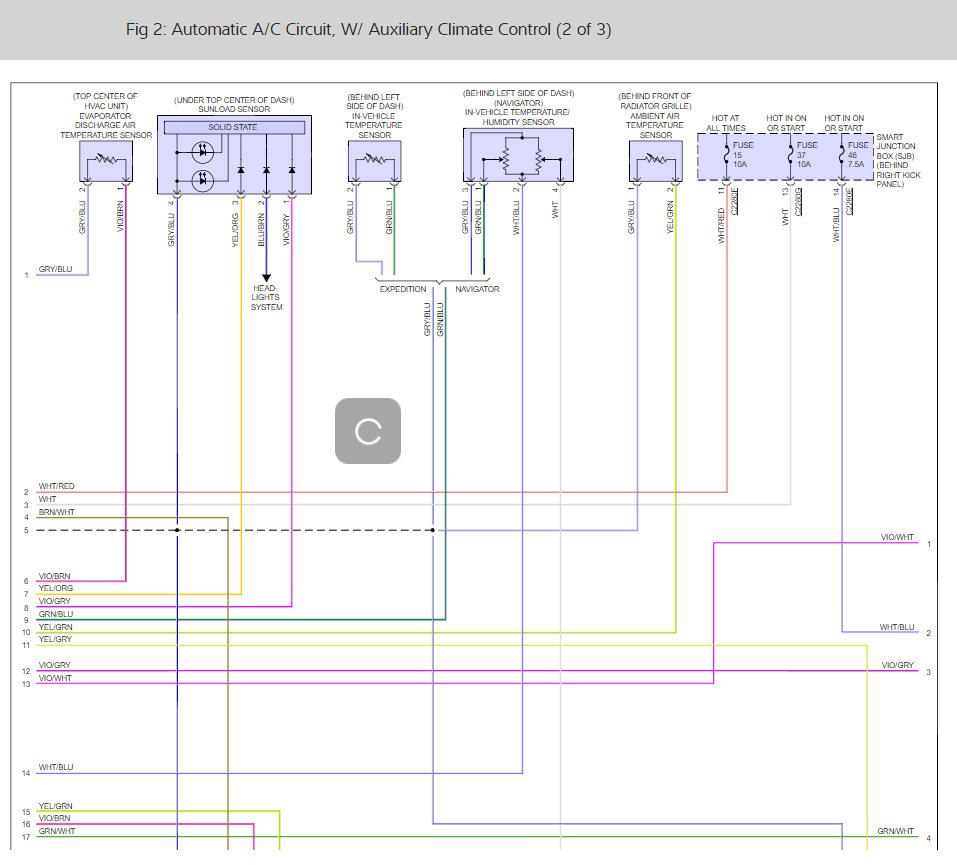

There is also a blower motor fan controller right at the blower motor I would suspect as well.
Here is a guide and some diagram to help with the testing.
Please run some tests and get back to us so we can keep helping you.
