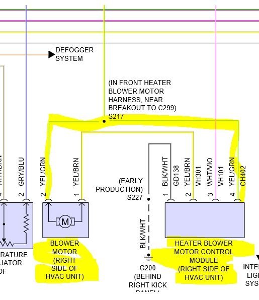

The front fan has stopped blowing. So after research I decided to replace the blower motor (which was actually easy). Unfortunately, the new blower motor is not working either.
What else could it be?
Jul 10, 2018 at 3:57 AM
AL514
  • 5,668 POSTS

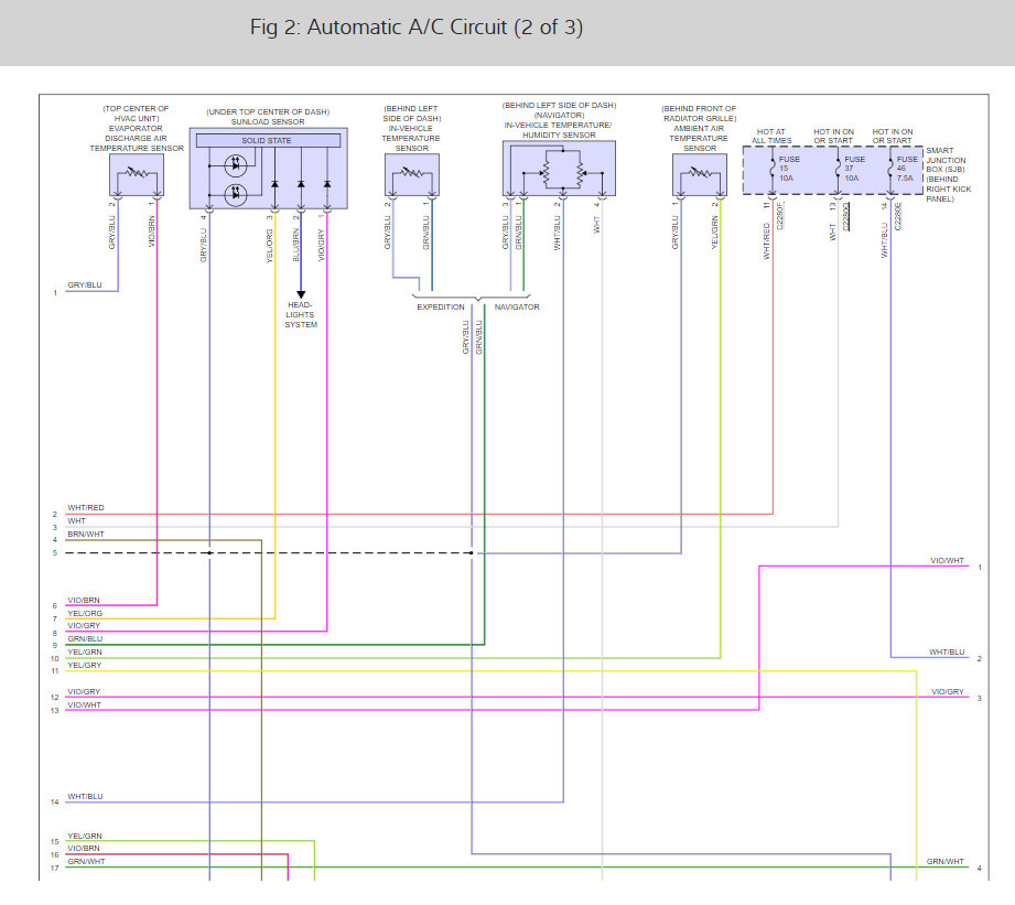

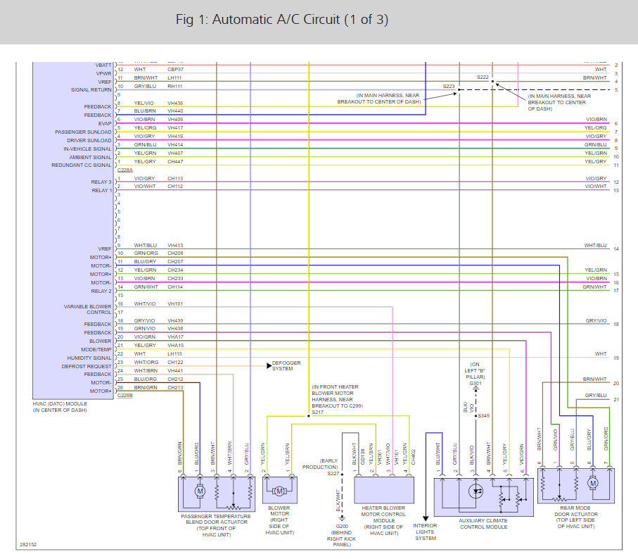

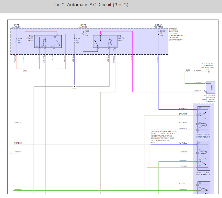

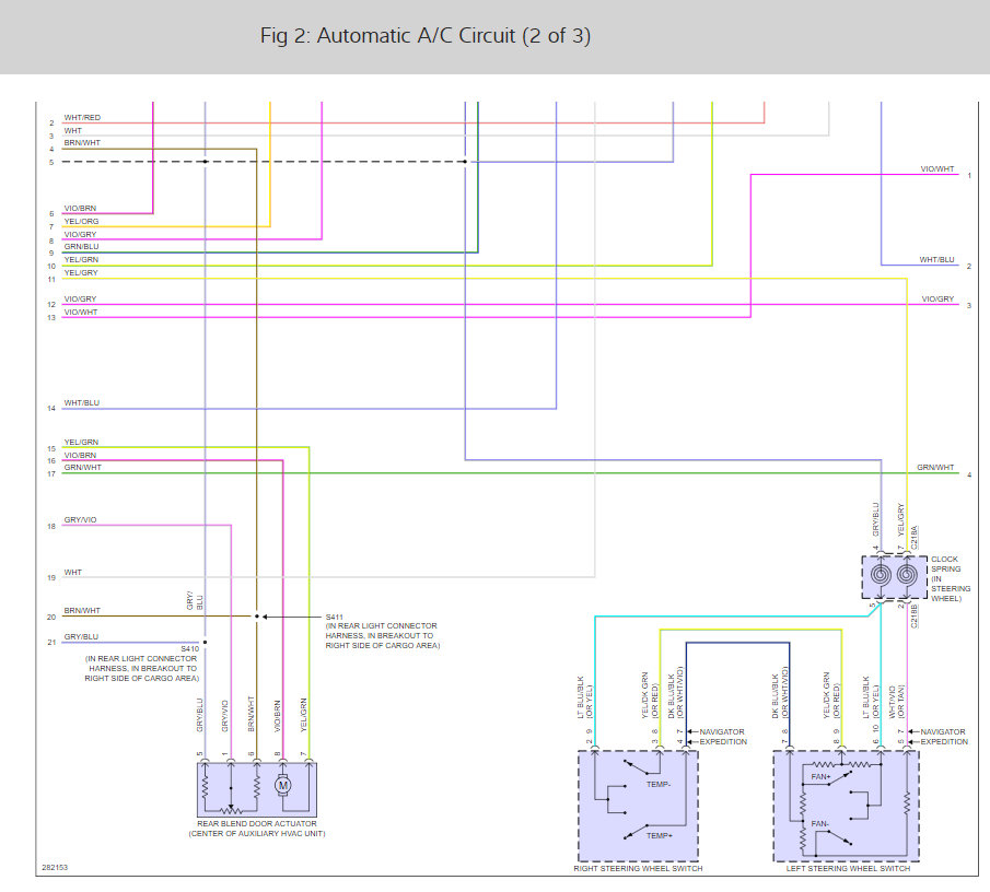

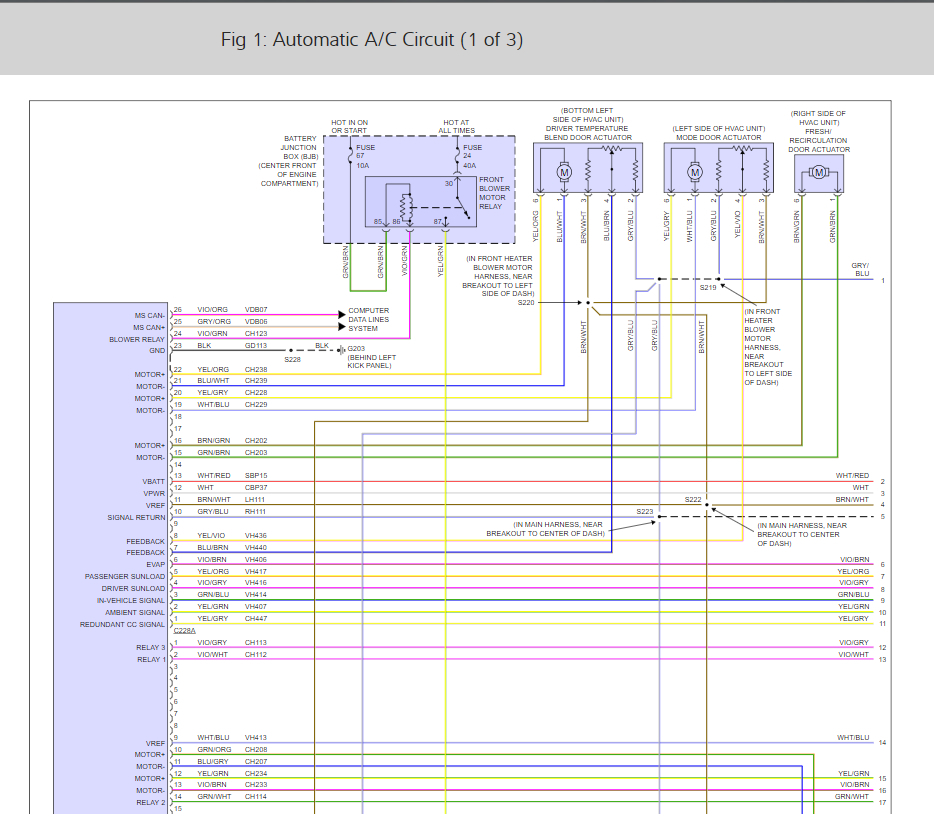

Hello there, sounds like the module that controls the blower might be bad. There are a few electrical checks you can do to find out if there is power at the blower motor itself. Here are a couple of wiring diagrams to guide you through it:

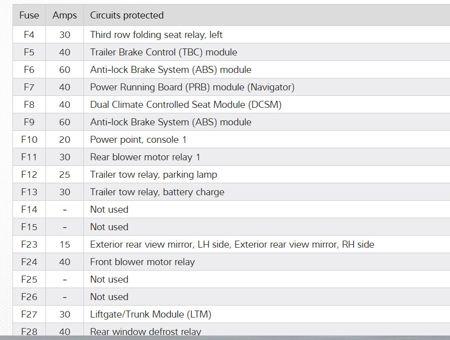

So I will Check:
*Fuse 24.
*Blower motor plug (just to make sure that my old blower motor and new blower motor were both duds. I am guessing that it will show that there is no power going to the plug).

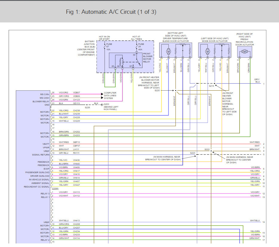

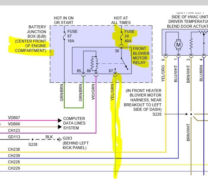

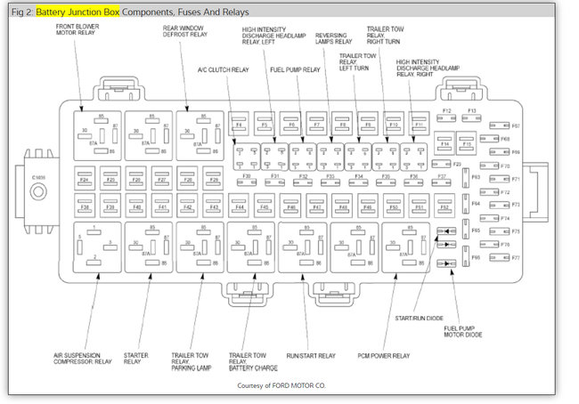

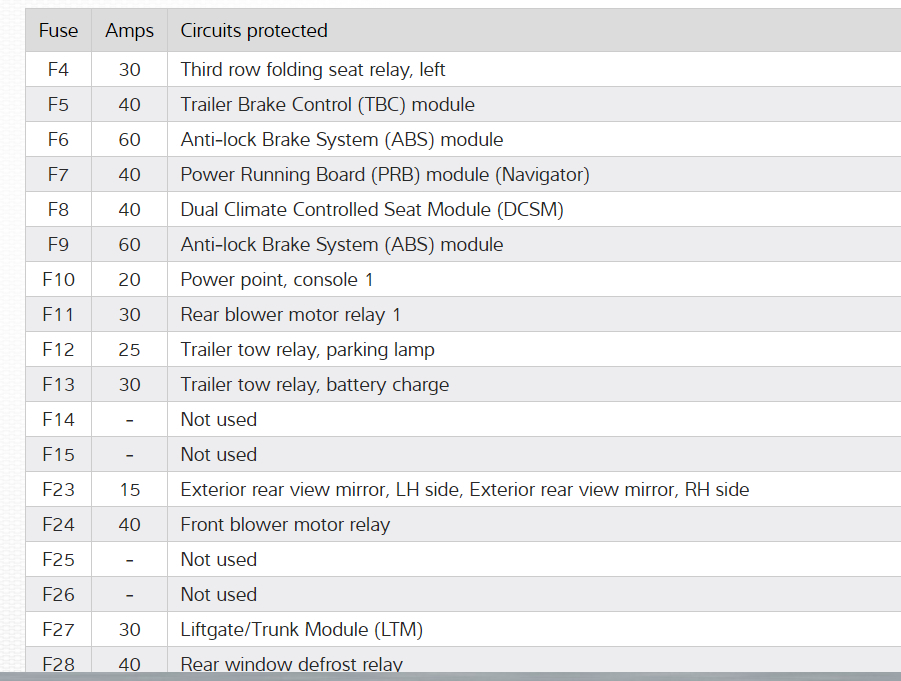

There is a blower motor relay that needs to be checked. Here is the guide and the location of the relay along with the wiring diagrams for the system so you can see hows it works:

Thanks for follow back. So the blower motor was not the solution. I did replace the blower resistor two years ago. So I did not think it was that. The guy at the parts store suggested to check it since it was a warranty part. Gave me a new one. Solution: Put the resister in five minute fix and the fan was up and running again. So the fan can go completely out and the resister can be the culprit it.
