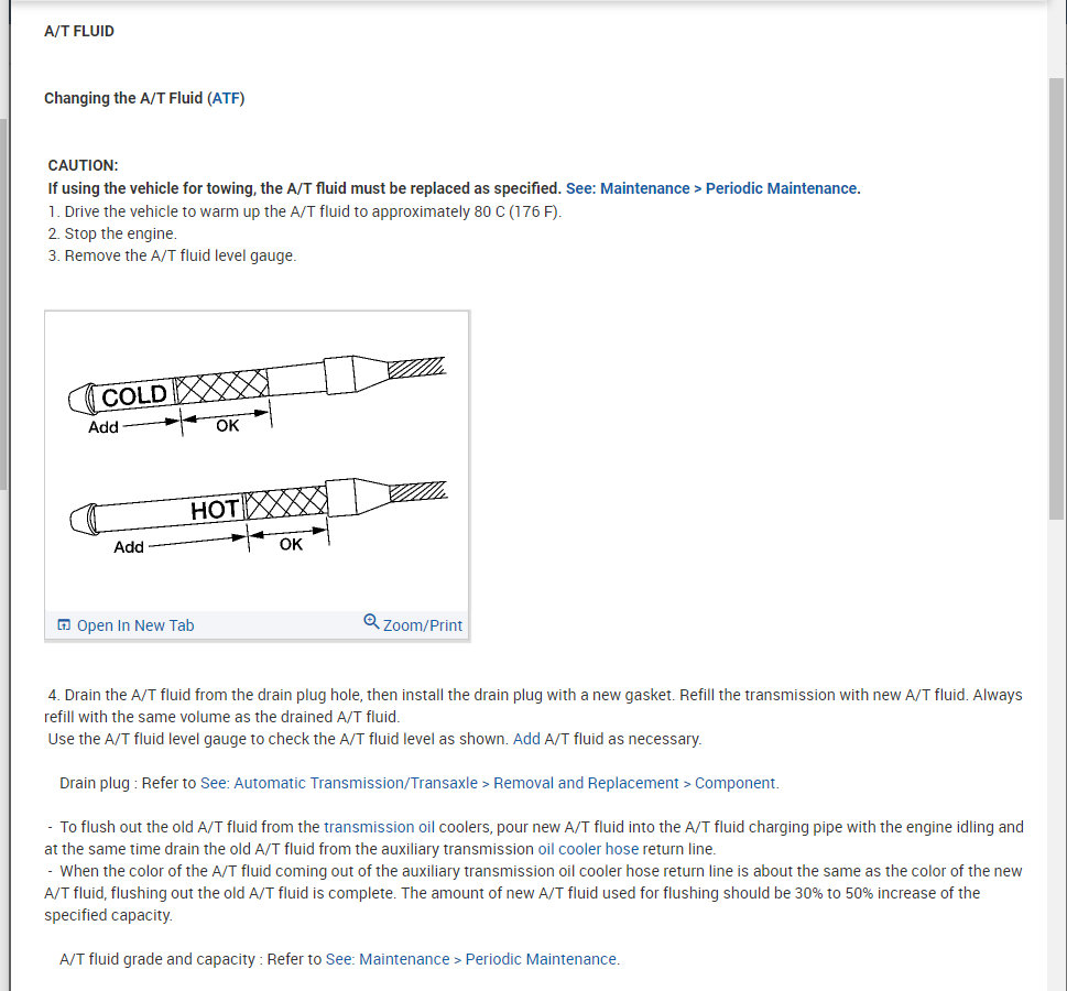

When driving above 15 mph a rubbing noise begins coming from the transmission. The noise started about 2-3 weeks ago and has gotten louder. So I want to do a service can you help me please?
Dec 21, 2019 at 5:40 AM

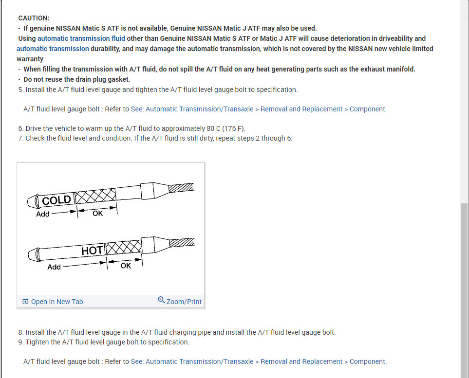

This does sound like a slipping clutch so servicing the unit may solve it but if not we are going to have to disassemble the unit and rebuild it or replace it.
Here is a guide that will help with servicing the unit by giving step by step instructions:
Below is the process from the manual on how to replace the fluid so let's run through this material and retest the issue.
Please let us know what you find with this. Thanks
