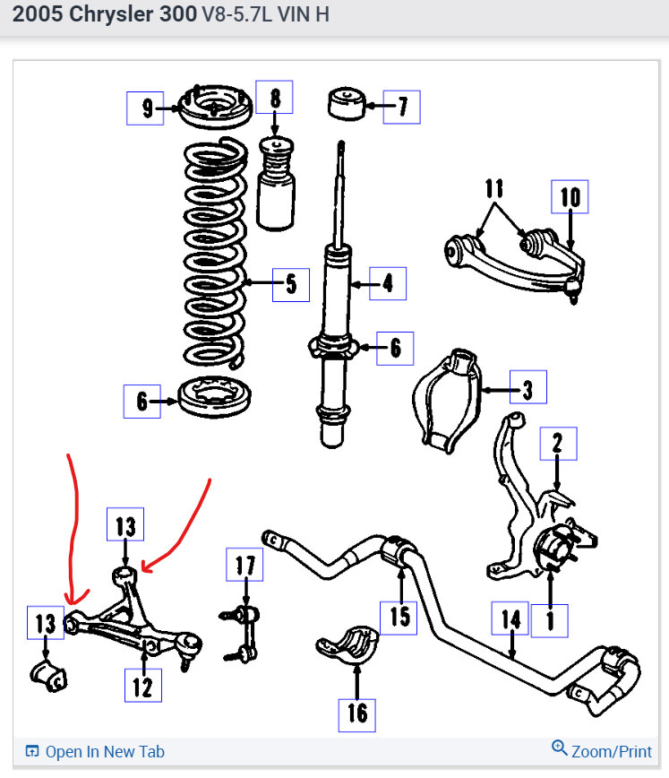

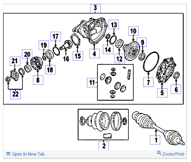

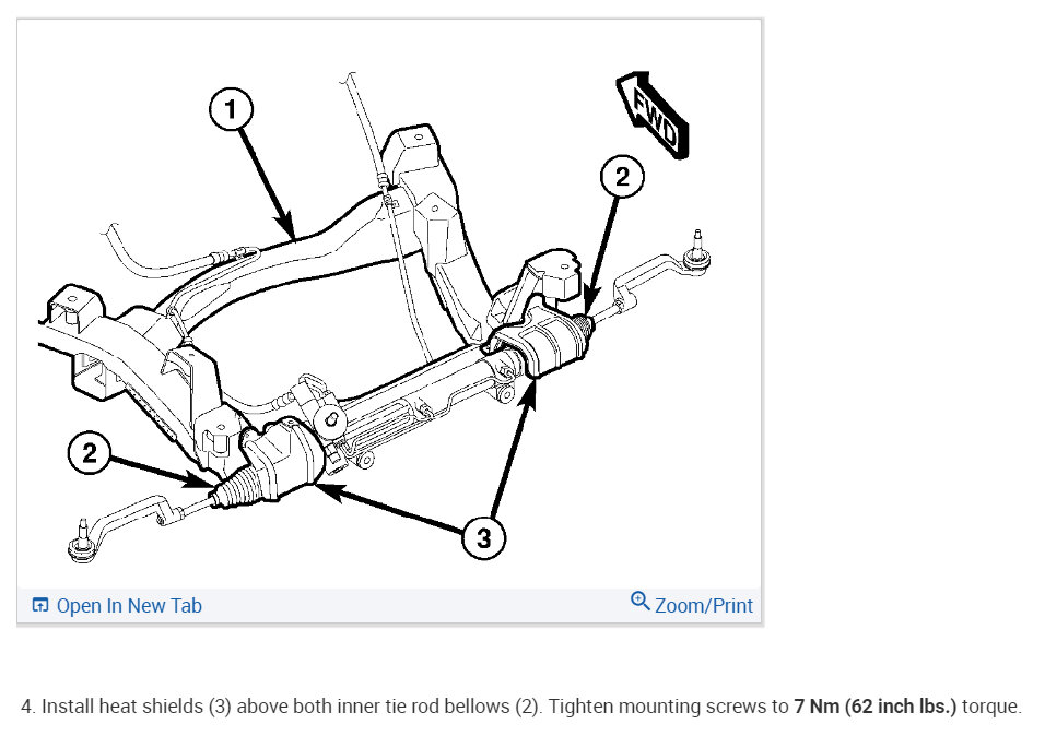

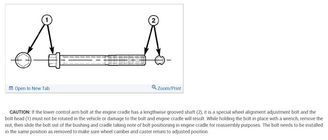

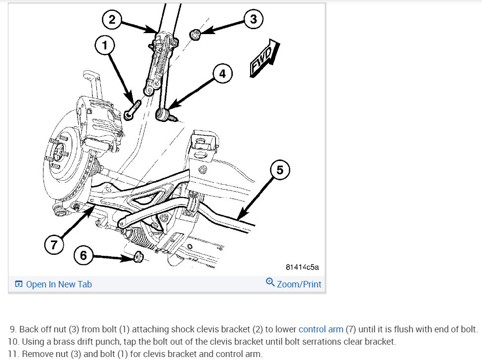

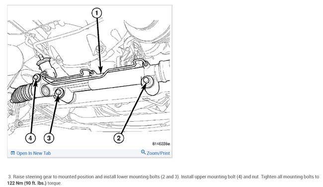

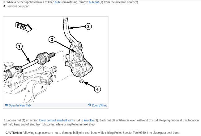

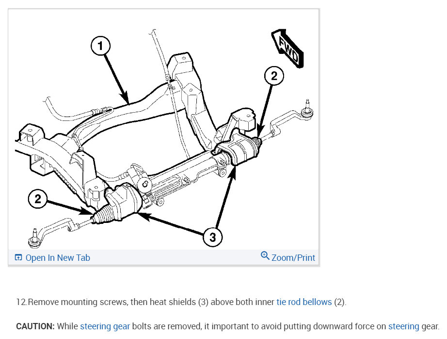

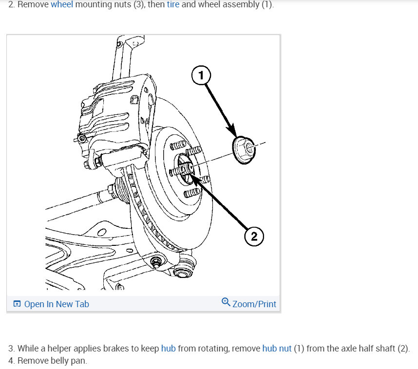

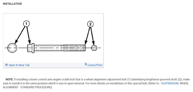

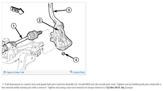

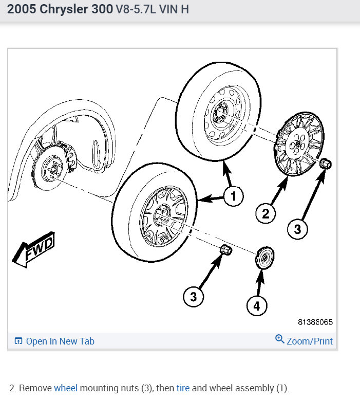

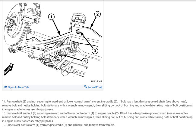

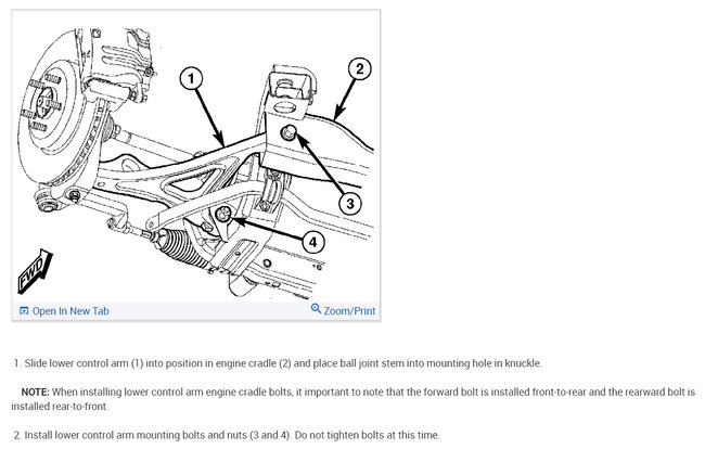

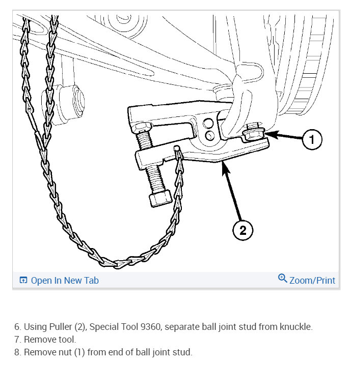

The most common CV failure problem will be the worn suspension parts, I would replace the lower control arms which must be moving in excess. You can check them by inspecting the bushing using a flashlight. If they seem okay, you may have a defective CV axle the second time. Also, please check the lower control arm frame mounts and look around for cracks in the frame. Check out the images (below). Let us know what happens and please upload pictures or videos of the problem so we can see what's going on.

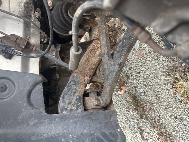

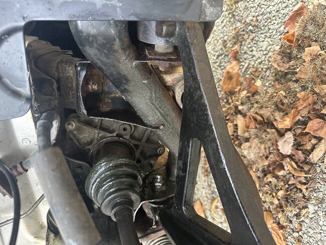

NOAH.B.111
  • 12 POSTS

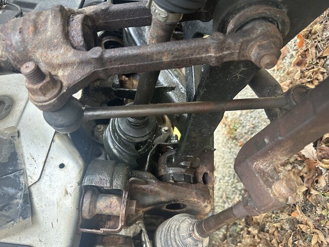

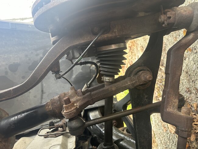

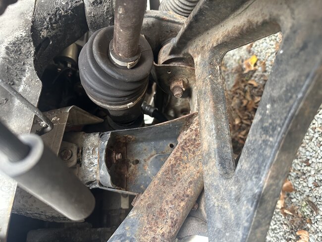

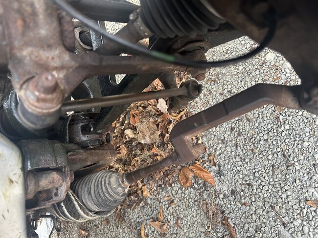

I checked out the suspension and everything seems to be okay. Maybe you notice anything in pictures that I am not seeing?
Nov 6, 2023 at 2:08 AM
NOAH.B.111
  • 12 POSTS

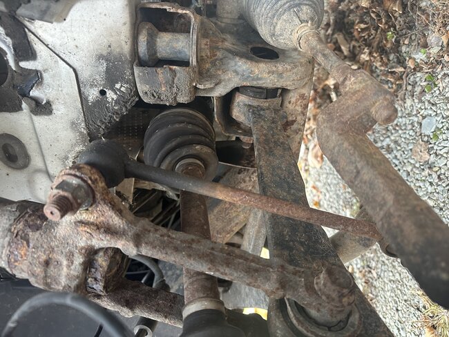

These are of the other side. I know the alignment is slightly off but wasn’t sure if that could cause this issue?
Nov 6, 2023 at 5:26 AM
  • 55,399 POSTS
Everything looks okay, thanks for the images. I would replace the CV axle which should fix it.
