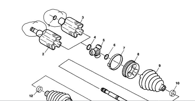

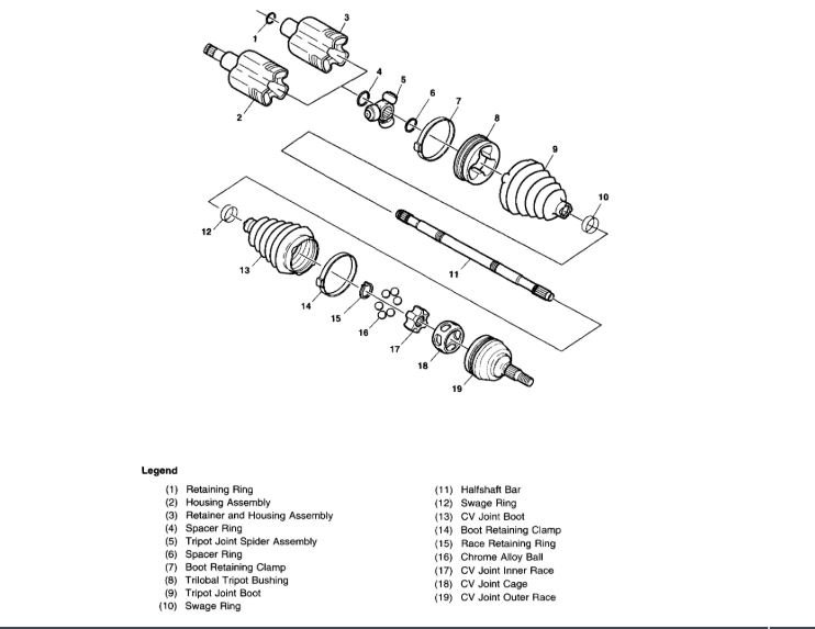

Replacing left front axle. how do you depress the clip on the output shaft?
Jul 15, 2019 at 6:42 AM
Experienced Mechanic
52,796 POSTS
Good afternoon,
The clip is not depressed for removal or installation.
You can use a large pry bar between the axle and the transmission to release the clip. It takes some pressure but it will release and slide out.
