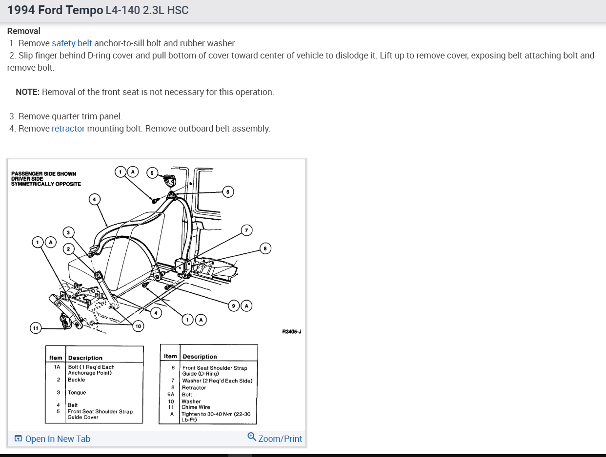

Automatic front seat belts:
1. Drivers side will not go up.
2. Passengers side will not go down.
Oct 21, 2019 at 9:31 AM
  • 54,837 POSTS

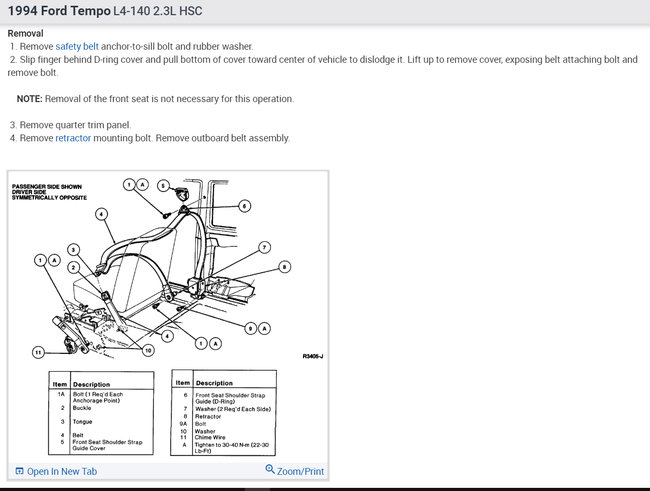

This is common when the re-tractors go out you will need to replace the units. we can't recommend opening the units up to see if they can be fixed for safety reasons. Check out the diagrams (below). Please let us know if you need anything else to get the problem fixed.
