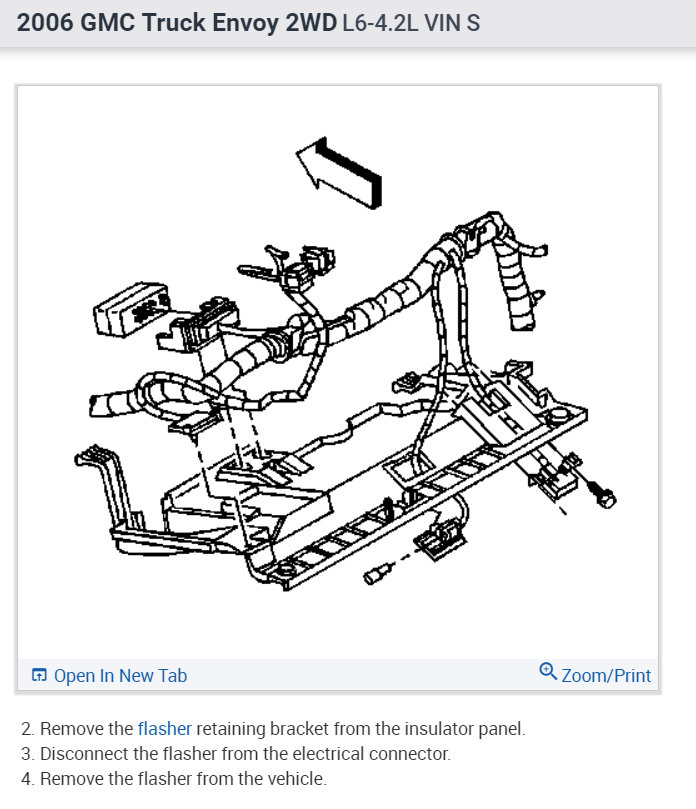

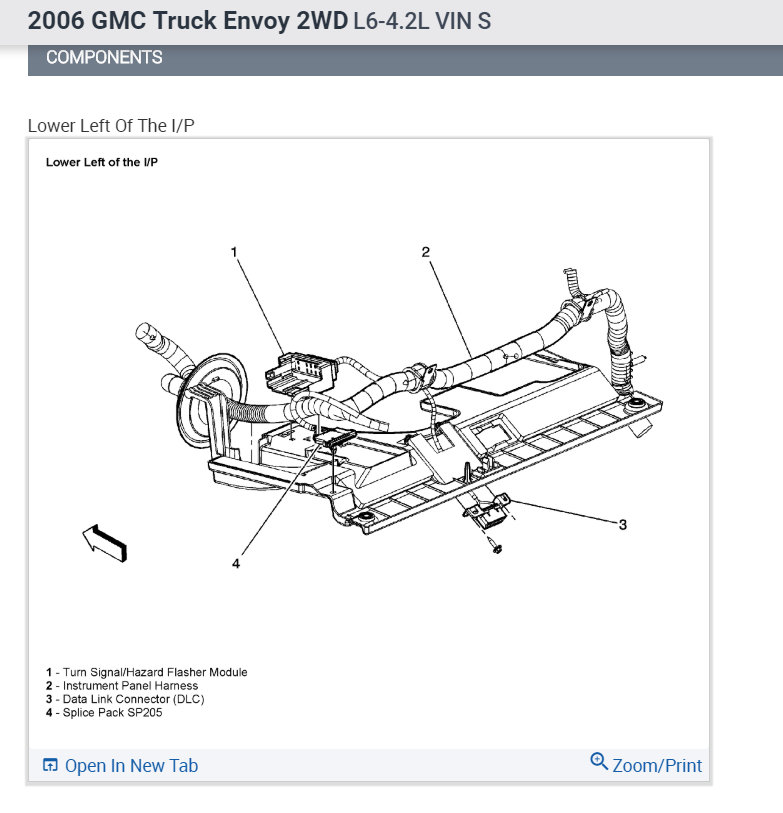

It sounds like the turn signal flasher module is not working right. here is the location as you can replace it. Check out the diagrams (below). Please let us know what you find. We are interested to see what it is.
