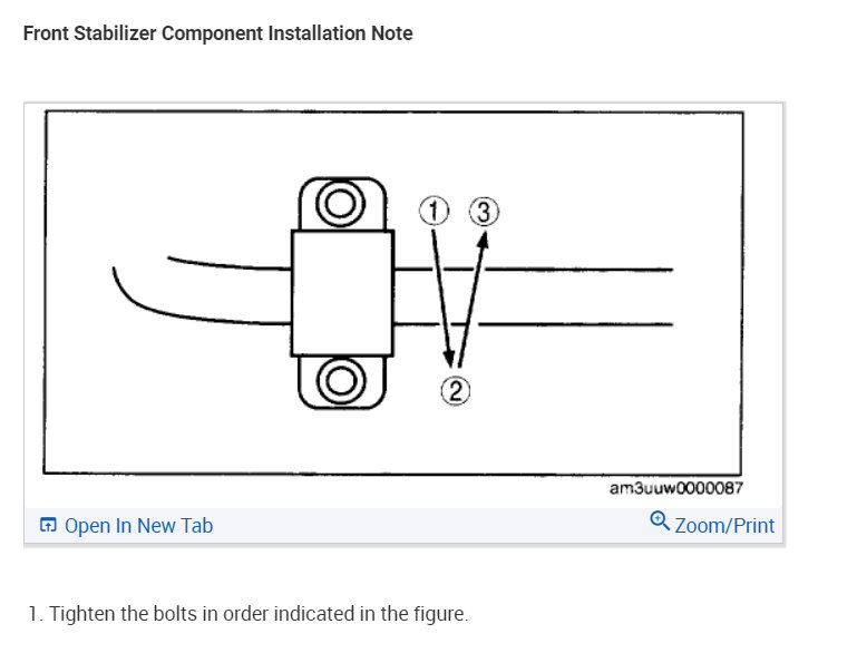

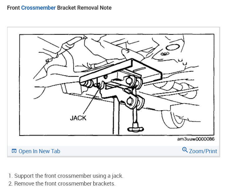

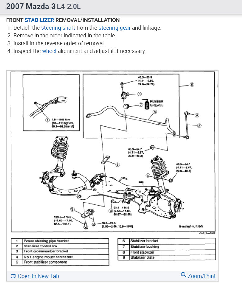

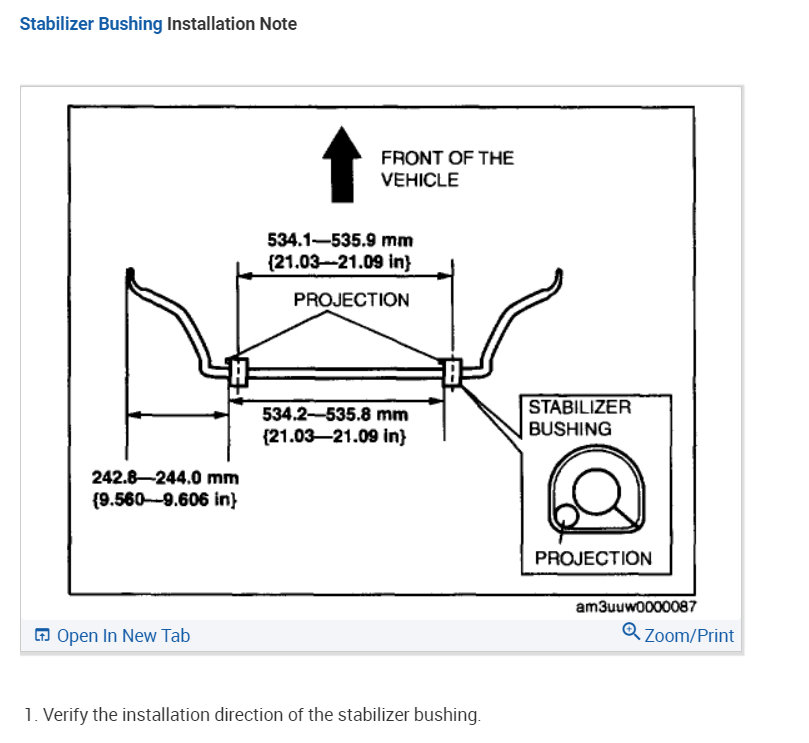

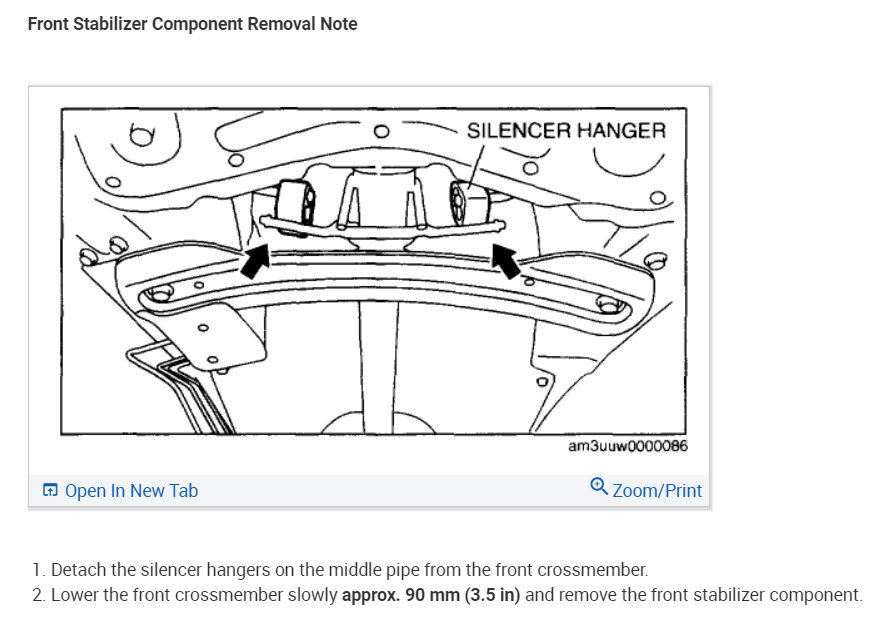

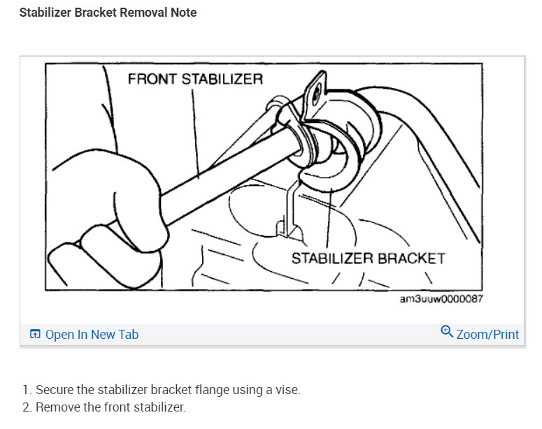

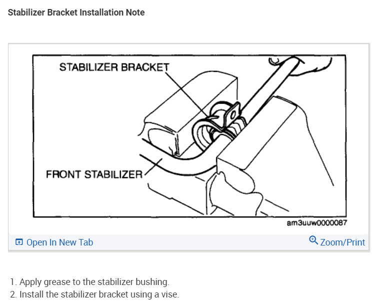

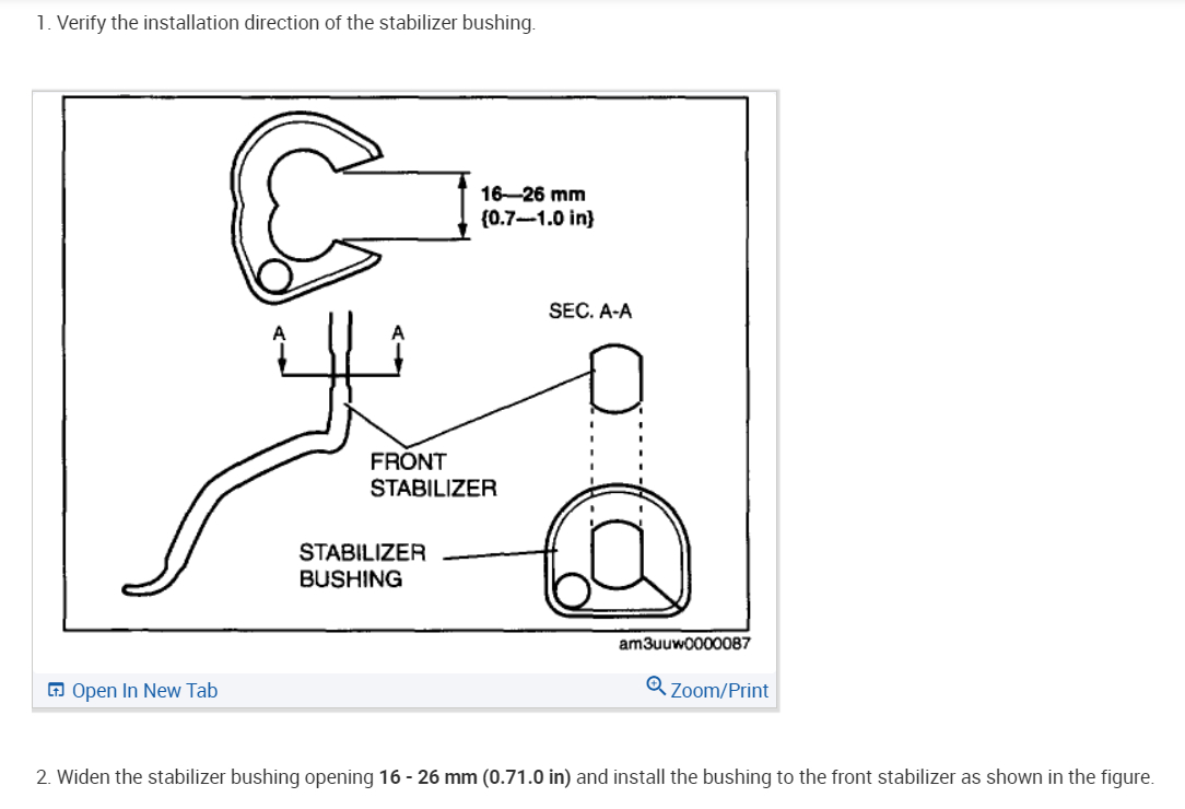

I have seen the sway bar links are main frame bushings go bad and make noise along with the fishtail you are talking about. Here is a guide to help you see what's going on. If you uploaded a short video of the noise, we can tell for sure. You can do so in your response.
https://www.2carpros.com/articles/popping-noise
and
https://www.2carpros.com/articles/how-to-replace-a-sway-bar-link
