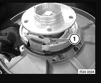

The park brake on them is a drum system mounted under the rear rotors. No special tools needed for either end. Just be careful to route the wear sensor wiring the correct way.

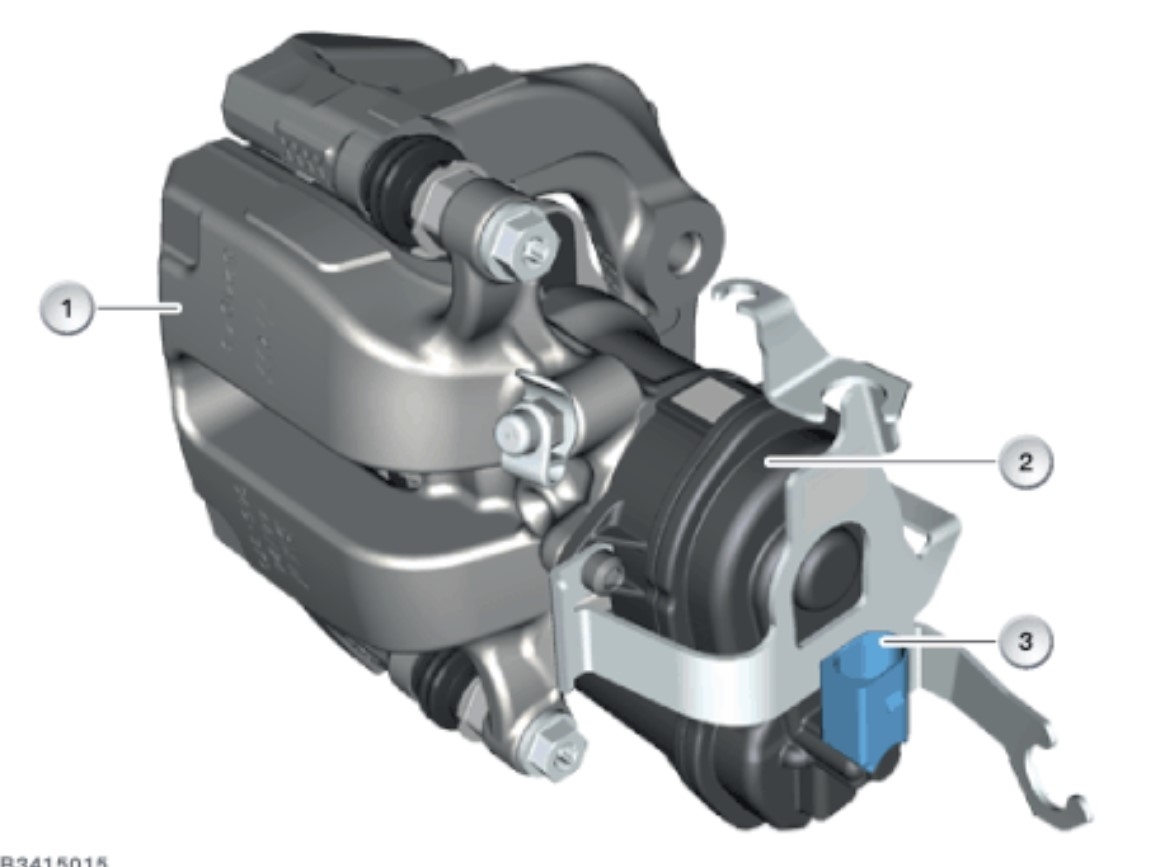

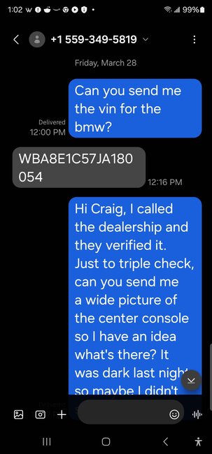

Okay, if it has the EPB button then either the service info is wrong, or you have a unique car. Could you post your VIN please. 2019 they went to the electronic park brake caliper that looks like the attached, those cannot be turned back by removing the motor though, you have to use a scan tool to put them in workshop mode. I suppose you could have a very late 2018 build that has the newer system. The VIN might help with that.
Mar 28, 2025 at 5:45 AM
STEVE W.
  • 15,345 POSTS
Looking at the VIN here shows the same. Hat style park brake with a set of shoes under the rotor actuated by a lever inside the car. As such you shouldn't need anything special, just a way to compress the pistons, basically this same process on both ends.
If you want to take a picture of the console and that button and post it, we might be able to tell what it is. Being you have cable actuated parking brakes it's possible that someone added one of the powered units like GM used to replace the lever.
