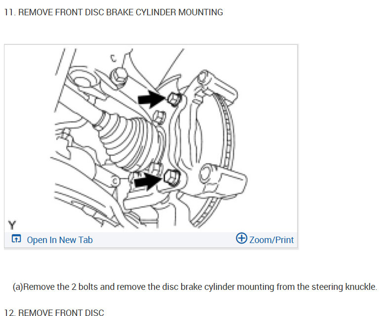

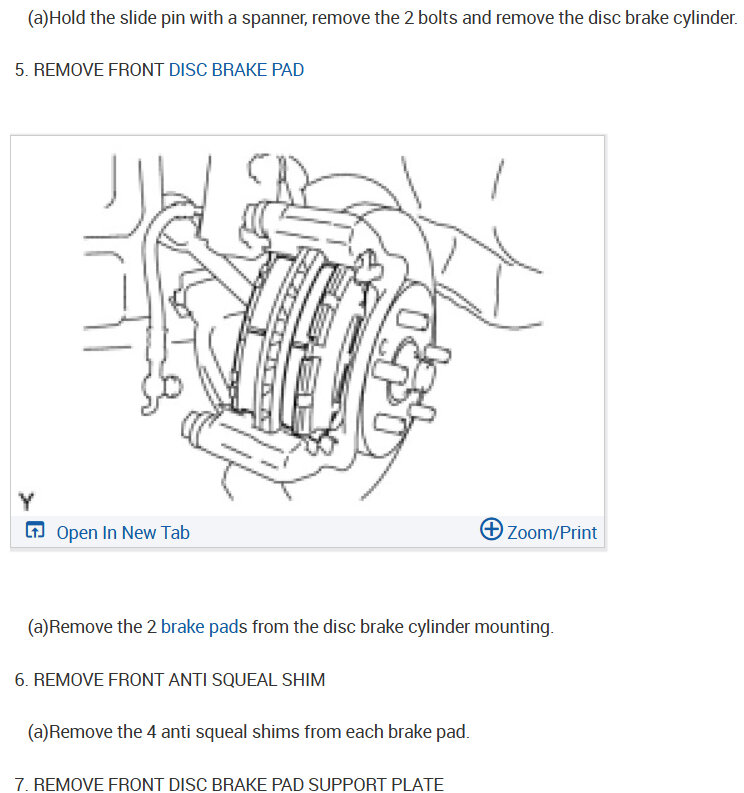

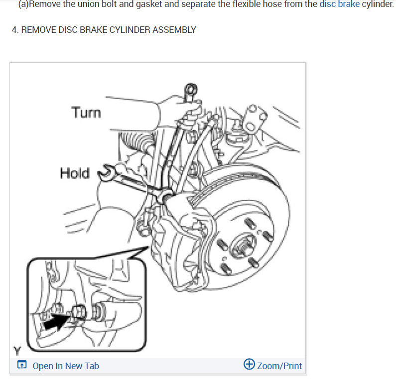

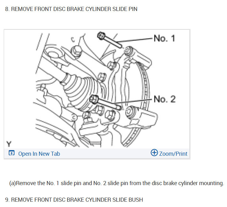

Greetings,
I am preparing to do a front and rear brake job on the vehicle listed above with front and rear disc brakes. Can I please get the procedures, diagrams, exploded views, and torque specs for completing this task?
Thank you
Apr 12, 2025 at 1:55 PM
  • 55,851 POSTS
Please start a new thread for the rear brakes, this post will be for the front brakes. We only handle one request at a time.
Start by removing the master brake cylinder dust cap, then use a large standard screwdriver to push the brake pads back, only replace the brake pads/rotor one side at a time.
Here is a video to show you how with toque specs:
https://www.youtube.com/watch?v=VtqeB0qgrTs
Let us know if you need anything else.
Apr 13, 2025 at 5:42 AM
SIXTY6GTO
  • 95 POSTS
video is for an XD?
Apr 14, 2025 at 12:55 PM
  • 55,851 POSTS
Correct, the job is very similar. Check out the images (below). Let us know if you need anything else.
