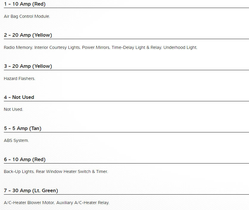

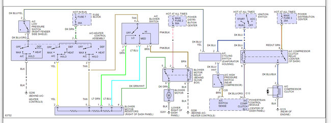

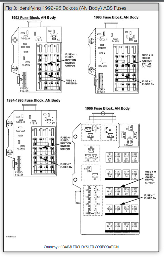

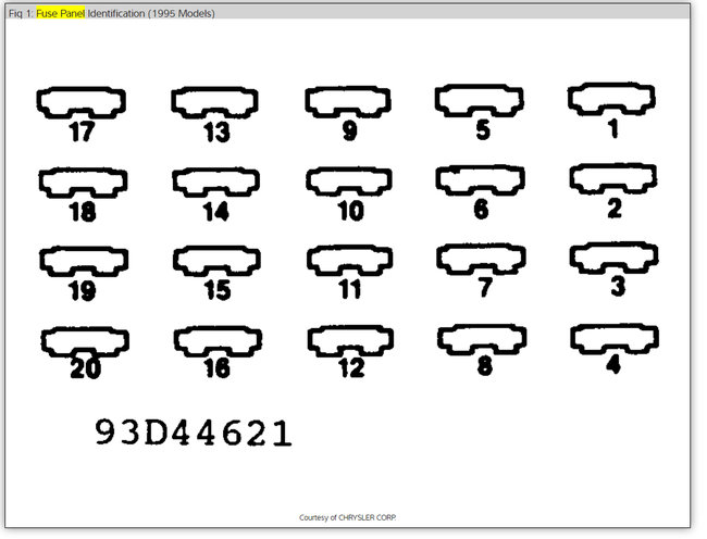

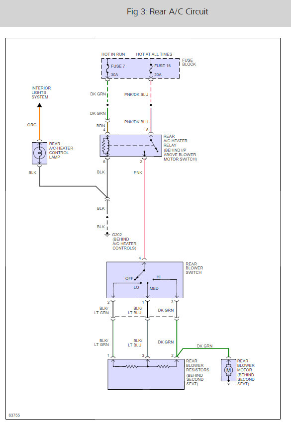

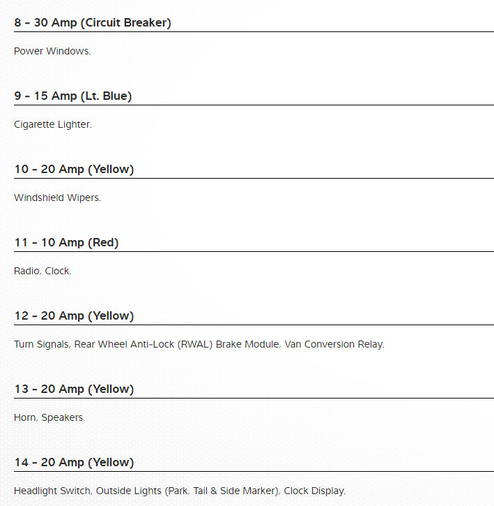

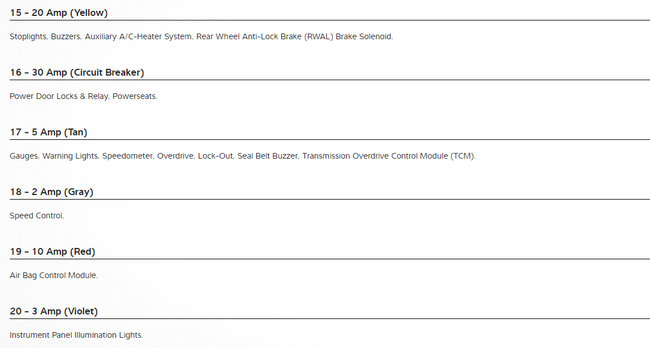

It looks like they share fuse #15 20 amp I would start by checking that first.
Here are some guides and diagrams so you can do some testing so we can get it fixed:
and
Please run this test and get back to us so we can keep helping you.

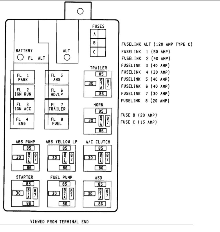

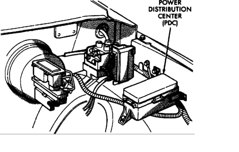

I have the location of the air conditioner relay and the PDC (below)
Please let us know what you find. I'm interested to see what it is.
