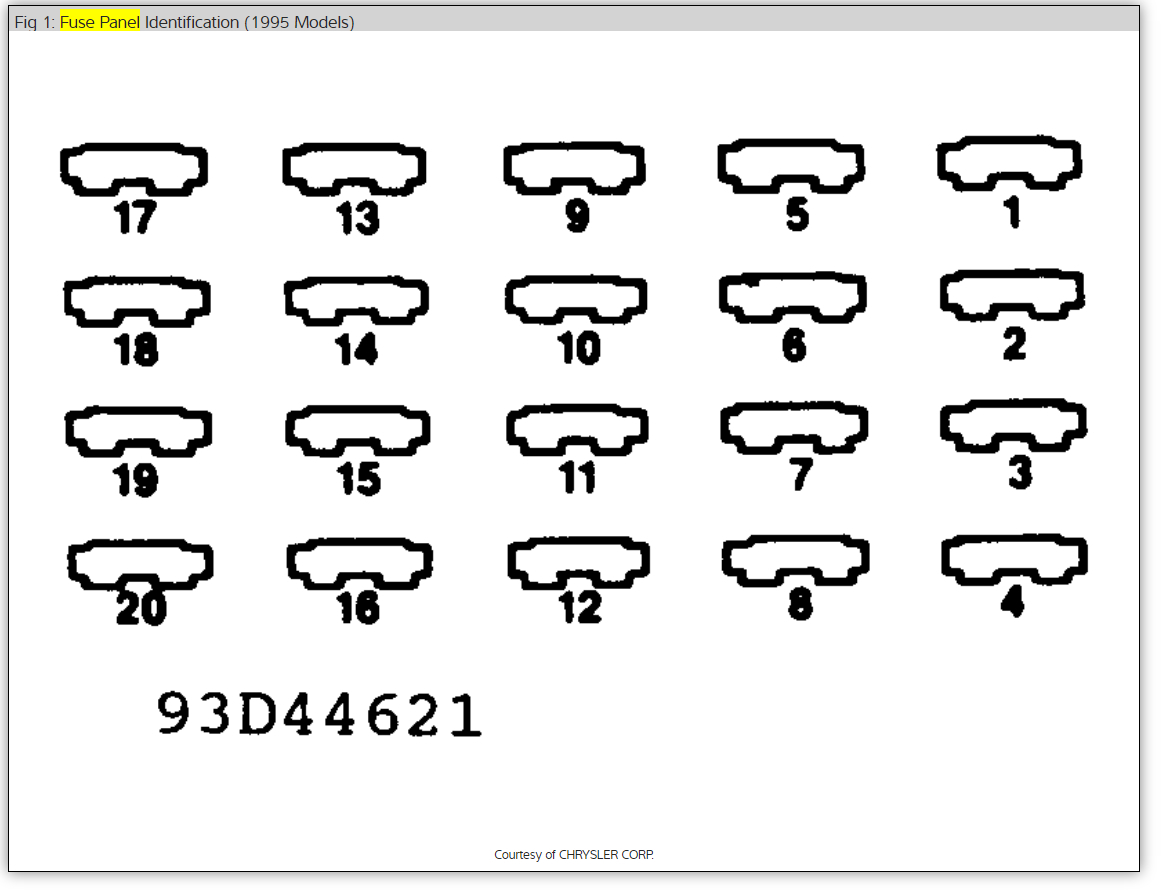

My van is a B150. Both front and rear AC stopped blowing at the same time. I changed the fuse and it did not resolve it. Is there a blower motor for both units? If so would the fact that both units stopped blowing simultaneously be an indicator that it is not motor related?
Sep 27, 2017 at 1:16 PM
  • 55,433 POSTS

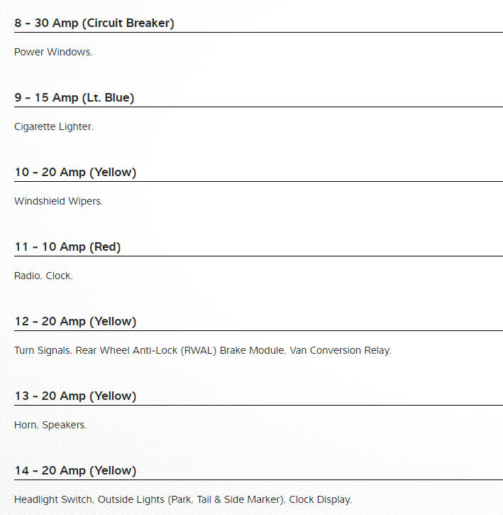

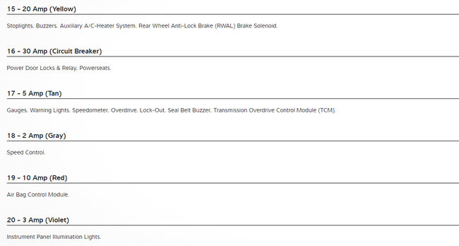

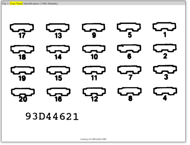

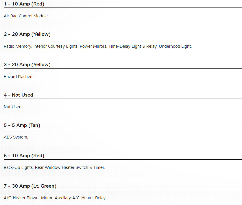

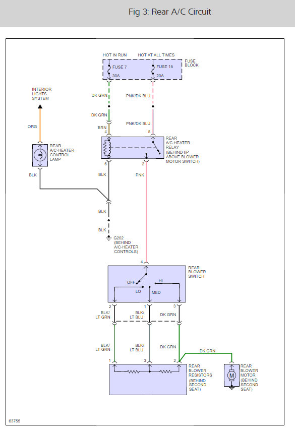

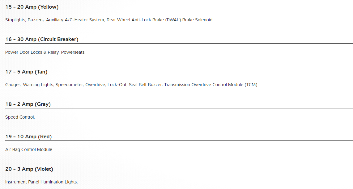

It looks like they share fuse #15 20 amp I would start by checking that first.

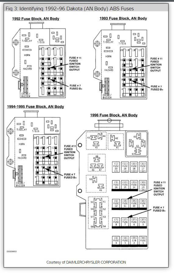

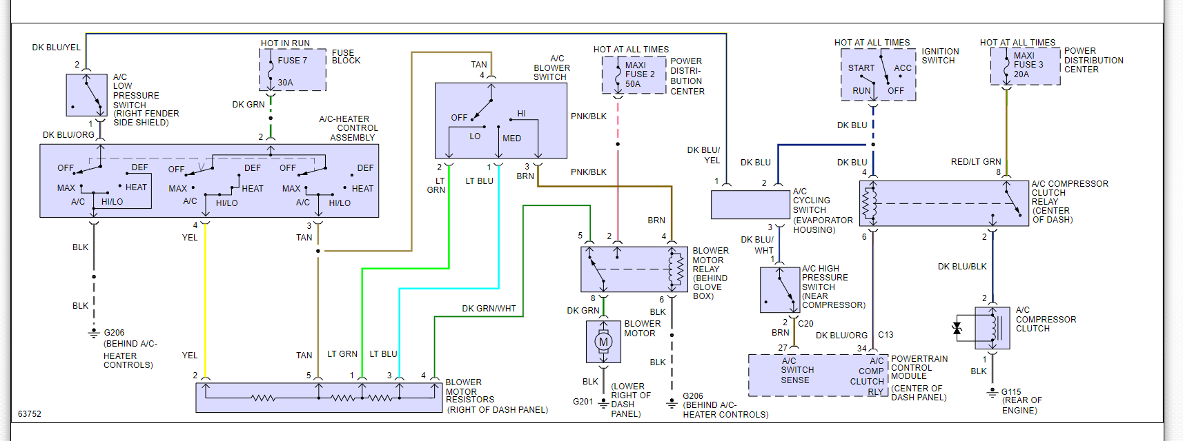

Here are some guides and diagrams so you can do some testing so we can get it fixed:
and
Please run this test and get back to us so we can keep helping you.

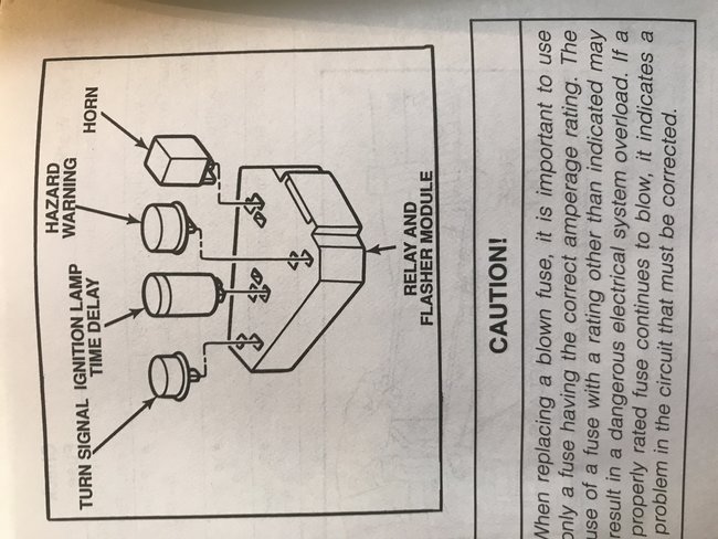

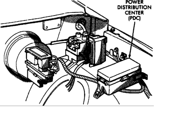

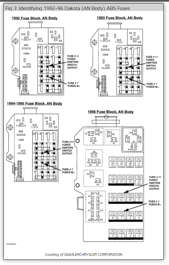

I tested all of the fuses and they all check out. The user manual does not show the location of the AC relay and doesn't show where the PDC is. I will keep investigating and keep you posted.
Oct 9, 2017 at 7:01 AM
  • 55,433 POSTS

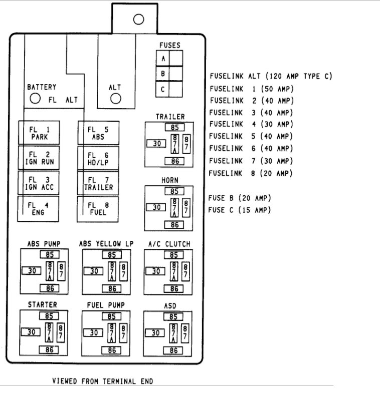

I have the location of the air conditioner relay and the PDC (below)
Please let us know what you find. I'm interested to see what it is.
