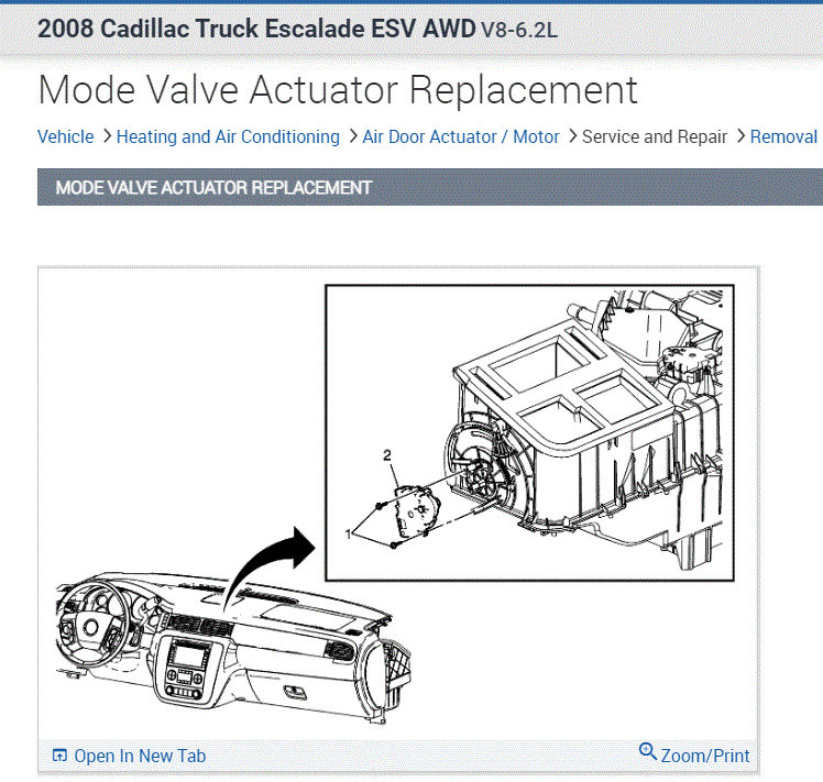

Front air vents not blow air
2008 CADILLAC ESCALADE ESV
231,000 MILES
CROB26
Air quit blowing our front vents, but rear vents blow our air.
May 11, 2022 at 4:25 PM
  • 110,194 POSTS

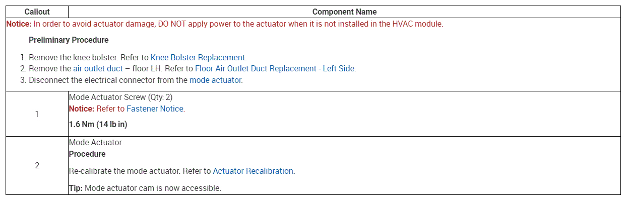

The air flow direction is controlled by the mode door actuator. If you can't get the air flow to come from the vents, there is a chance the actuator itself is bad.
I attached the directions for replacing the actuator below. However, what I suggest is to inspect the actuator first. Make sure it's tight. Once removed, see if it responds when you select vent.
Try this and let me know the results. Also, let me know if you have questions, let me know.
