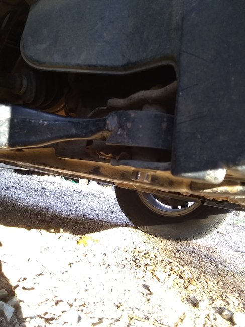

Front A frame bolt
2002 HONDA CRV
173,000 MILES • 2.4L • 4 CYL • 4WD • AUTOMATIC
TARTENAAR05
How do I get the bolt out of the front A frame? I cannot get it loosened up.
Dec 7, 2019 at 4:15 AM
TARTENAAR05
That's the front A frame bolt.
Dec 7, 2019 at 4:25 AM
If it is just spinning but not coming loose then there is most likely a nut on the top that is supposed to be welded or held in place that has broken loose. You are going to have to access it and hold it with a wrench or vice grips. If it will not break loose, how are you trying to loosen it? Are you using an air impact wrench? If not, you may need one that will break the rust loose and free the bolt. Last resort, you will need a torch and heat the bolt to expand the metal so it can break free.
Dec 7, 2019 at 12:32 PM
TARTENAAR05
It has a flat plate with threads.
Dec 7, 2019 at 1:37 PM
So its just spinning when you loosen it? Are you using an impact? If so, just heat and then give short fast bursts with the impact to see if it will catch and loosen up. If I am missing something let me know.
