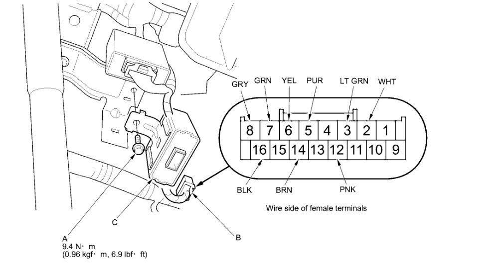

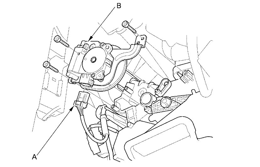

Yes, it could be a mode door actuator. I will attach the procedure and a picture.
Front Mode Control Motor Replacement
Removal
NOTE: Set the HVAC control to the VENT position before removing the motor.
imageZoom/Print
1. Remove the headlight leveling control unit See: Headlamp Alignment Control Module > Component Tests and General Diagnostics > Headlight Leveling Control Unit Input Test/Replacement.
2. Disconnect the 7P connector (A) from the front mode control motor (B), then remove the self-tapping screws and the front mode control motor from the heater unit.
