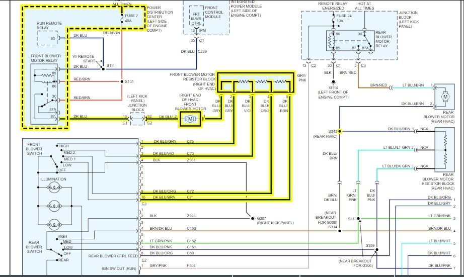

My A/C in the front used to work perfectly fine until recently the passenger would have to tap the bottom where there feet go to get it started again, well this has stopped working and no air is coming out at all though my back is I'm needing to know what to do. i have a motor blower and resistor on its way, but am wondering what it could be. And do these vehicles have 2 compressors or just 1? Any advice is appreciated.
May 3, 2020 at 3:49 PM
Good evening,
There is only one compressor for the A/C system It does both the front and rear.

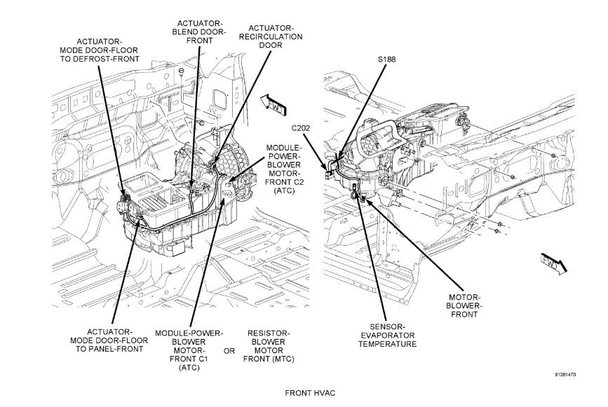

It does sound like the blower motor is bad but needs to be confirmed. You need to check for voltage to the blower motor to be sure it has power.

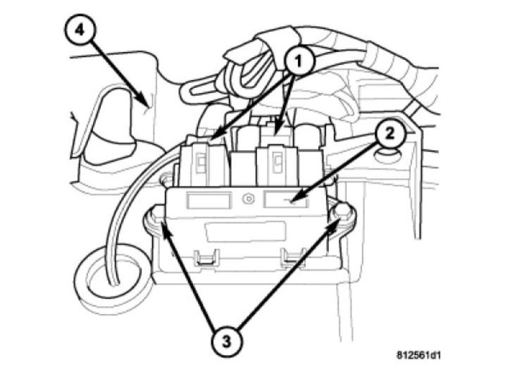

I attached a wiring diagram for you to do some checks. You can use a test light for these tests.
1. Disconnect and isolate the negative battery cable.
2. If equipped with a trim cover (2), remove the two screws (1) that secure the trim cover over the blower motor power module (3) located below the right side of the instrument panel and remove the cover.
3. Disconnect the two wire harness connectors (1) from the blower motor power module (2).
4. Remove the two screws (3) that secure the blower motor power module to the front HVAC housing (4).
5. Remove the blower motor power module from the front HVAC housing.
May 3, 2020 at 4:32 PM

Hey Roy, I am back. So, we replaced blower motor, resistor, then ground out pig tails weren't working from the controls, once we corrected this issue we have air.. bad news it's hot air in both the front and back, but the compressor is kicking in.. I'm thinking blend door actuator or expansion valve. Can you let me know what you think?

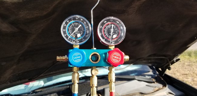

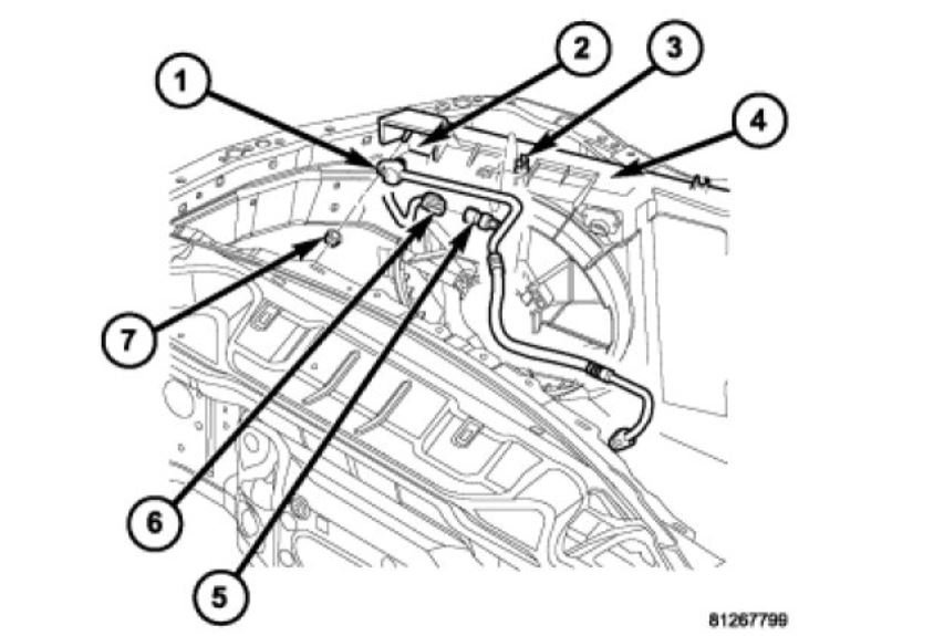

Where would i connect it? I'm heading to my auto parts store right now. What is it called? Thanks for helping me out. most the mechanics here want to charge $300.00 just to look at it and give a diagnostic, that's not fixing it or the parts.
Jun 3, 2020 at 2:17 PM

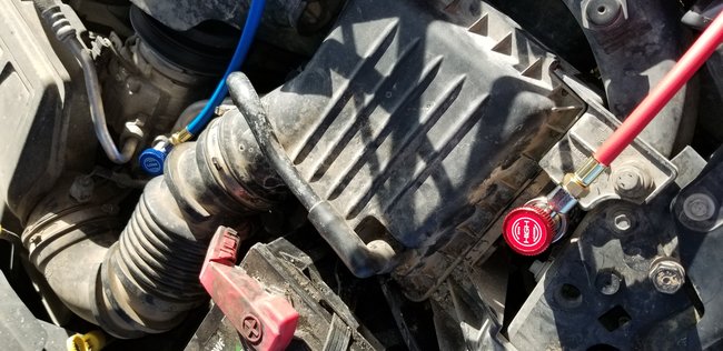

There is a port for the high side between the compressor and the condenser.
You ask for A/C gauges.
The A/C discharge line (1) is the refrigerant line that carries refrigerant from the A/C compressor to the A/C condenser (2) and is secured to the condenser fan shroud (4) by a plastic retainer (3). The A/C discharge line has an integral fitting for the A/C pressure transducer (5) See: Refrigerant Pressure Sensor / Switch, HVAC > Components > Description.
NOTE: Replacement of the refrigerant line O-ring seals and gaskets is required anytime a refrigerant line is opened. Failure to replace the rubber O-ring seals and metal gaskets could result in a refrigerant system leak.
The A/C discharge line has no serviceable parts except for the rubber O-ring seals. The O-ring seals used on the connections are made from a special type of rubber not affected by R-134a refrigerant. The O-ring seals must be replaced whenever the A/C discharge line is disconnected.
The A/C discharge line cannot be repaired and must be replaced if found to be leaking or damaged.
Jun 3, 2020 at 2:23 PM

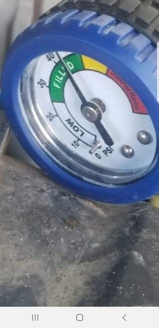

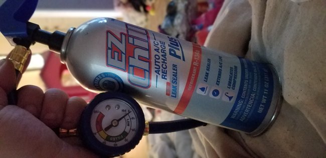

We just put Freon in today that's the picture that showed green.
Jun 3, 2020 at 5:31 PM
LMAX2014
  • 19 POSTS
Never mind just checked and it says no Freon.

So tried the Freon and the gauge went into the red zone which i would think means it's full.
Jun 3, 2020 at 6:15 PM
LMAX2014
  • 19 POSTS
Freon is full, but no pressure.
Jun 3, 2020 at 6:27 PM
Impossible. If there is no pressure then there is no Freon.

Went to put more Freon as suggested pushed the nozzle down and the gauge went to yellow, i pressed again and it went to red then down to yellow. I didn't want to press it all in there and put to much Freon because we had just put an 11 oz can in there earlier that day. Either the manifold gauge set (i ended up finding and buying, brand new) doesn't work or something is wonky
Jun 4, 2020 at 10:08 AM
Okay, the third hose attaches to the can to be added. Once you attach the can, then open both low and high side valves for the Freon to enter.
