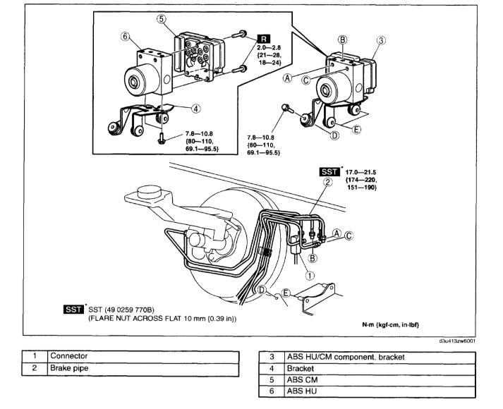

I would assume most modern cars come with ABS brakes in the front at least, but I’m not seeing any wires at the hub, but the front end has been torn apart. I have the car listed above 3i model. Is there a way to find out if this car came with ABS?

Please run down these guides and report back. If you have a yellow light on the dash that says ABS when you turn the key to on, then you have ABS option. If you have ABS, I attached a picture of the location for the control unit.

Thank you, I thought most modern or all had ABS, both Mazda 3s I have don't have it.
