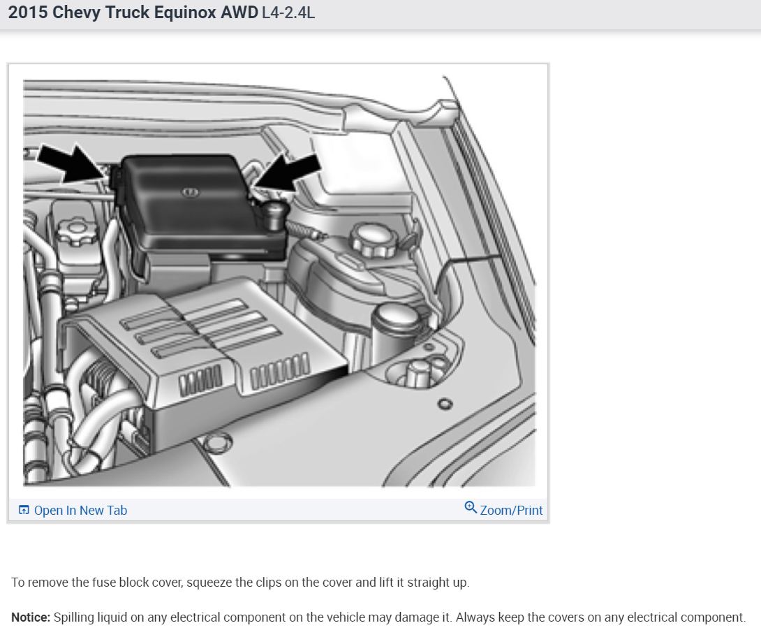

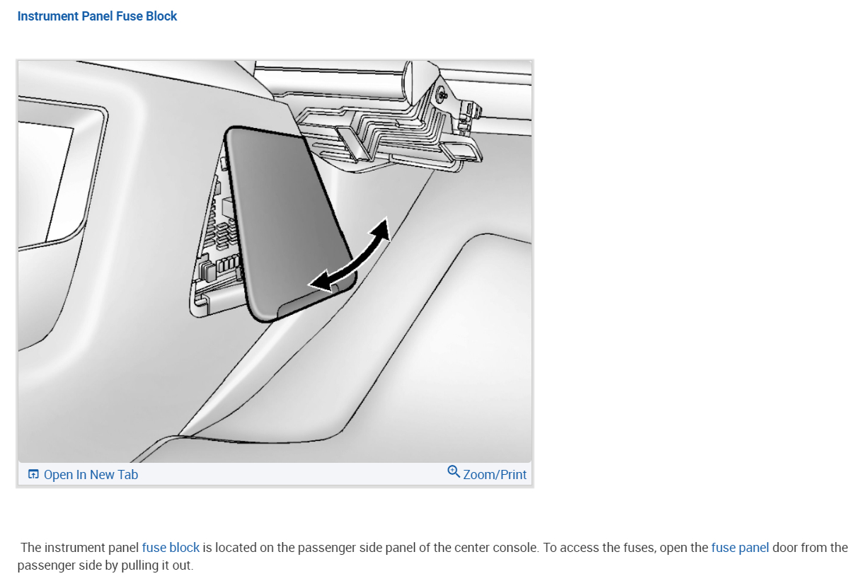

Hey GLEVI1127,

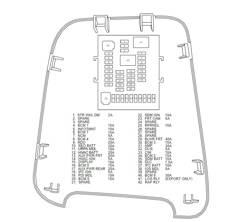

The first step will be to check all of the fuses in the under hood and interior fuse box.
There is a guide in the link below to check and replace fuses:
Start with this and let us know what you find.
It is amazing how many electrical faults can be traced back to a blown fuse.
Best of luck.
Regards, Joe

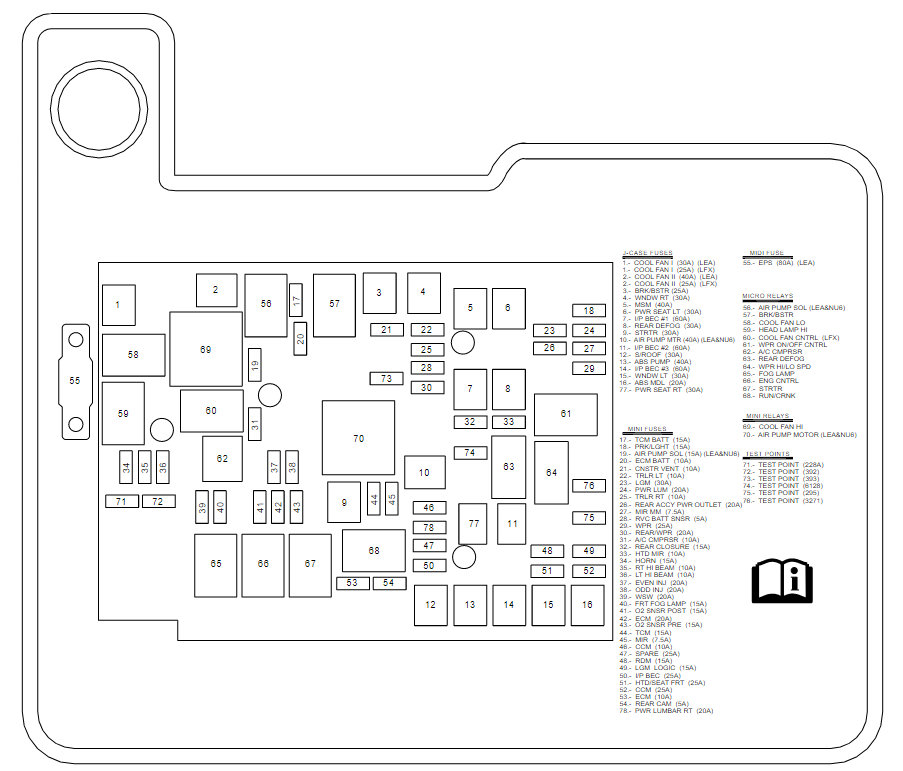

So I think I’ve found the problem I’m just not sure I’m going to do from here. It seems that the slot for the engine control relay has a full twelve volts on two of the pins and five volts on the third and .06 on the four. I am fairly certain there should only be one pin with twelve volts going to it. Correct me if I’m wrong and any advice moving forward would be much appreciated.
Feb 17, 2020 at 8:47 AM
  • 55,414 POSTS

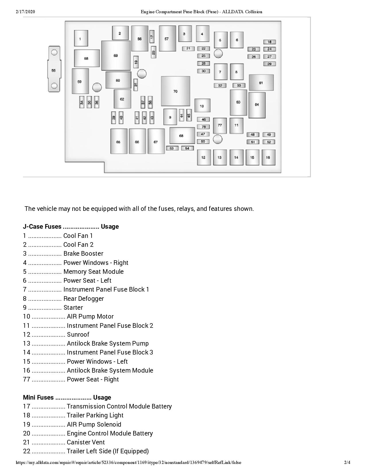

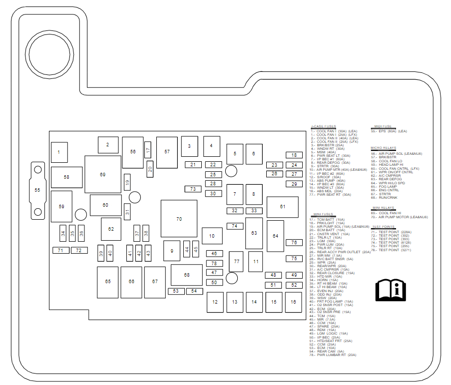

The battery voltage is low. lets confirm the battery failure using this guide. Here are the fuse locations as well so you can double check them:
Feb 17, 2020 at 11:04 AM

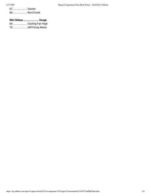

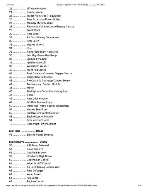

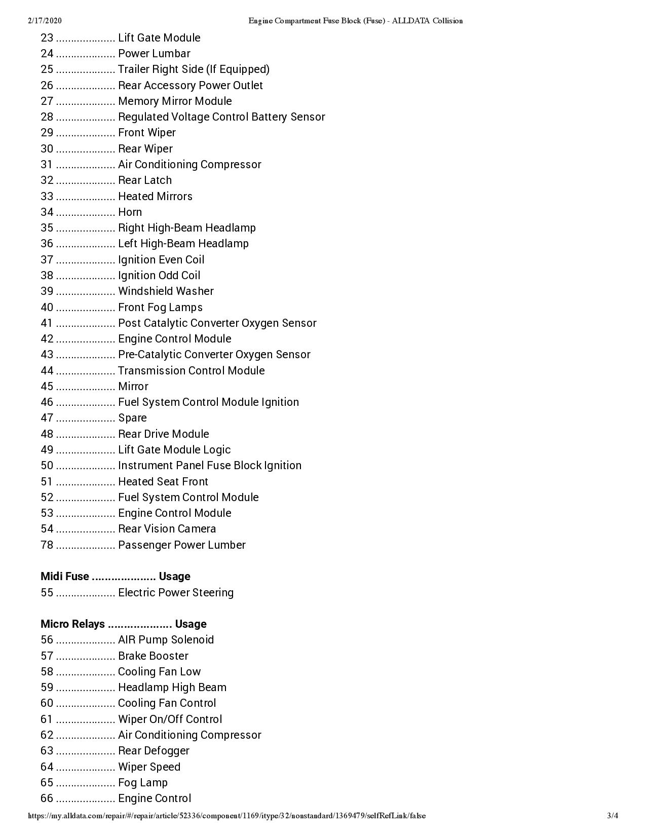

You should have 12V at either side of the ECM fuse in the under hood fuse box with the ignition on.
This will confirm that the ignition relay you are testing is operating correctly.
It is fuse 42, 20amp.
Regards, Joe
