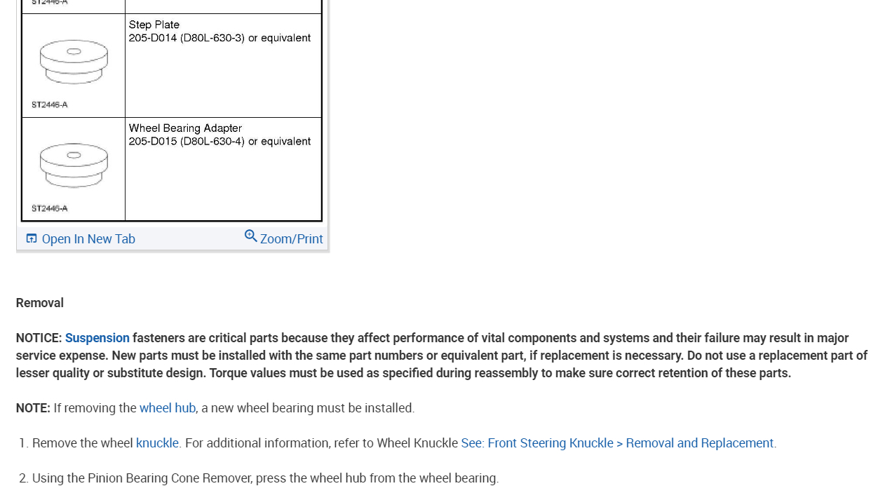

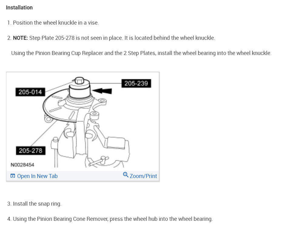

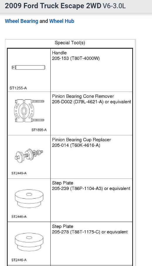

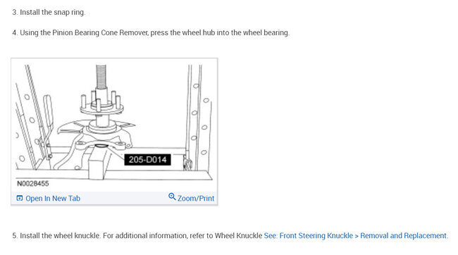

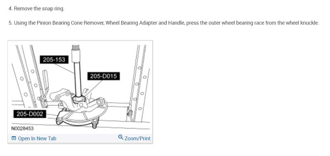

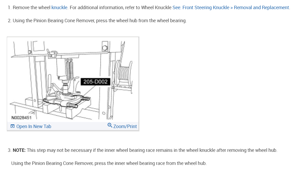

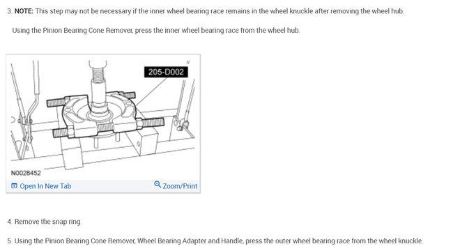

It sounds like the bearing hub has gone out. This will allow play in the wheel/rotor and create a grinding noise like you have described. You can raise the front of the vehicle and see if the left side moves if you grasp the wheel and try to move it. Here is a video on how the job is done and I have left instructions for your car:
https://youtu.be/_FzmmBoa4Tg?si=fRvS_u6rOj6mAMx3

I do also have a light grinding noise when turning right, so your answer lines up with it being a left wheel bearing or hub assembly. But only one thing why would the noise go away when i lubricated the caliper bracket and pads.
