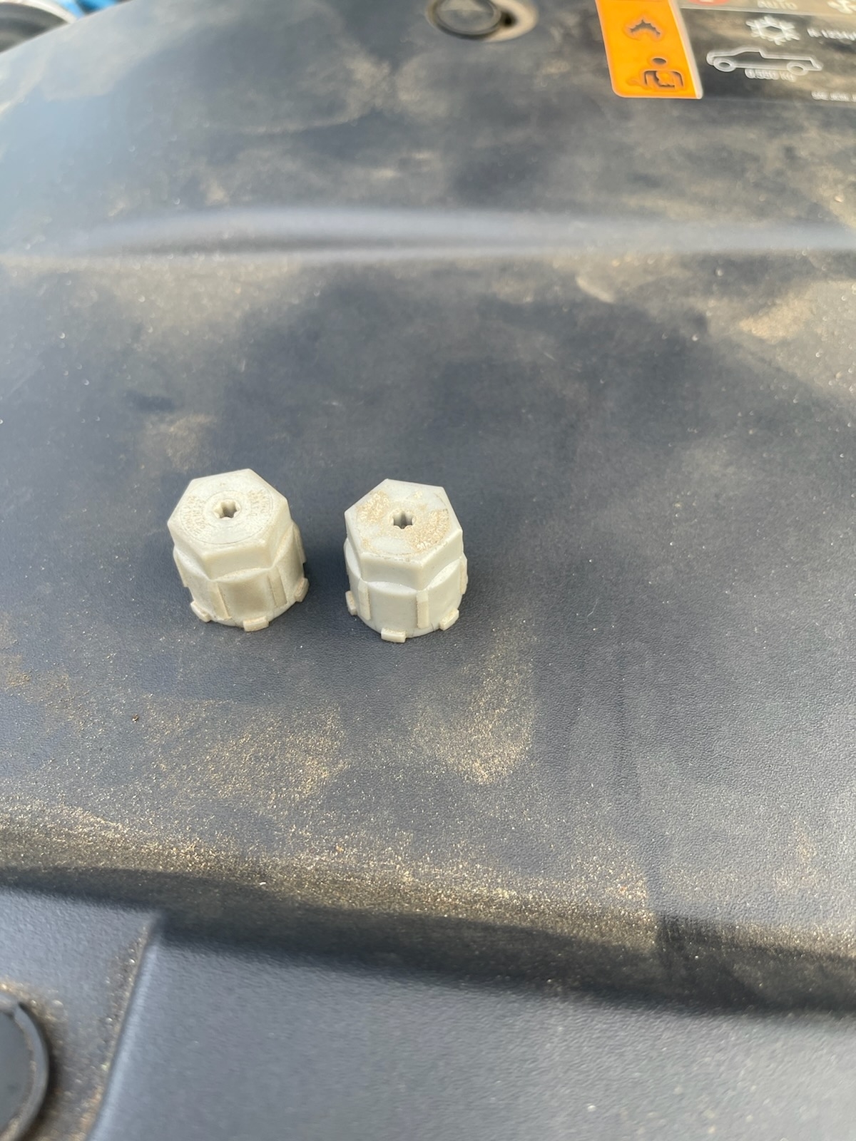

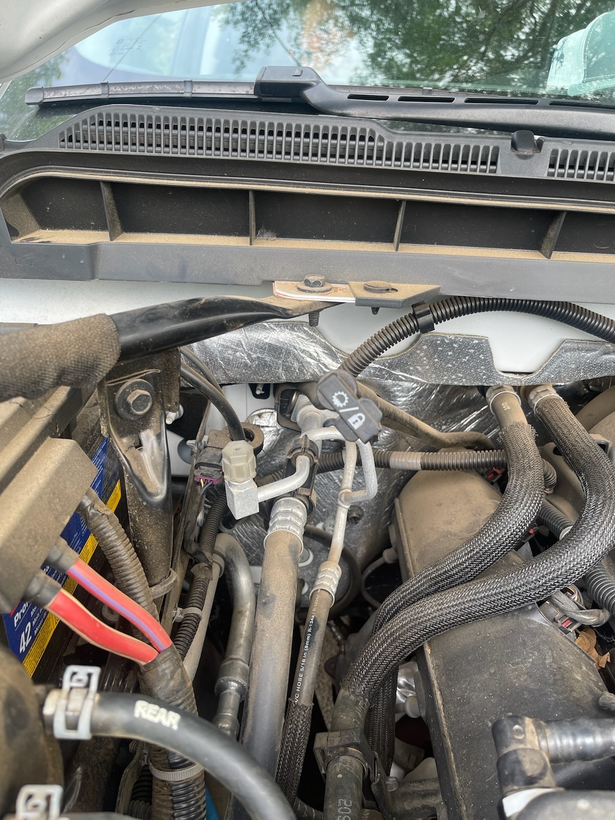

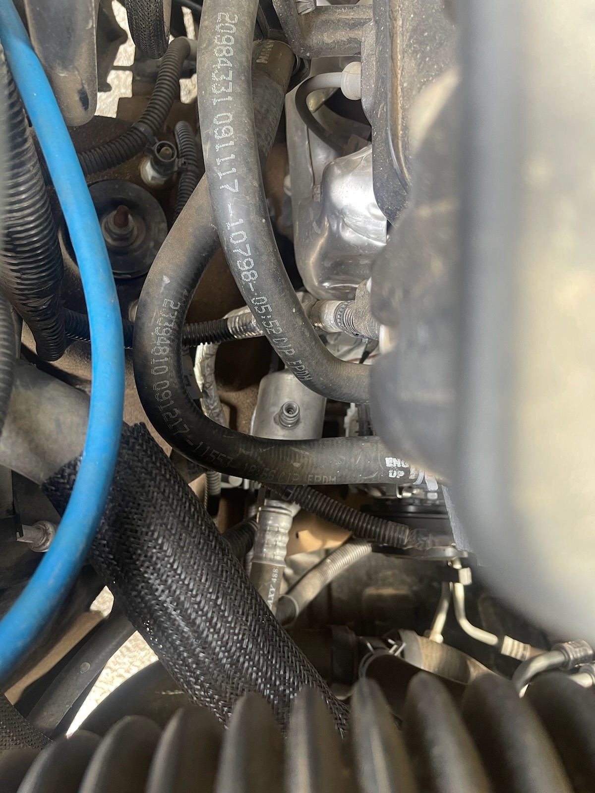

Tried to recharge my ac on my truck, but I have two high side ports. Instead of one of each. Tried looking for the low side but no luck. Any ideas?

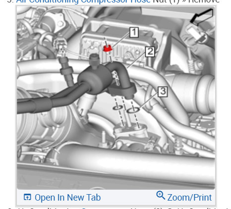

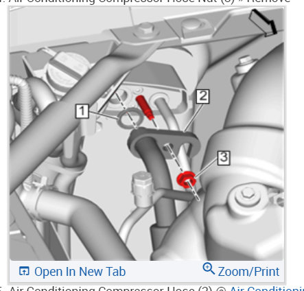

The port sizes are different, the large size is the high side while the smaller one is the low side. This guide can help you see what's going on and I have left instructions in the diagrams below:
https://www.2carpros.com/articles/air-conditioner-how-to-add-freon
and
https://youtu.be/uZrQCGwXfek
Does this truck take 1234yf refrigerant? 2018 was the slit year for 134a. The high side line is smaller that the low side line, In the images below the first will be the low side the next will be the high side line. Check out the diagrams (below). Let us know what happens and please upload pictures or videos of the problem.

Yes, sir, they should be different. but for some reason I have two large size ports.
Jun 6, 2022 at 12:30 PM
  • 55,691 POSTS
The small line will be the high side for sure, I would look for a tag near the A/C to see if the refrigerant is 1234 Yf. this truck can be either, but since the connectors are the same I'm thinking 1234 Yf. I don't think a 134r gauge set will work.

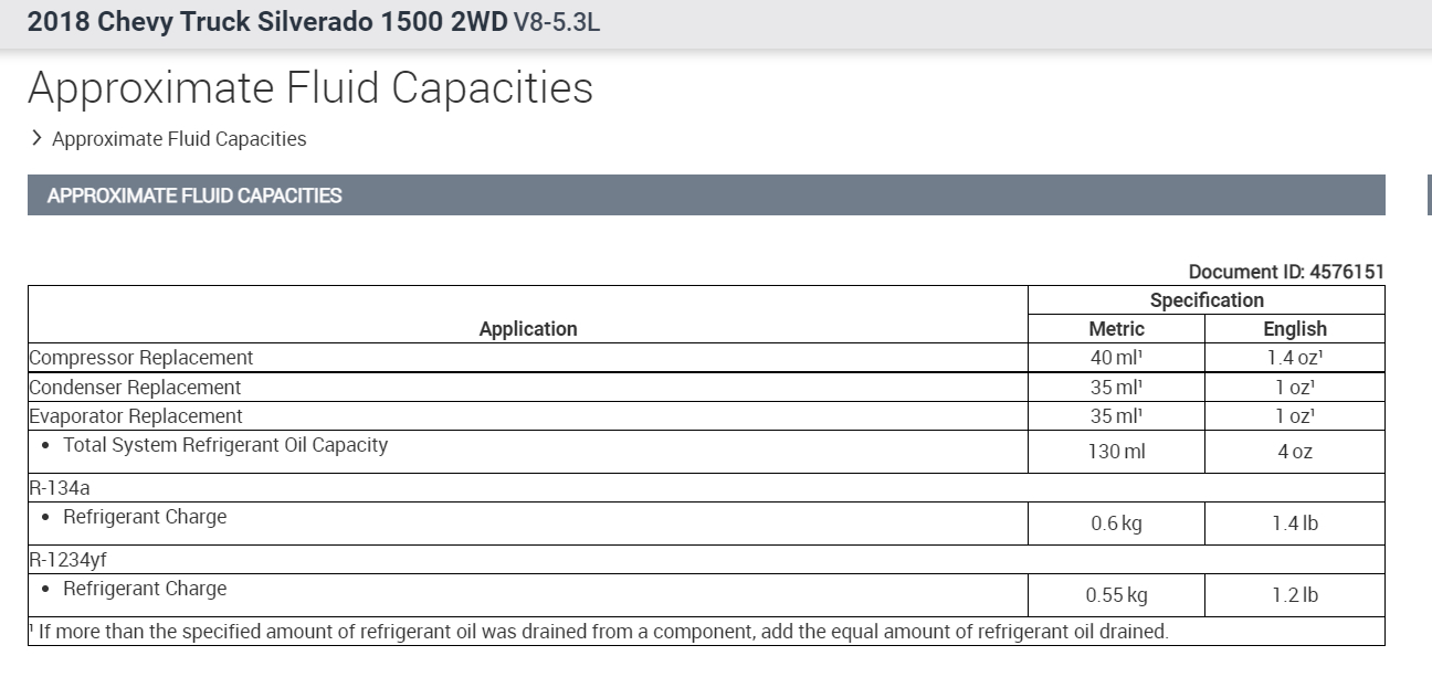

Yes, sir you were right on the 1234yf. R1234yf was created as a more environmentally friendly replacement to R134a. The biggest difference between the two is that R1234yf is mildly flammable and does require special handling. And it's a lot more expensive. Below is the link that'll break it down in more detail. Thanks a lot Ken.
