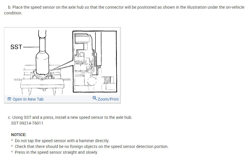

Wheel speed sensor replacement it went bad
2003 LEXUS LS 430
125,000 MILES
SREDA

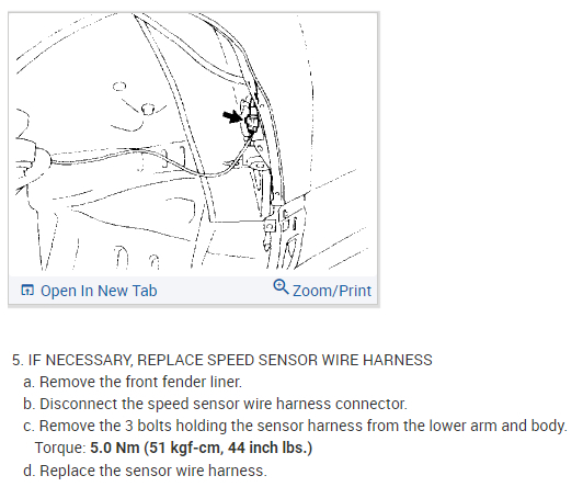

the ABs light is on it says I need a new right front wheel speed sensor.
May 6, 2013 at 3:52 PM
DANNY L
  • CAR REPAIR CONTRIBUTOR
  • 5,648 POSTS

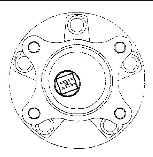

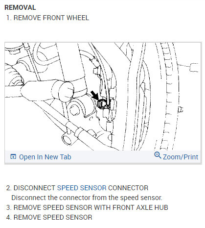

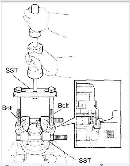

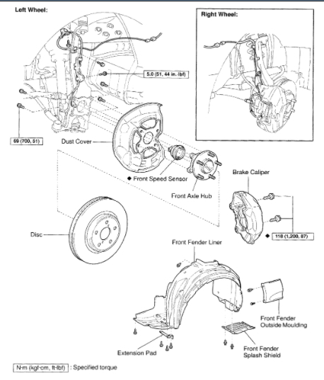

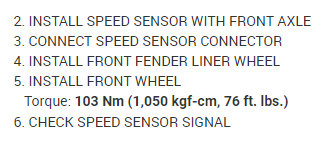

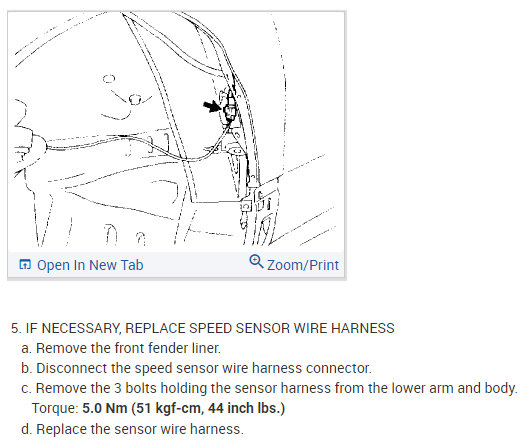

Hello, I'm Danny.

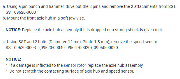

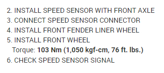

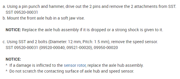

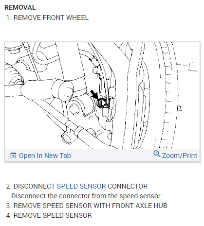

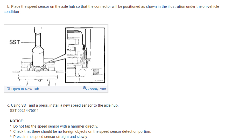

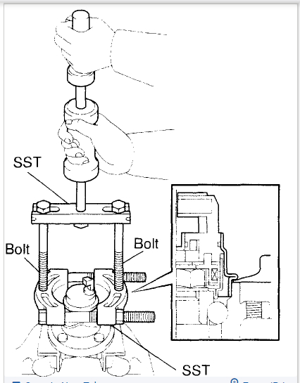

Here is the information you requested. Here is a guide to help you step by step with instructions in the diagrams below to show you how on your vehicle:
https://www.2carpros.com/articles/how-to-replace-an-abs-wheel-speed-sensor
I've attached picture steps below on how to change the wheel speed sensor on your vehicle. Hope this helps and thanks for using 2CarPros.
