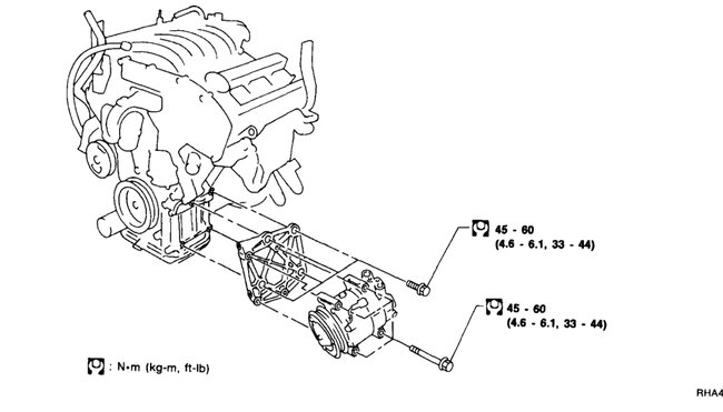

I have coolant leaking from behind the alternator and I think it's freeze plugs.
Nov 2, 2020 at 11:03 AM
Good afternoon,

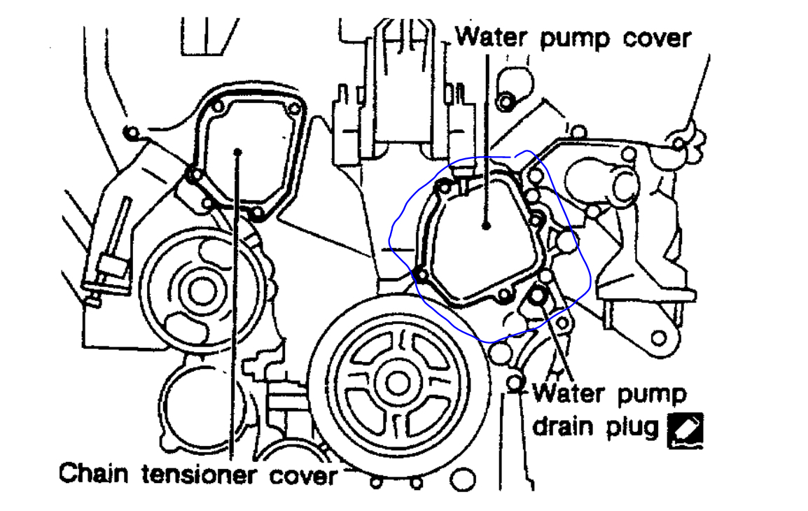

There is a freeze plug behind the bracket for the alternator but the bracket needs to be removed.
https://www.2carpros.com/articles/radiator-pressure-test
Then you need to pressure test the system to confirm as it could be either that or a head gasket. The water pump drain is also there in case the water pump is the leak. That is why you need to pressure test the system.
I attached 2 YouTube videos for you to view as well.
