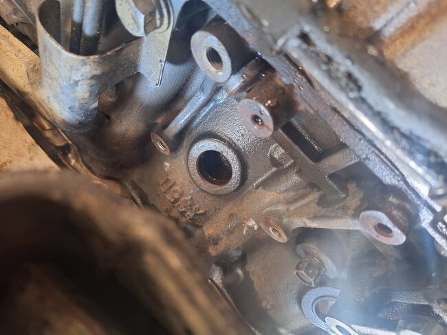

Have the vehicle listed above leaks coolant every time I pour it in. I located the leak, and it is on the driver's side, between the exhaust manifold and engine mount. I'm assuming it is supposed to have a Freeze plug in it but don't know the size. I've been to 4 different auto parts stores and a Kia dealership but can't seem to find the right size. Can anybody help?

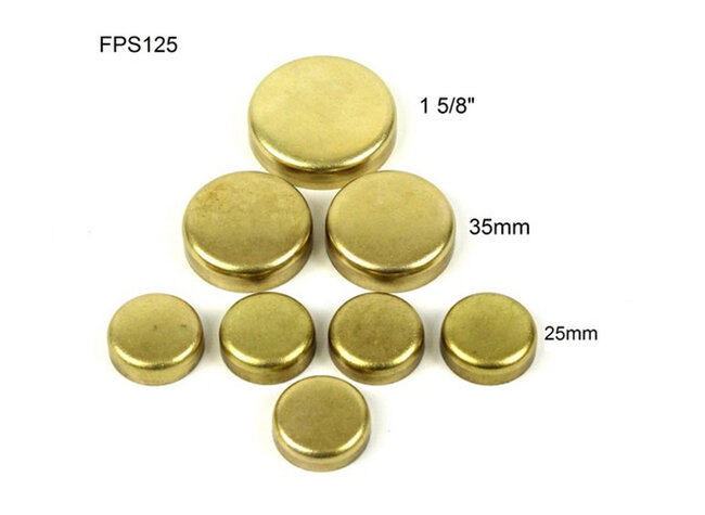

Hi Rob here, this is what you need.
Freeze Plug Kit FPS125.128, Freeze Plug Kit 3.5L ... Width: 1.00 (in); Height: 1.00 (in); Depth: 1.00 (in)

Were you able to see the photo I posted with the question for some reason it's not showing up for me. But I have one that is that size but no good. It's too small for the hole that I am talking about.

ALEMUR95
This:

These are the sizes you need the 1 and 5/8.
