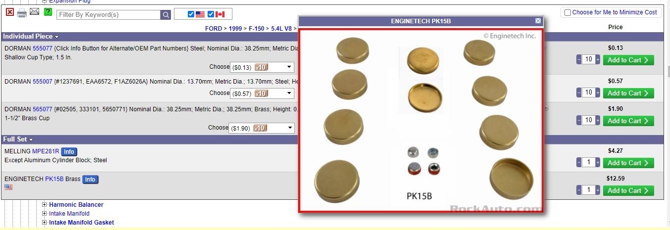

If not, then I attached below the entire freeze plug kit for the block from Rock Auto. For $12.00, you have them all. You will need to punch them inside the block and use a pair of pliers to remove them.

Okay, the core plug is part of that kit.
