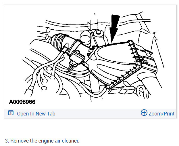

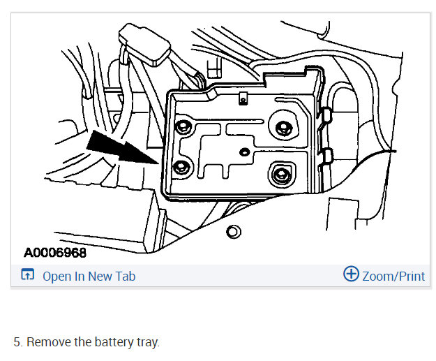

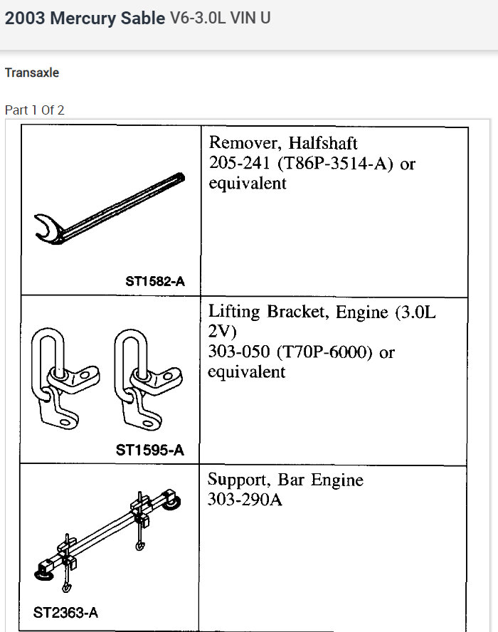

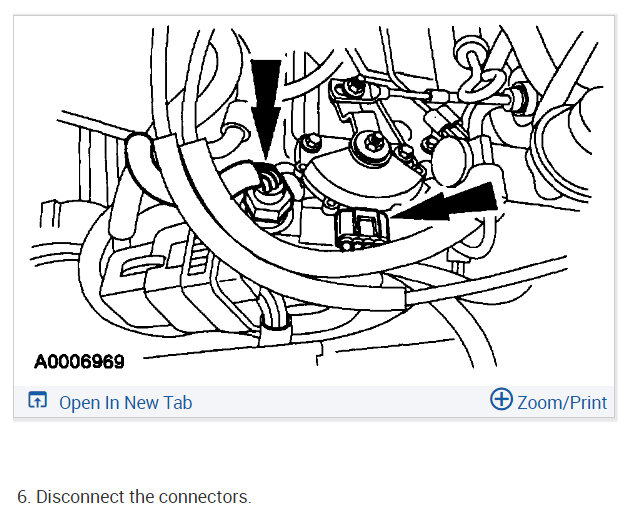

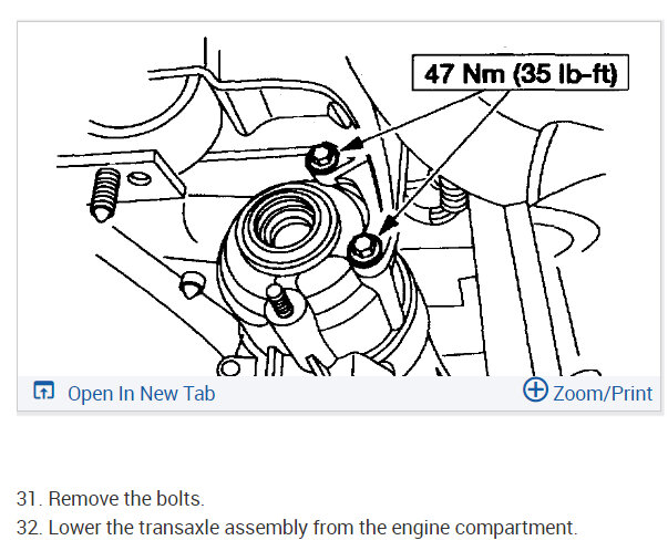

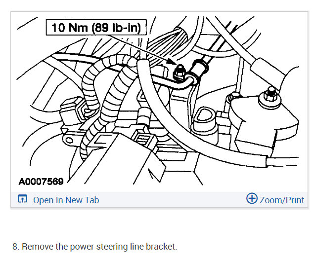

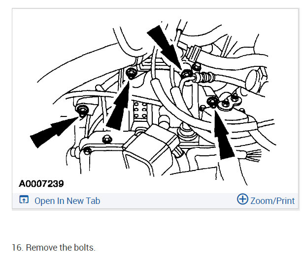

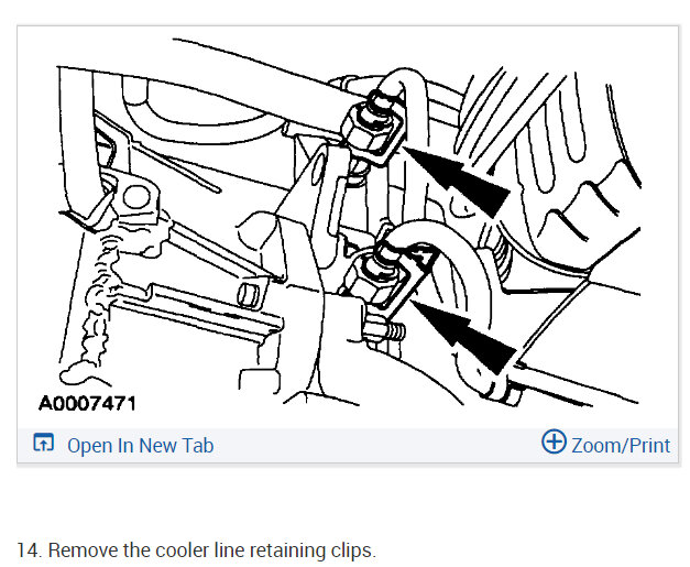

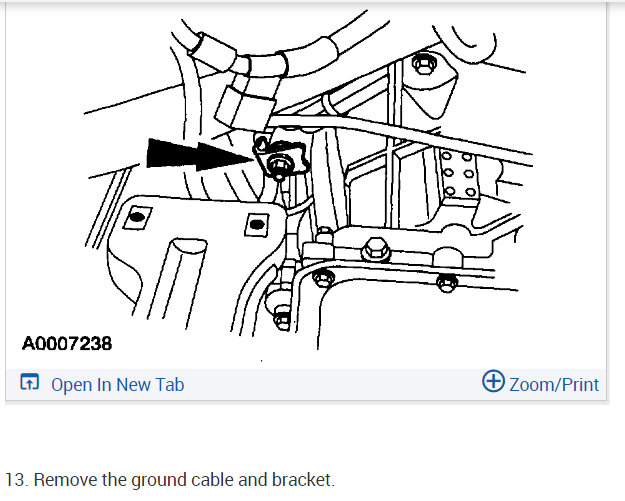

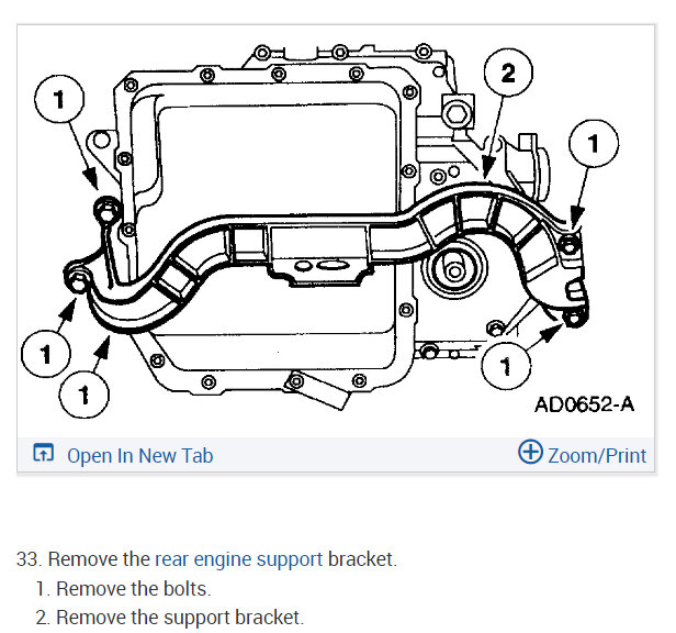

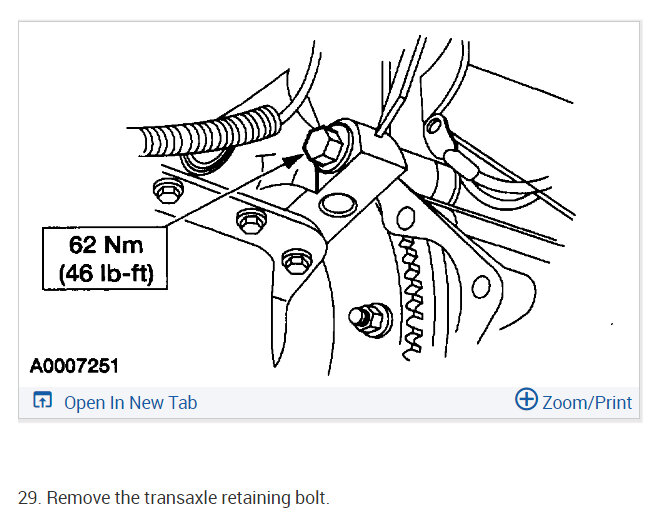

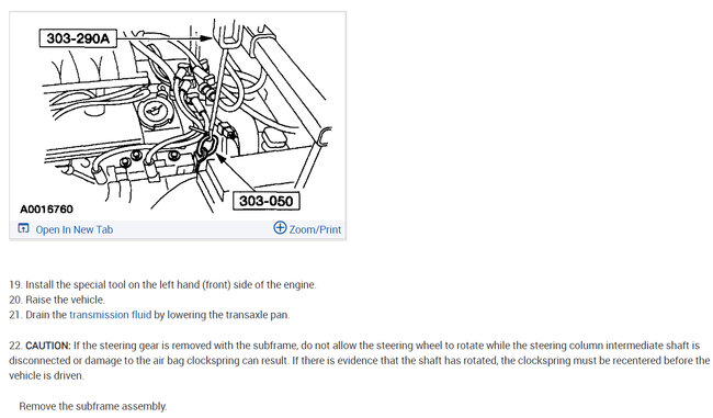

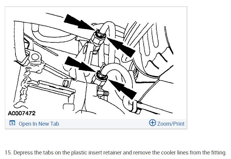

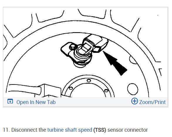

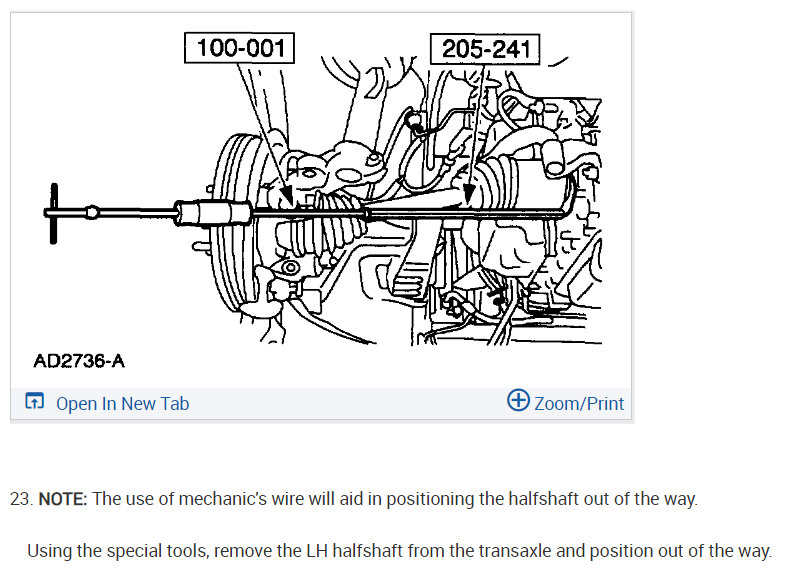

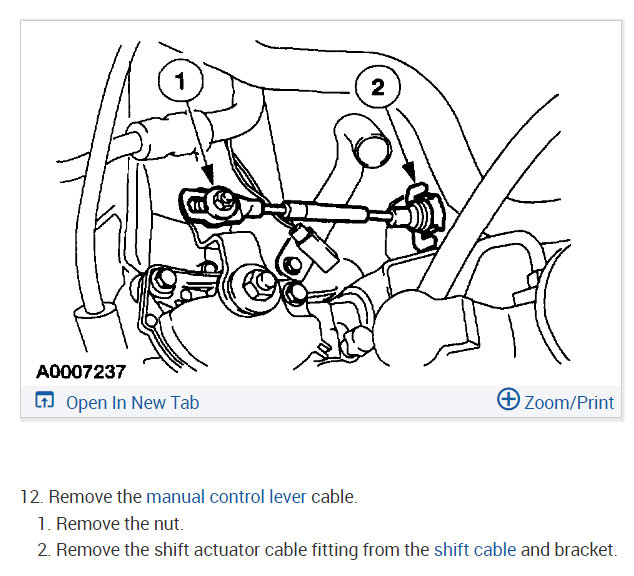

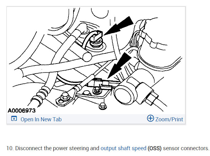

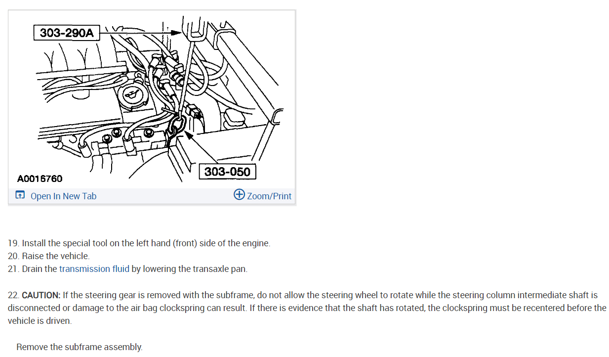

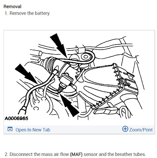

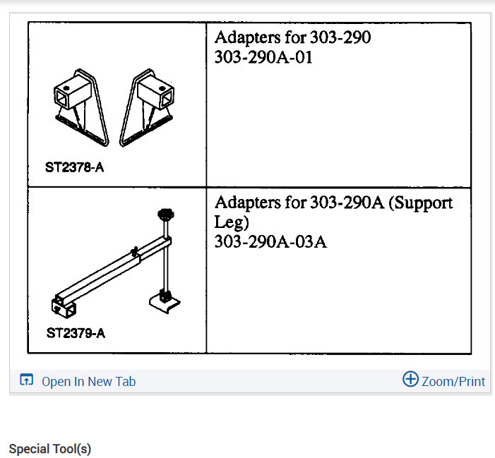

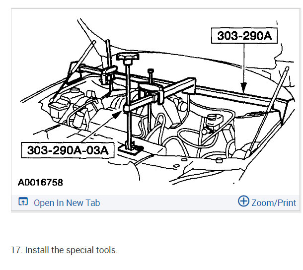

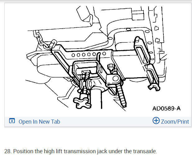

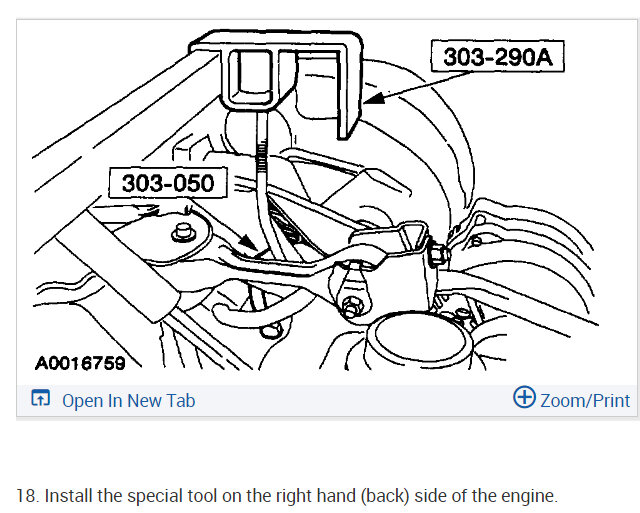

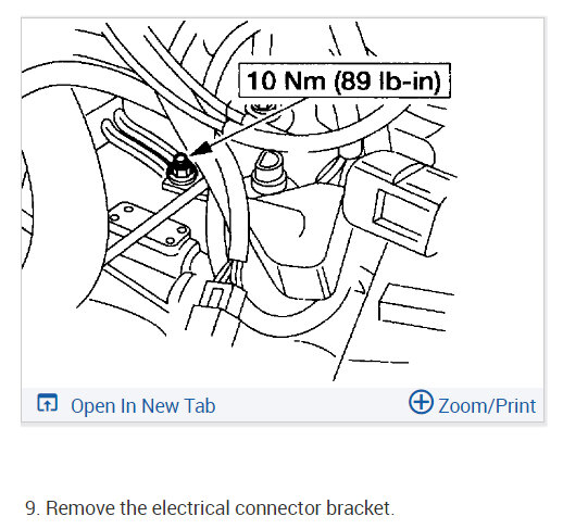

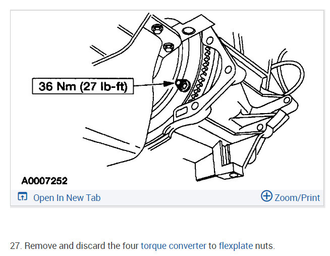

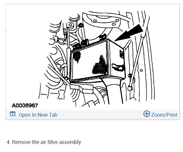

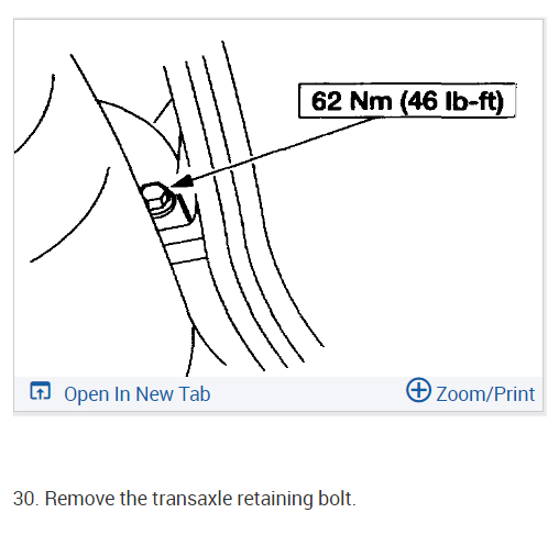

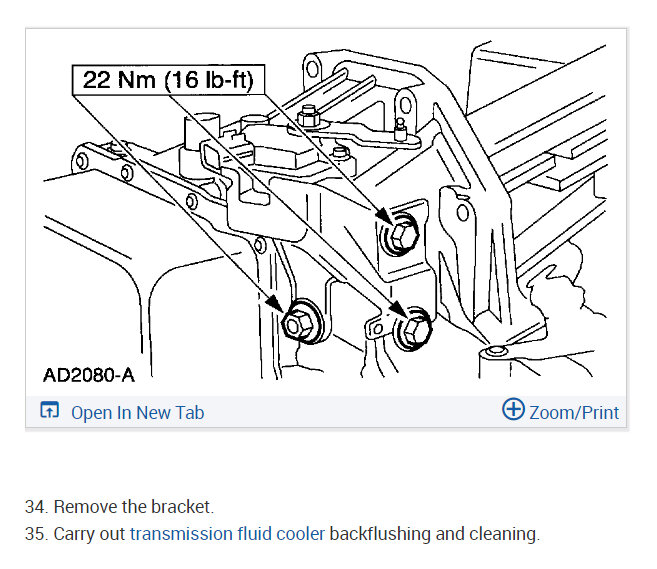

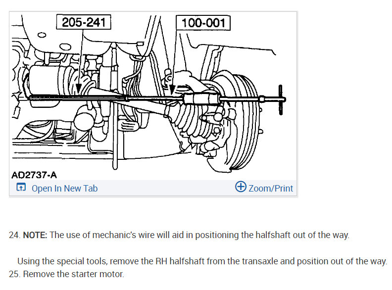

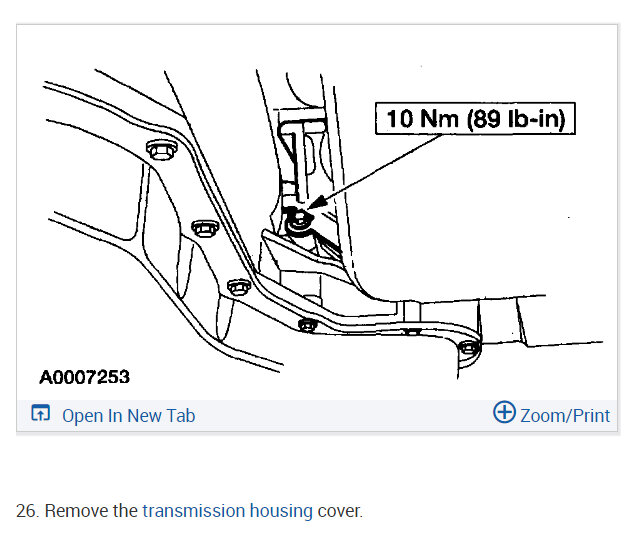

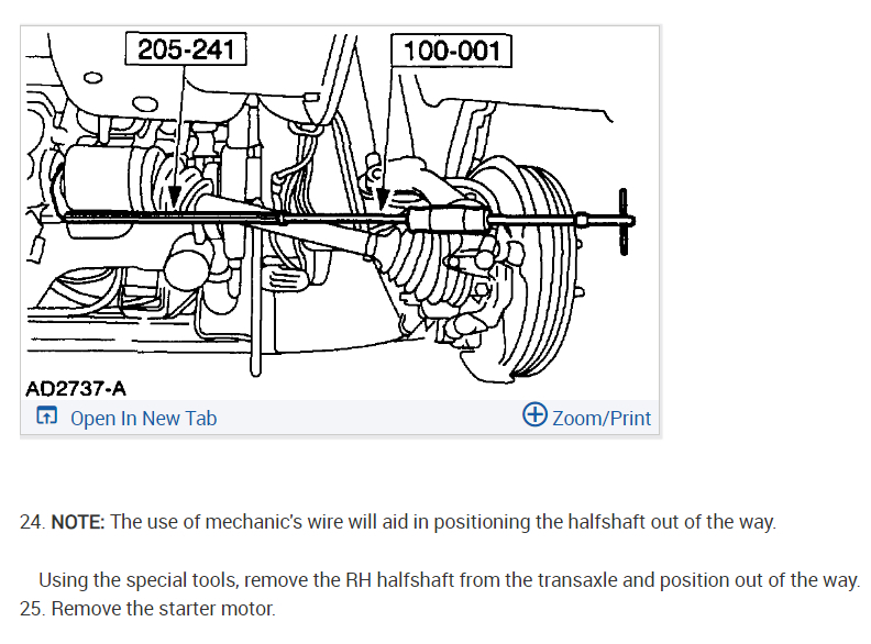

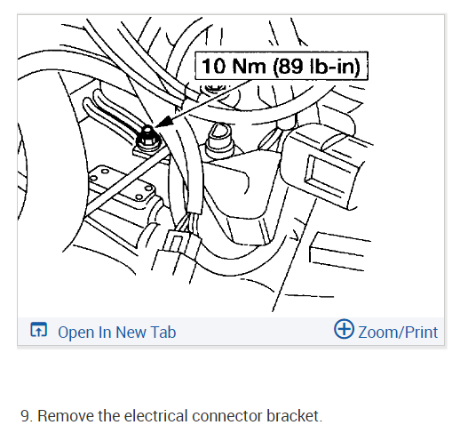

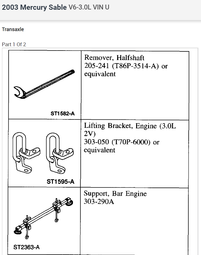

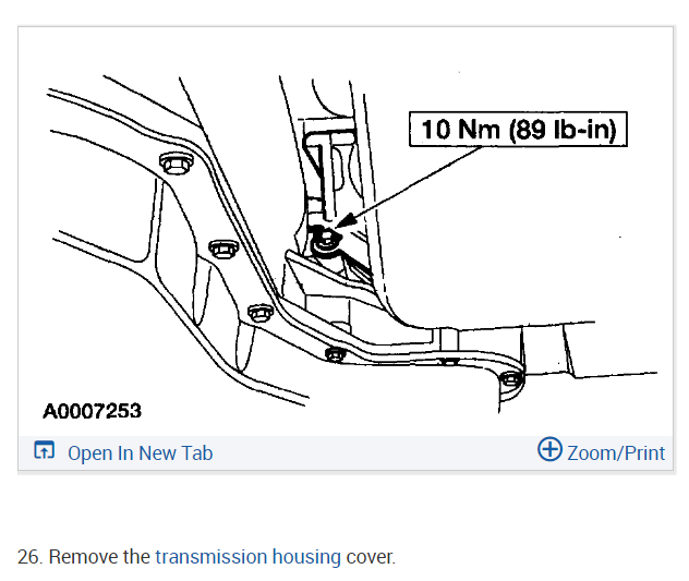

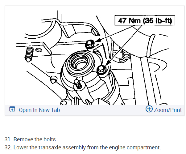

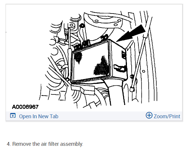

Need to know how to change the freeze plug on the rear of the block where it connects to the transmission without pulling the motor.
Mar 28, 2024 at 5:56 PM
  • 55,412 POSTS
Yep, that is a tough spot to get at, you will need to remove the transmission which is easier than removing the engine. Here is how the job is done so you can see how the fix the problem. Check out the images (below). Please upload pictures or videos in your response to the problem so we can see what's going on.
